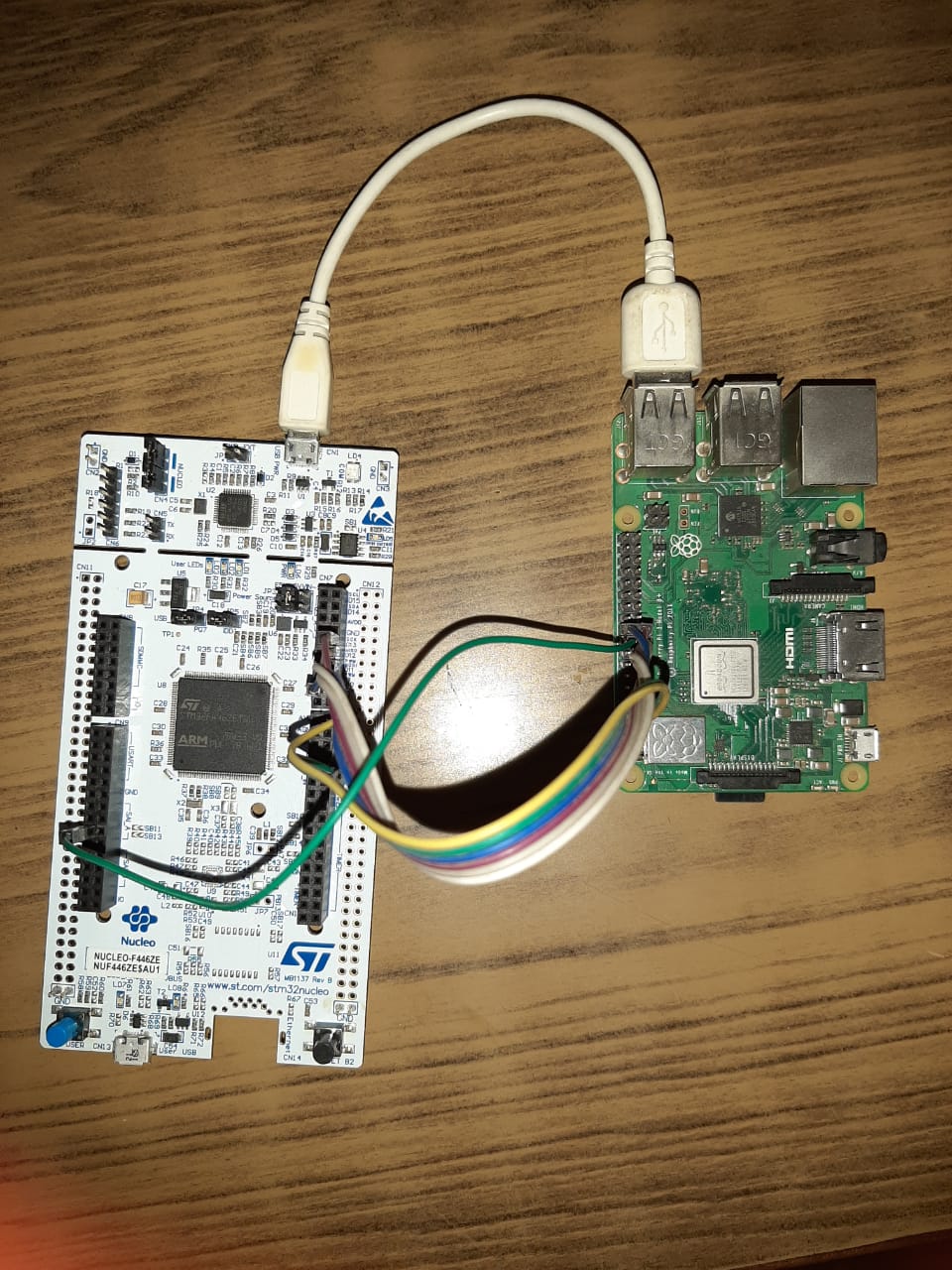

Greetings dev,
I have NucleoF446ZE board and tried to flash relevant firmware along with config.txt.
I have also connected SPI pins as suggested in docs.
Starting linuxcnc, axis screen lives but doesn't comes out of e-stop.
When I run in terminal I got error
Bad SPI payload =0
Bad SPI payload =0
Last edit: 12 Jul 2023 16:12 by virencq.

ok viren i hope you have a soldering iron. its nothing major. I cannot get it to work with pins PA4/5/6/7. It works with the Nucleo64 446RE, but not Nucleo144 446ZE. I havent not tested with steppers.
I updated the repo a bit, but you need to solder some headers and remove solder bridge 118. I have it working using SPI2

14 Jul 2023 13:37 - 14 Jul 2023 13:54 #275414
by virencq
Replied by virencq on topic Remora - Rpi Software Stepping Using External Microcontroller via SPI
I remove solder bridge 118.
Used your provided .bin file from the updated repo.
Connected SPI2
Nuc RPI
PB-15 19 MOSI
PB-13 23 SCK
PB-12 24 CS
PB-2 22 RESET
PC-2 20 MISO
Sadly mine still at E-stop. though in hal show remora spi pin reset toggles less than a sec,when I click F1.
Connected SPI2
Nuc RPI
PB-15 19 MOSI
PB-13 23 SCK
PB-12 24 CS
PB-2 22 RESET
PC-2 20 MISO
