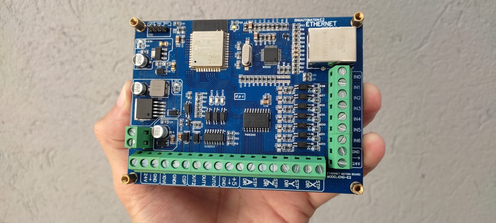

06 Jul 2023 01:25 #274872
by eng
Replied by eng on topic linuxcnc-esp32 Software Stepping over Ethernet Using ESP32
After almost two years of studies and dedication, we have the ENG-E2 working with Linux cnc with ethernet communication, we have no latency warnings or connection losses.
The following user(s) said Thank You: Bari, aparecido, besriworld, OpenDev

06 Jul 2023 08:52 #274884
by pippin88
That is great!
What step rates can you achieve?
Cost of the board?
Replied by pippin88 on topic linuxcnc-esp32 Software Stepping over Ethernet Using ESP32
That is great!
Cost of the board?

06 Jul 2023 23:51 #274918
by eng
I have two projects, with the esp32 using the rmt, I got frequencies of 150khz, without the rmt I kept 100khz, more than enough for the vast majority of people who use router machines, with the stm32 I have a project running at 100khz using the same idea as drive, but this one will be for the future, F407/F429, face about value, look, I didn't want to put this up for sale, but I really want it to work, I say this because I wanted to take that money and help people and animals that are on the street, So I apologize to everyone for having to make this decision, but it's for something bigger, and I hope it works.
