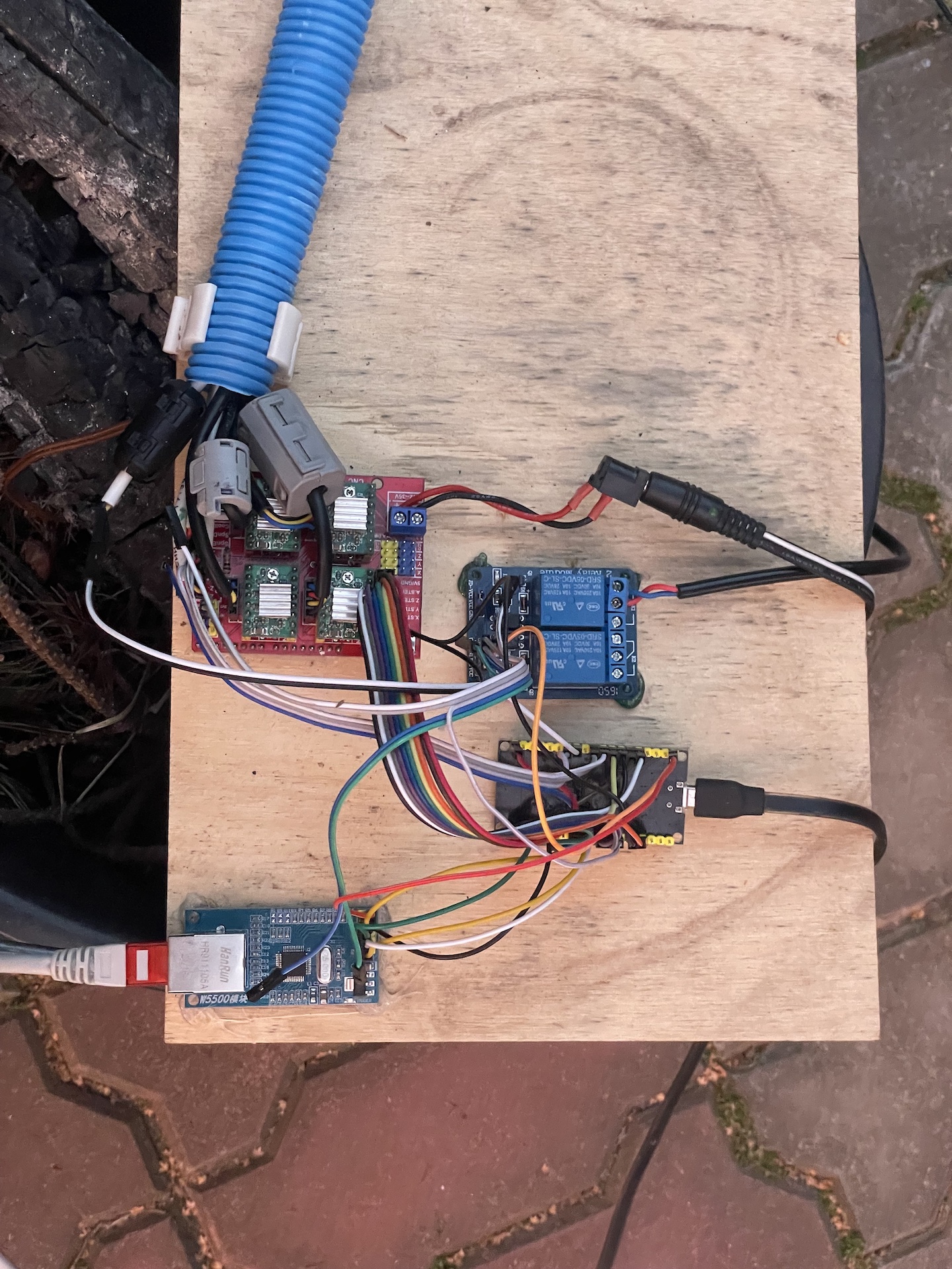

A quick update. I have used a using slightly modified jzolee's code to coomodate for 4th axis for around a month, it works okay, but reboots/hangs several times a day because of my plasma cutter's radio interference.
Overall it is a working solution.

Yeah, plasma makes a lot of electric noise.
Use the shortest cable possible, use a ground cable wound around signal cables, put the electronics inside a metal box that is properly grounded, move signal cables as far from the plasma source as possible, ground the PC, table and plasma source, etc.
If everything fails, put 330-470Ohm resistors on all inputs, even the ones not in use.
