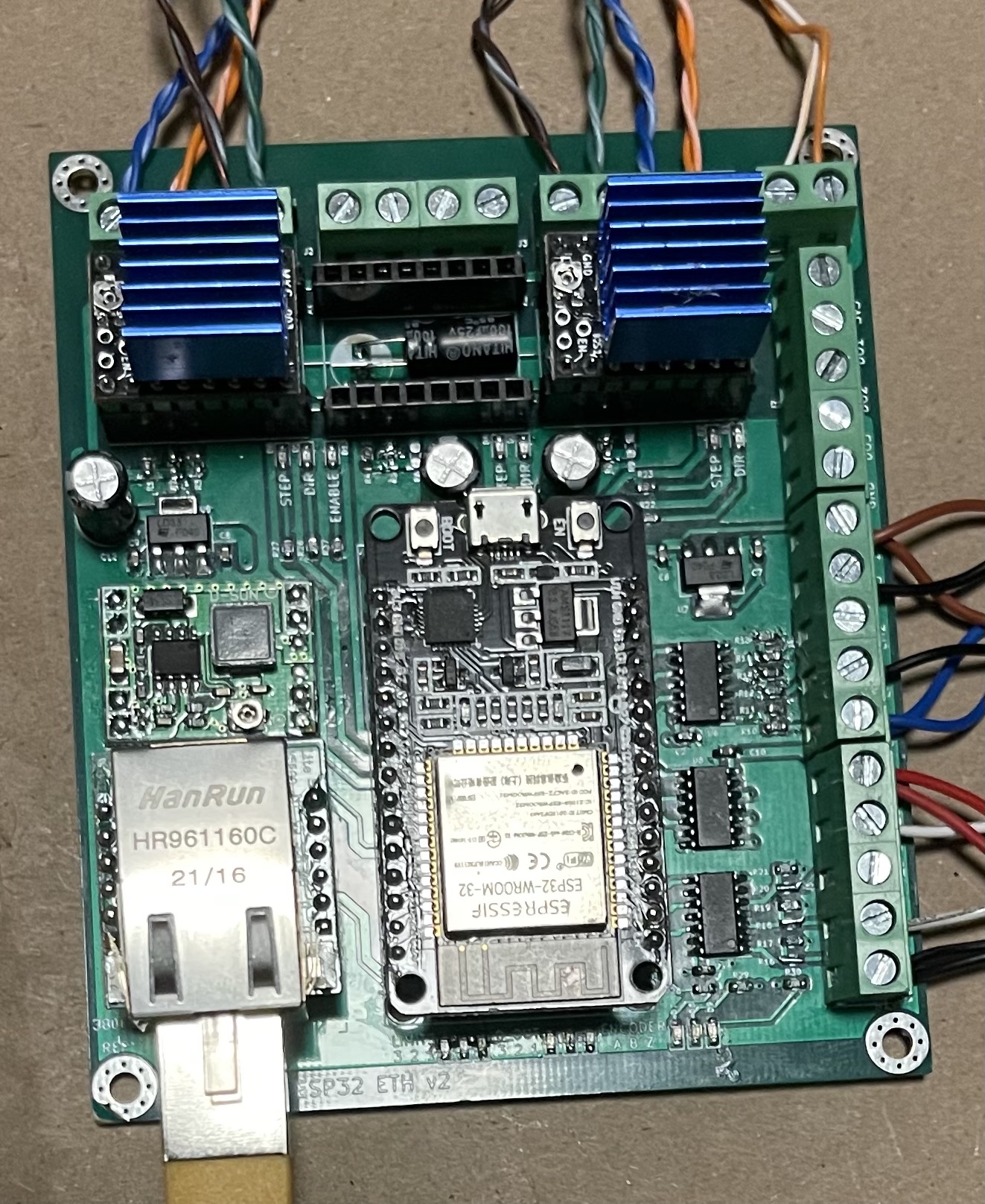

Would you possibly be able to add encoder functionality from github.com/dlhenke/linuxcnc-esp32 into the code? My Programming skills are nowhere near the level required to make this work. I know you posted that you have very limited development time, but this would be greatly appreciated.
I made a PCB for the ESP32
3 Axis, TMC2225 / Stepstick type things
3 encoder inputs A,B, Index
3 Limits switches ( Inductive Sensors)
3 Digital Outputs
The Board will need a V2 to fix some issues, but it works for me. I will gladly share the schematics / gerbers and I have some spare blank boards too should anyone want V1.
Doing the encoder using the UDP.IN pins limits the max Spindle speed. So the Encoder should give spindle position feedback.
I am trying to CNC a Mini lathe. ( I say trying... but in truth I have not gotten further than moving the axes and homing...)
Halscope sees the all the inputs though.
Another question... How would one invert a pin signal. I included an Enable signal, And was able to get the signal to come on when Axis is taken out of estop / Machine ON, but then realised I actually need to ENABLE to go LOW rather than HIGH.
Also similar issue will arise with encoder inputs, it might be needed to invert the signals
Long message for something that equates to begging for your coding time...
3 Digital Outputs
