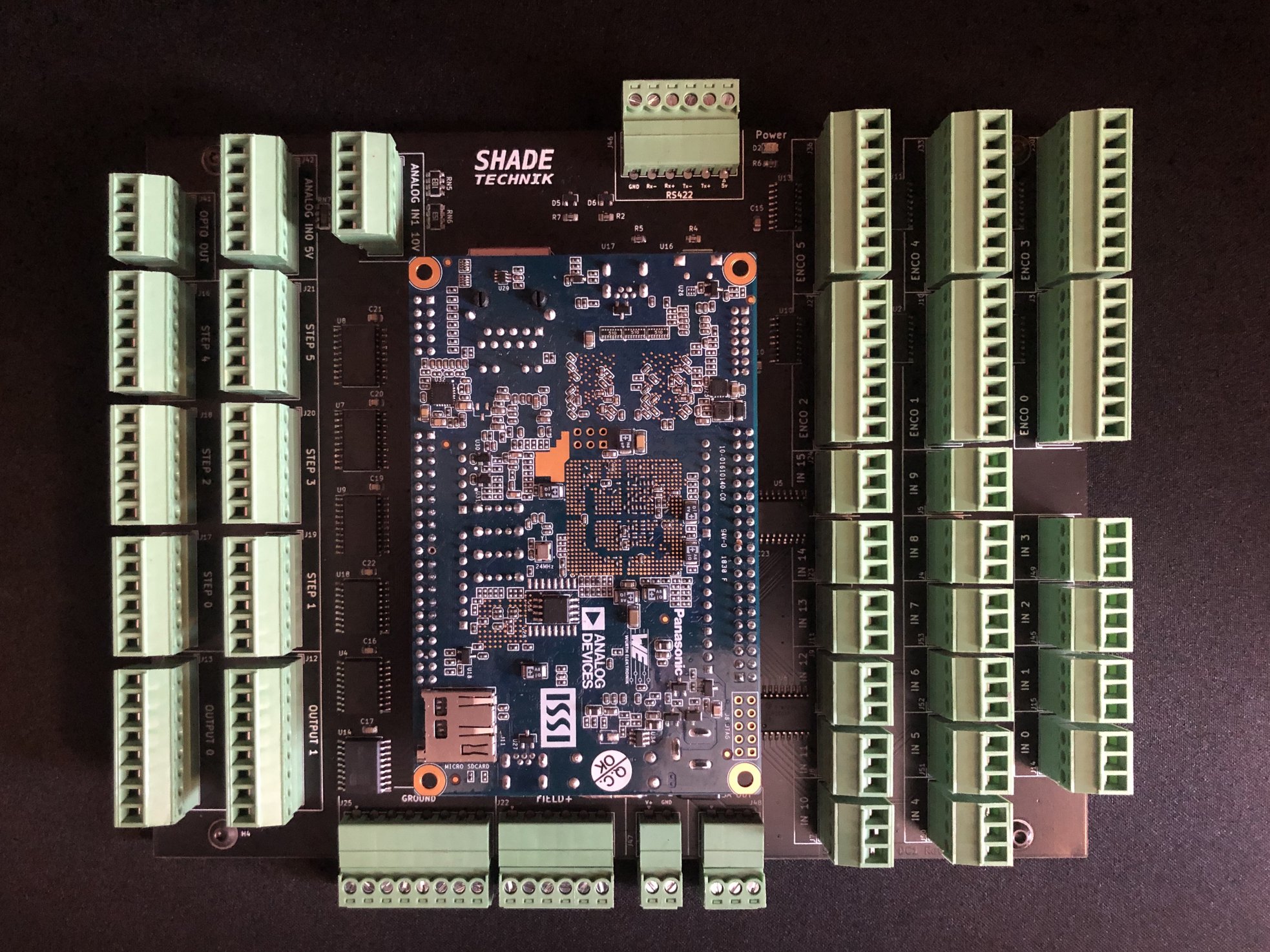

Any programming guys wanna fathom a guess what it would take to port this to a Teensy 4.x?
github.com/SebKuzminsky/linuxcnc-hal-teensy

Any idea/guesses which solution will emerge as a popular choice for linuxcnc when times goes on? Needless to say I'm very happy to see all this development going on, finally there will be plenty of optionality and we are not going to be overly reliant on proprietary hardware vendors like Mesa.
28 Feb 2022 01:13 #235971 by Bari
Replied by Bari on topic Teensy based CNC board
How do you define "proprietary hardware"?
Mesa posts all their VHDL source. They just don't post the schematics, BOM and PCB layout files for you to directly copy and sell.
Teensy doesn't post the VHDL or Verilog source to the microcontroller or BOM and PCB layout files.
