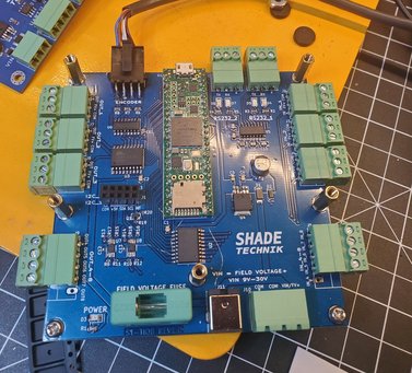

Not at all sure what you're saying here about voltages. 3.3v IS a logic voltage, 24v is a "field voltage" as Mesa would call it and it's a term I like to use. Even in a 3d printer, the stepper motors are not running at 3.3v. On a Mesa card, it takes or creates a 5v logic voltage that it regulates down to 3.3v and controls an up to 30v field voltage. I make this:
A Teensy has 3.3v IO and has a 5v VIN. That board will take 6-30v and power the Teensy @ 5v and all the IO is whatever 6-30, whatever is supplied.
"Screw connectors" are -like- Phoenix Contact MCV 3.5mm. I say like because they are not PC brand, even on a Mesa card. You can get Chinese ones for pennies but ya gotta buy enough to make shipping worth it. Mesa uses alot of off brand Chinese components on cards.....which is OK, because they'd cost a hell of alot more if they didn't. I believe being able to put them side by side is a feature of 3.5mm connectors. I usually use 3.71mm IIRC and they don't do this. I have tons of them.

I think your post here is fairly misguided. Not sure who drove the point into "low cost" or "cheap", I doubt that was the original posters point nor was it mine. You seem to have this idea that someone is looking to mass manufacture a competitor for a Mesa card or something. When has that ever been the point of any of these projects in LinuxCNC. People spend a whole lot of time doing crazy ass things around here for.....reasons.
Personally I make alot of obscure things that mostly see industrial use but stick to a certain form factor. If I need 4 decent encoder channels but only a few inputs or outputs, what does that Mesa solution look like? it consists of at least 2 Mesa cards neither of which is 1/2 used. I gotta stuff all that into a box.
If there was a Teensy firmware based on something like hm2 where modules can be loaded based on the IO on the carrier board it opens alot of possibilities up to someone with reasonable electronic design skills. It's not that Mesa stuff is "proprietary" it's that Mesa stuff is "off the shelf". for people building a mill or a lathe you really can't go wrong with Mesa stuff, but you can do alot more than that with LinuxCNC and like i said a Mesa setup could wind up being several cards just because none of which is perfectly suitable by itself.
The Teensy isn't a good candidate because it's "cheap". A Teensy 4.1 costs more than a Spartan 6 FPGA. The point it that it's accessible. Don't make the mistake of thinking a Teensy is just an overpriced Arduino either. The NXP chip on a Teensy has hardware encoder counters that when exposed are extremely capable.  The FPGA will always have a leg up by running parallel soft cores, but the CPU on a Teensy 4.x would probably stomp an awful lot of commercial MCU based motion control devices.
