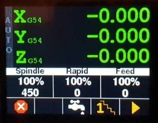

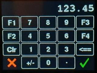

OK, OK, I'm getting there! One final (?) Arduino Library to handle the touch screen offset entry and so the displayed button labels displayed will now respond when touched. Available now on
github
and should be in the Arduino Library Manager VSN.
Which means we can now have this:
And this:
Oh yes, and we have icons!
It's getting there but it is proving challenging to keep it within the capability Arduino IDE (and me). May have to move to PlatformIO at some point - but not yet.
