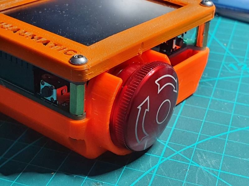

08 Feb 2022 21:27 #234355
by fletch
Replied by fletch on topic A Teensy -> Python Interface Manualmatic MPG/pendant

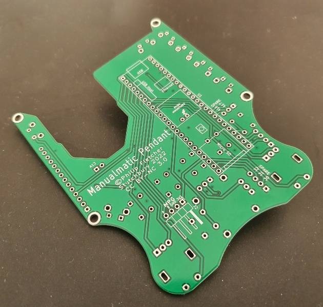

12 Mar 2022 08:13 #236981
by fletch
In the words of those awful gameshows my Grandparents used to watch: Here's wat you could've won!Couple of quick questions:
1. Is there any value in adding an (optional) joystick? I've seen lot of positive views on non-standard pendants but can't recall seeing one on a commercial pendant.
2. I'm looking at making a PCB - anyone interested if I make a few extras?

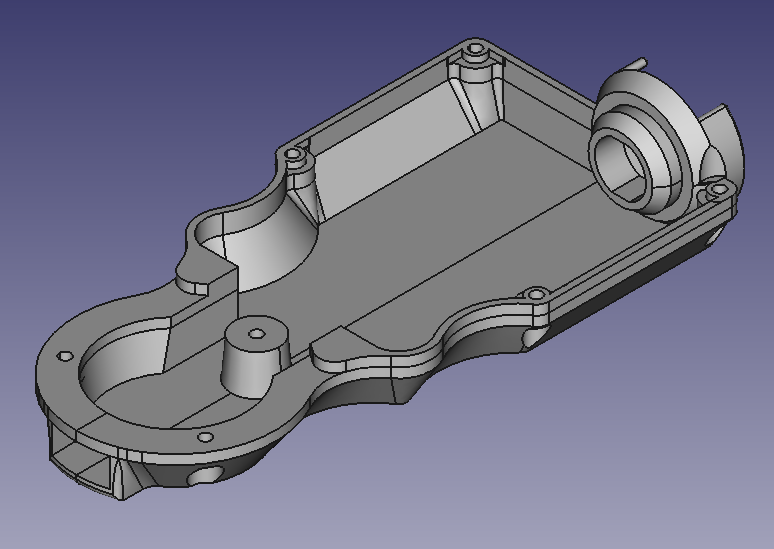

25 Mar 2022 13:29 #238337
by fletch
Thank you - I used Kicad for the PCB. I plan to upload the PlatformIO code soon (maybe this weekend) but currently fighting with FreeCAD - on the 5th itteration of the casing base... I added one missing constraint from the base sketch and that's three days work down the pan.
(the topological naming problem bites HARD).

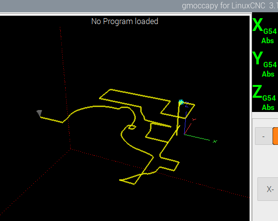

29 Mar 2022 16:30 #238628
by fletch

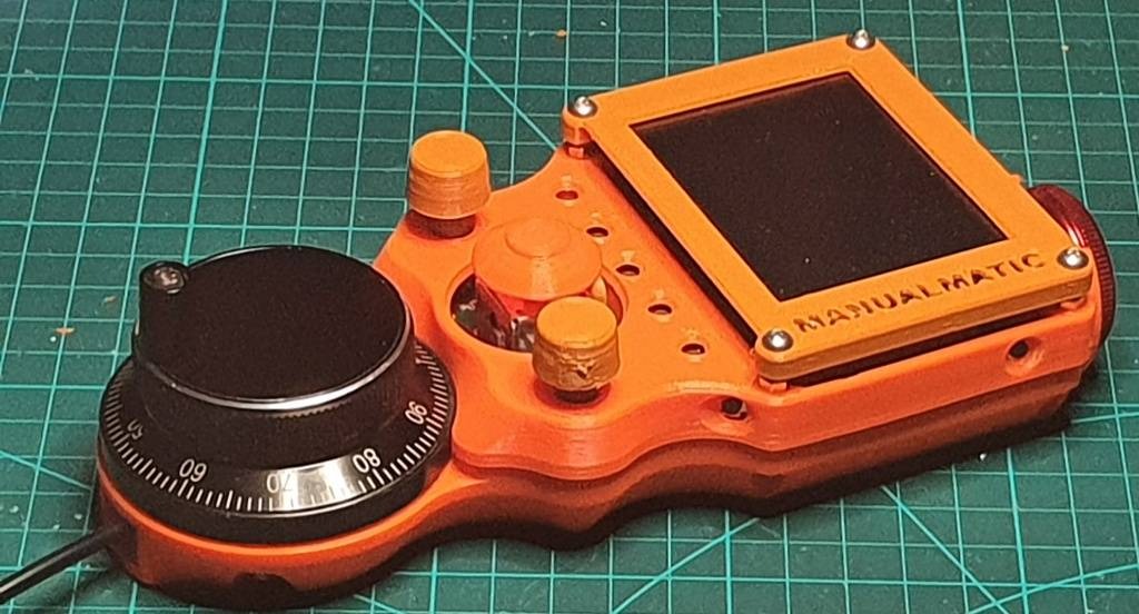

01 Apr 2022 19:29 - 01 Apr 2022 19:35 #239011
by fletch
