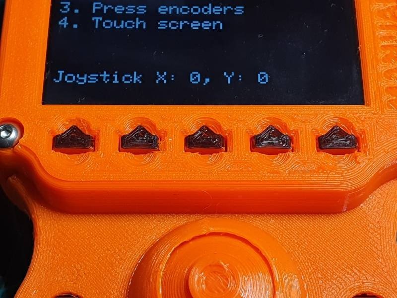

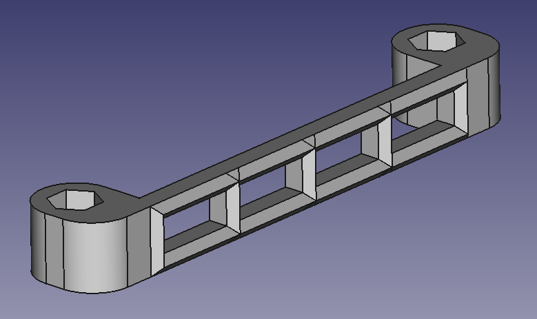

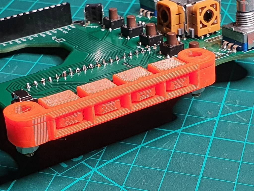

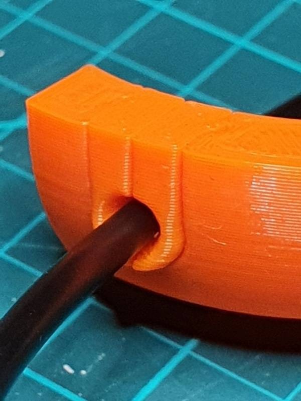

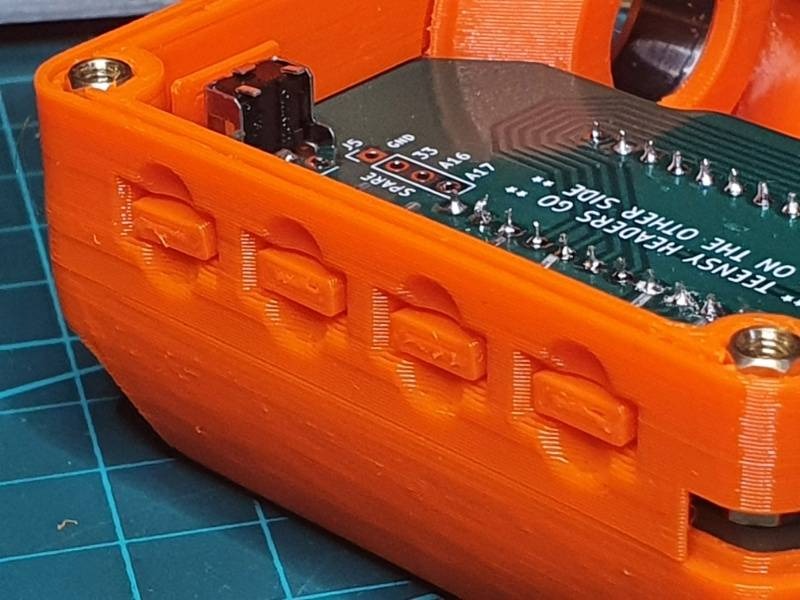

ooo the buttons!
A different design to my original - much easier to print and combined with the correct force momentary buttons provides a very satisfactory 'feel' and a low risk of unintentionally pressing them.
My apologies for the slight 'build log' of the case design - the PlatformIO code (its first draft from the Arduino code base) is done but I was waiting for the v1.1 PCBs to arrive to test (and now waiting for the correct encoders as I accidentally ordered 'high detent force' ones from Mouser...)

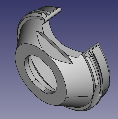

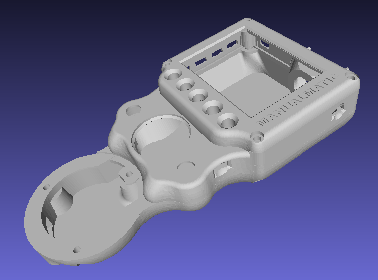

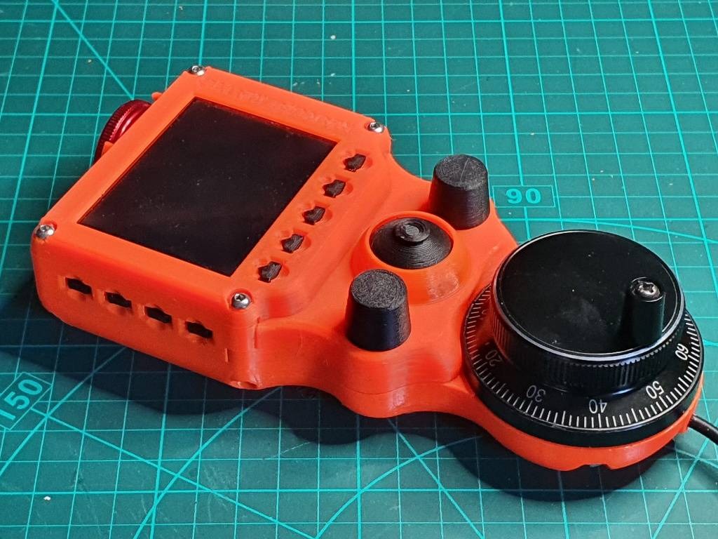

Saturday night code release again - oh what a life we lead!
I've migrated the pendant codebase from the Arduino IDE to PlatformIO. This should allow refinement of the structure to add flexibility/ease maintainability of the codebase. All the major functionality is now in place but would appreciate feedback on both code and function. There's also a small wiring check test 'sketch'.
Code is here: github.com/Stutchbury/Manualmatic-Pendan...e/PlatformIO/pendant
As you may have noticed, I have spent a 'little' time creating a 3D printable case with FreeCAD. I've included a little guide for printing but it came out OK on my fairly well abused Ender 3:
STLs are here: github.com/Stutchbury/Manualmatic-Pendan...n/Hardware/case/v1.1
I have a few spare PCBs and components (minimum order at Mouser is a pain) so would be happy to make up some 'PCB + board components' kits if anyone is interested. I'm still waiting on a second order of encoders (I ordered the 'wrong' ones first time) but highly recommend avoiding the ebay specials - I've had a few that do not work reliably. Once I've tested the new ones, I'll finish up the Bill of Materials.
Enjoy!
Enjoy!
