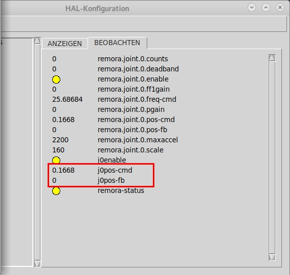

Installed everything according to the video tutorial (Remora NVEM Getting Started).
Unfortunately, as with "Capper" is an
error message no feedback.
Controller board is NVEM V2
I would be grateful for any help
Replied by widder on topic Remora - ethernet NVEM / EC300 / EC500 cnc board
Hello, I've been following the project for a long time and I think it's very good.yes, i am using the NVEM-basic-configuration from youre github. As you mentioned, my plan was to take this as an example for further adjustments.
That error occures every time the software tryes to move the Motors (not only while jogging). After that error i have to reinitiate the machine.
By turning down the feedspeed to ~0.9mm/min, i could observe that the pos_cmd seems to count up until it reaches the FERROR-value from the config.
My setup constist out of the NVEM with one Stepperdriver (DM422 without feedback) attached to the x-axis. Endstops and other stuff are detached.
Instead of an raspberry i am running an Desktop-PC with the Linuxcnc-Debian10 (Buster) version you can find here in the forum.
could it be possible, that the communication between NVEM and linuxcnc has any problems? I had to set the static IP via "/etc/network/interfaces" instead of the "etc/dhcpcd.conf", like you've done in the video.
if there are any logs needed, just let me know.

Also, i have to withdraw my statement, where I've said the inputs can be observed. Checked it and it's not the case.
So, after uploading the Basic-configuration.txt (successfully), with x,y,z Motors and and several Inputpins (Input 3 & 4)
i am not able to get any feedback at all.

Does this occur when you do a full chip erase and reflash the board and NOT uploading a config? The build in config should work.

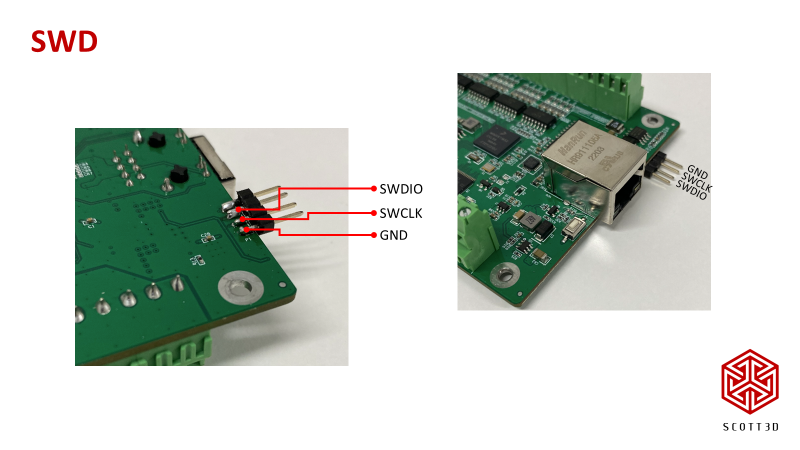

I had a play with the EC300 yesterday. The push button definitely does something with the boot mode. Good news is I got my ST-Link flashed with custom DAPlink code to connect with openOCD to the board. The DAPlink is recognised by the NXP-MCUBootUtility but it fails to connect. I do have an issue with the code in the DAPlink though as it's throwing an ASSERT error for drag-and-drop. This was a really quick test to see if I could get it to compile ok, but I was using Hyperflash code which may be the cause of the error. Step-by-step...In some cases SPI flash can be not readable/writable when it soldered to the PCB. In this cases we must to solder it out. But I have a feeling that SPI flash is encrypted and the bootloader stores the keys for the decryption. Bootloader must be not readable (due to copyright purposes). So going by the SPI flash way can be a bad idea.
By the way, we have a button on the PCB. I guess it makes something with a boot sequence. When the ST-Link is connected and the button is pressed on boot, additional LED is lighting. In other cases this LED is off (see the photos).
A magic "IC" chip is also here (see the photos).

by scotta
epineh was kind enough to send me down his NVEM and donated a couple of ST-Links to get me up and going again. A big thanks!
I've got the NVEM connected via DAPlink as well.
openOCD config for the board is

Hello scotta, thanks for the quick message.
The chip was completely erased.
Only the firmware was uploaded (the configuration file was not overwritten).
Remora-eth connection is good.
The test returns the error (motion error).
I don't get any feedback from NVEM controller board.
