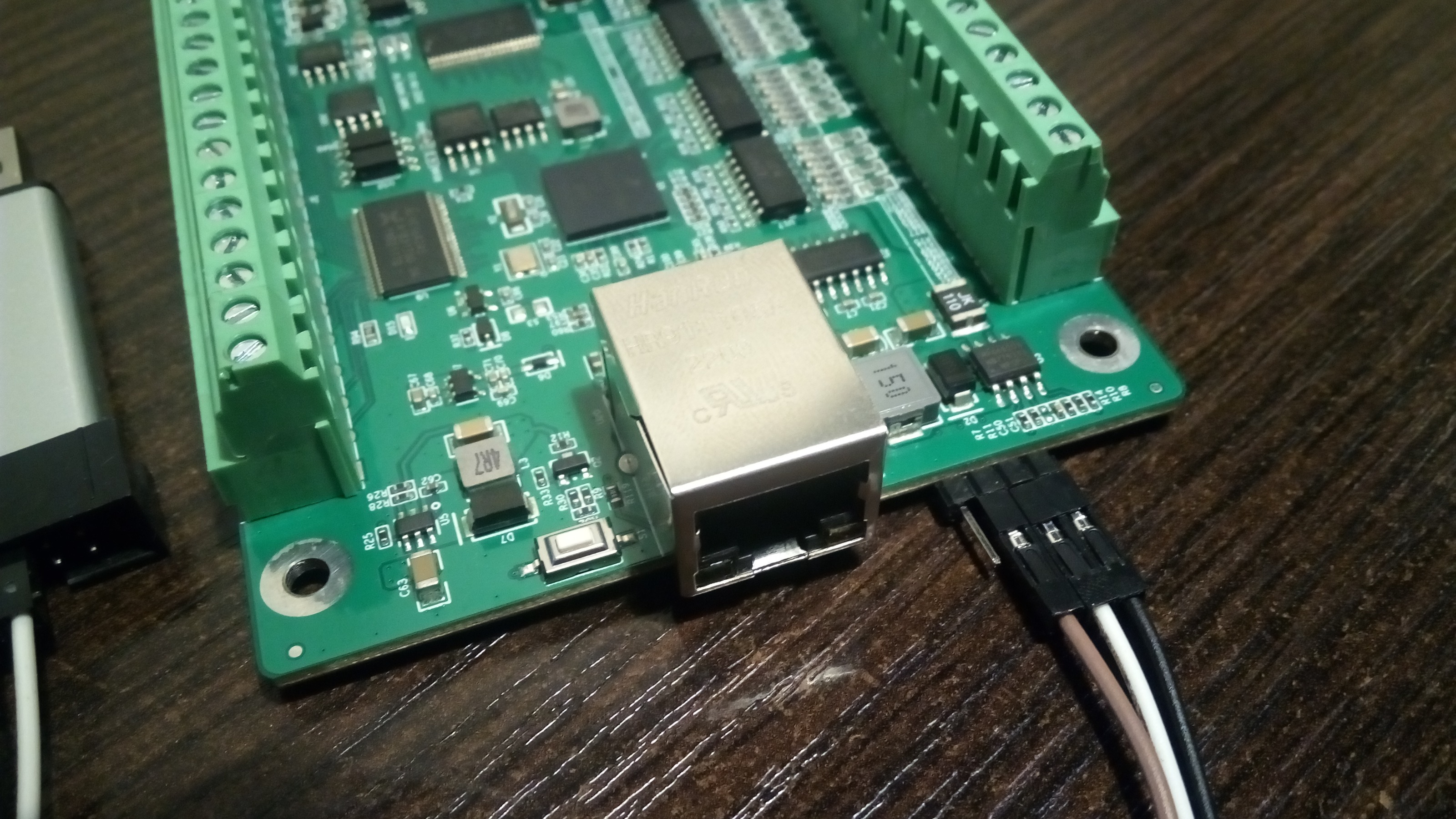

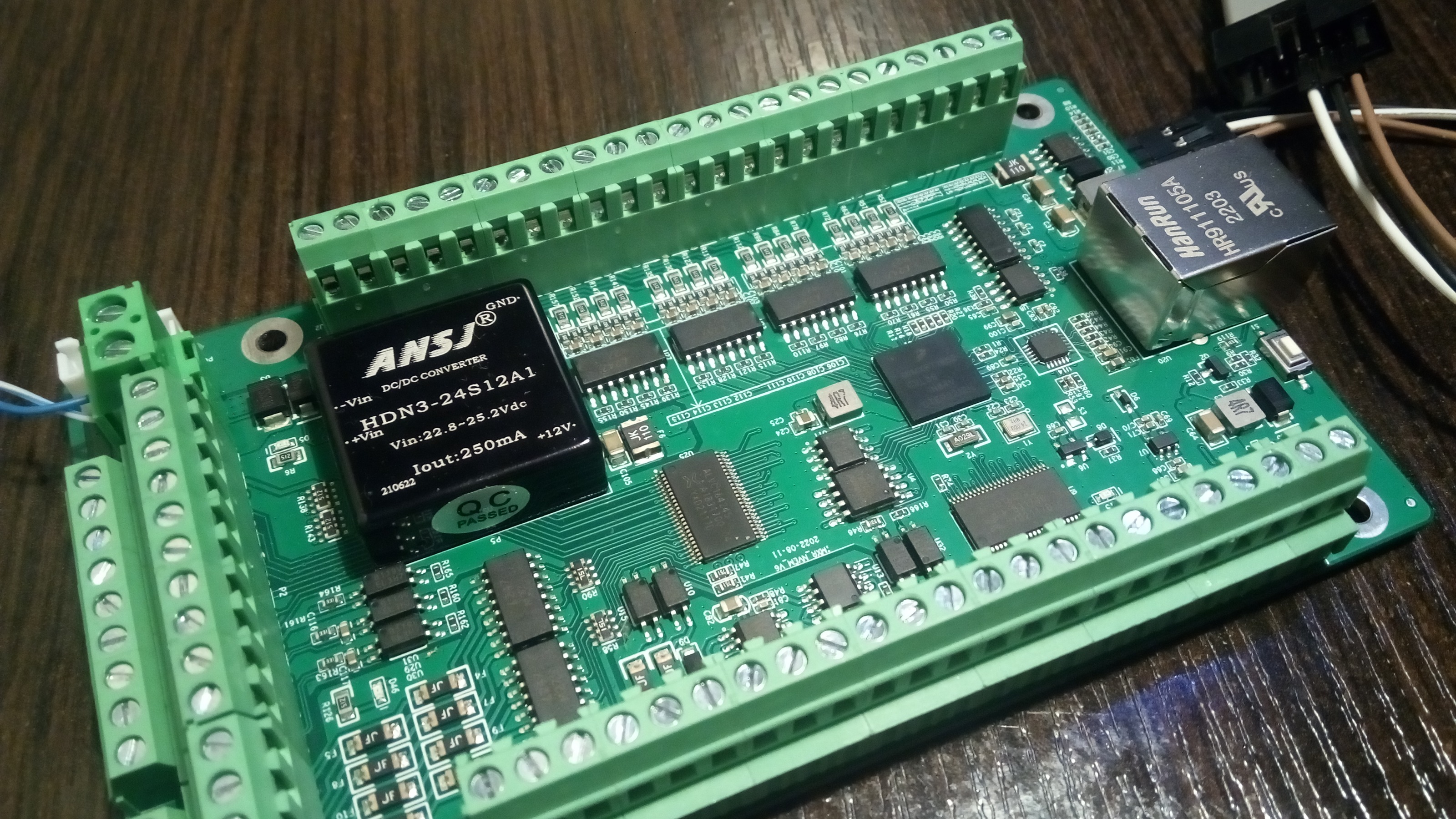

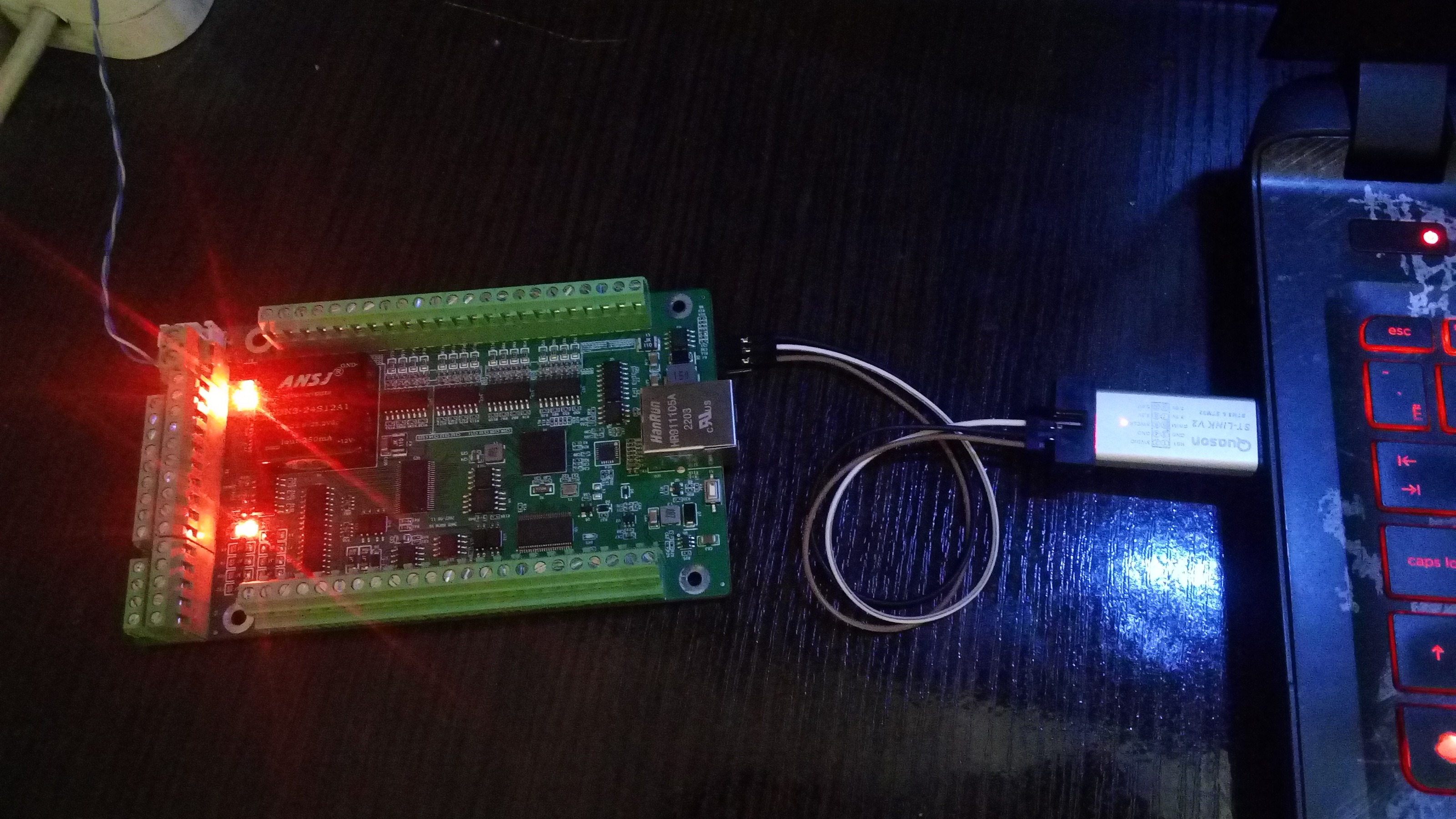

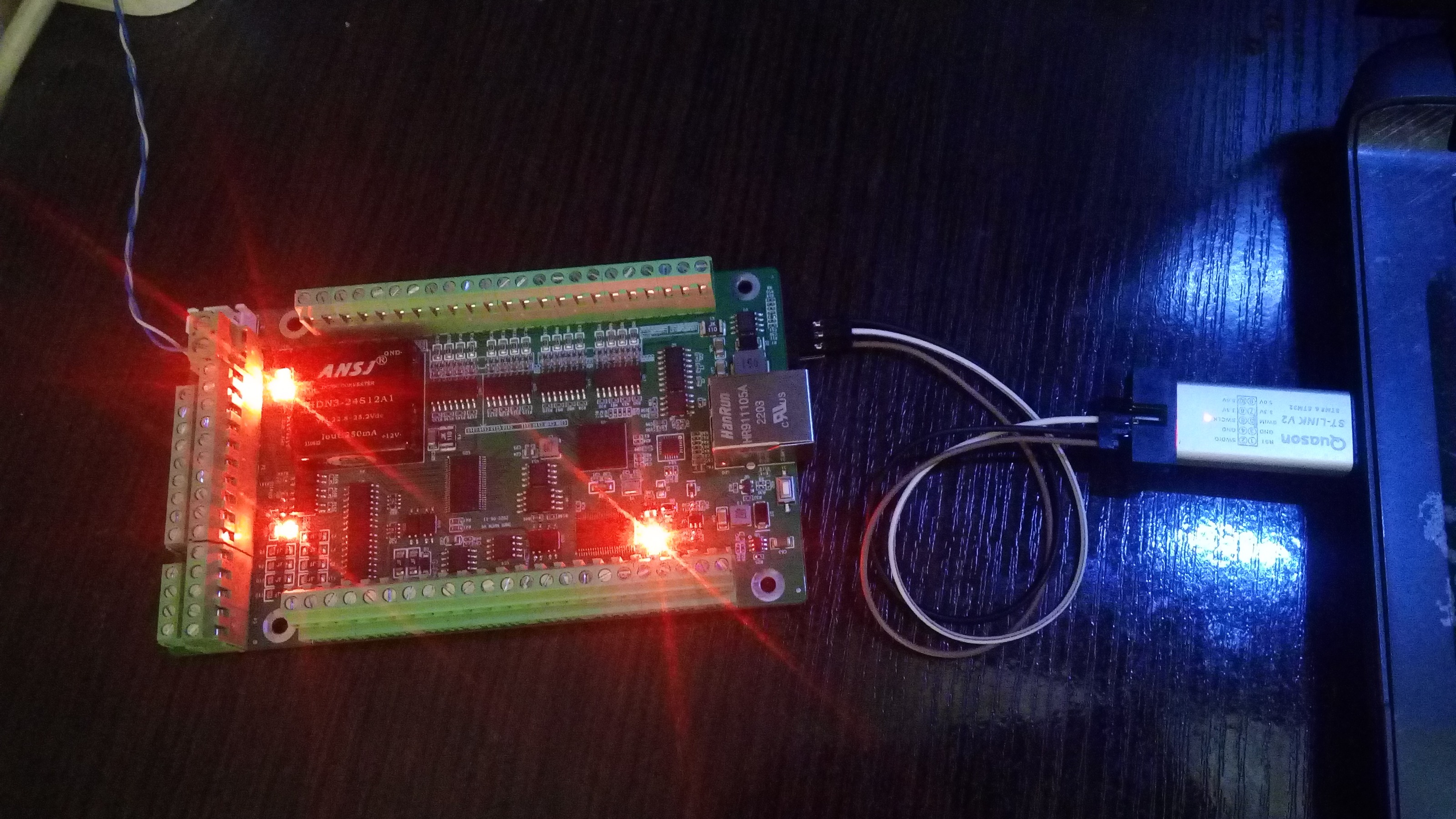

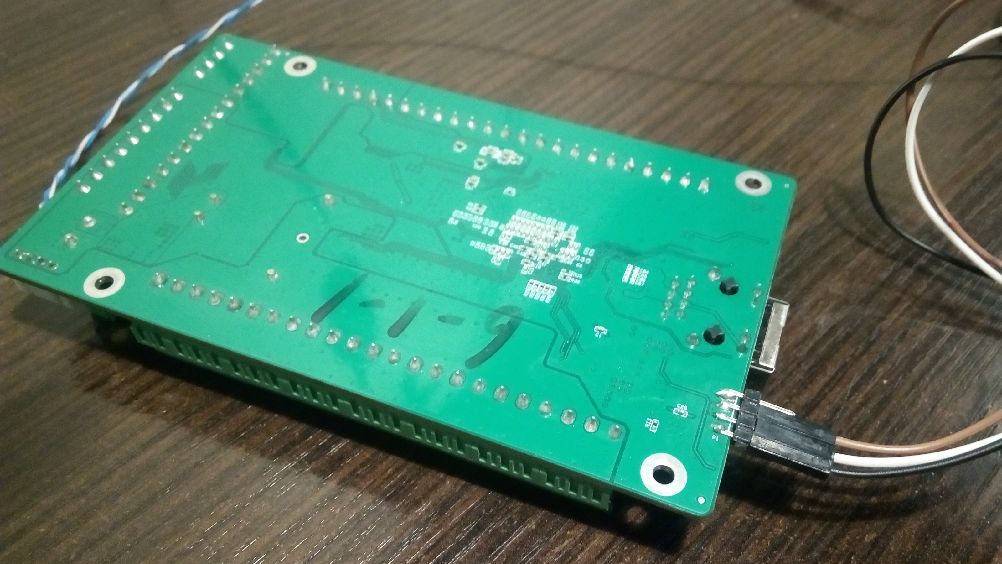

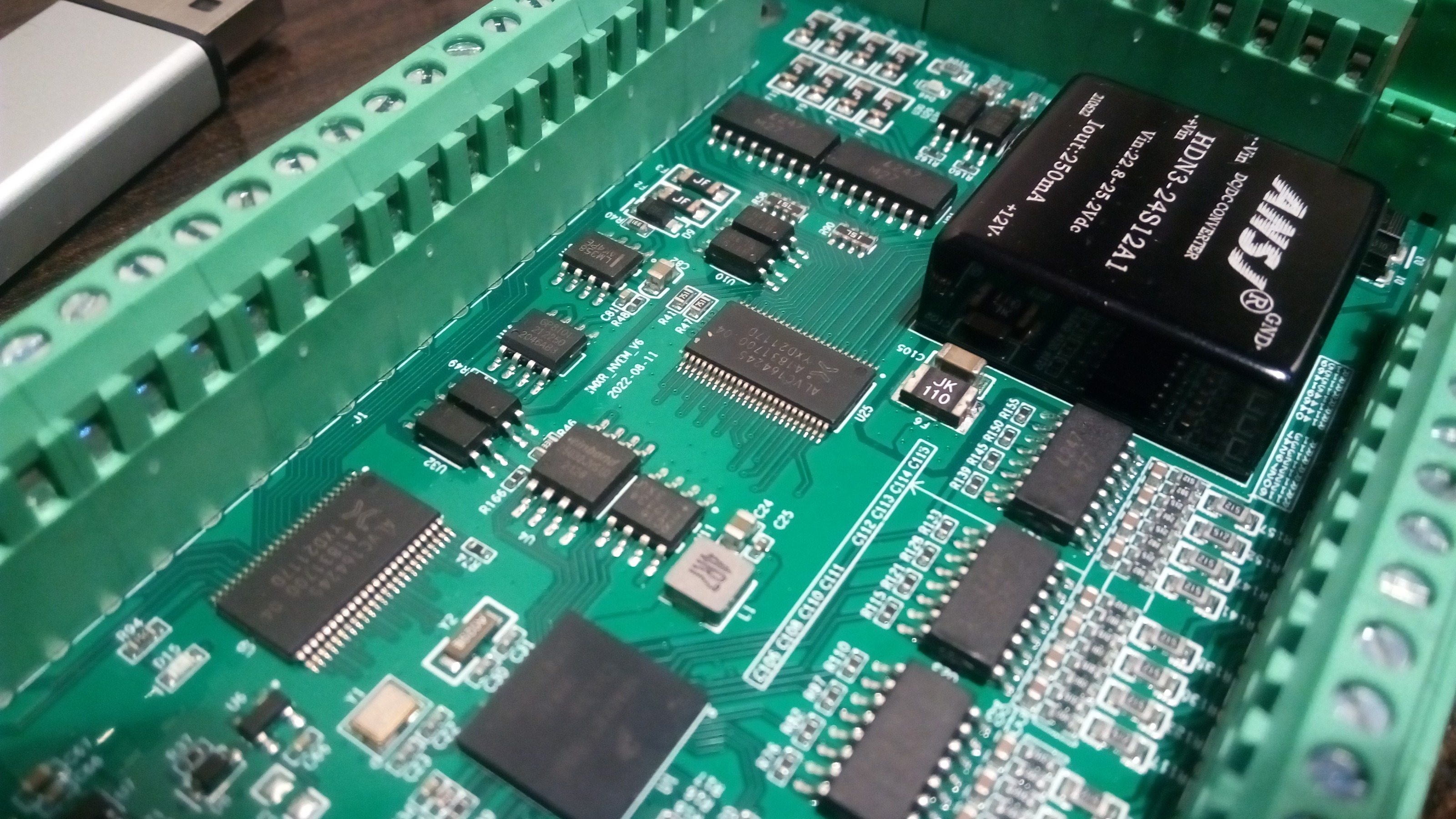

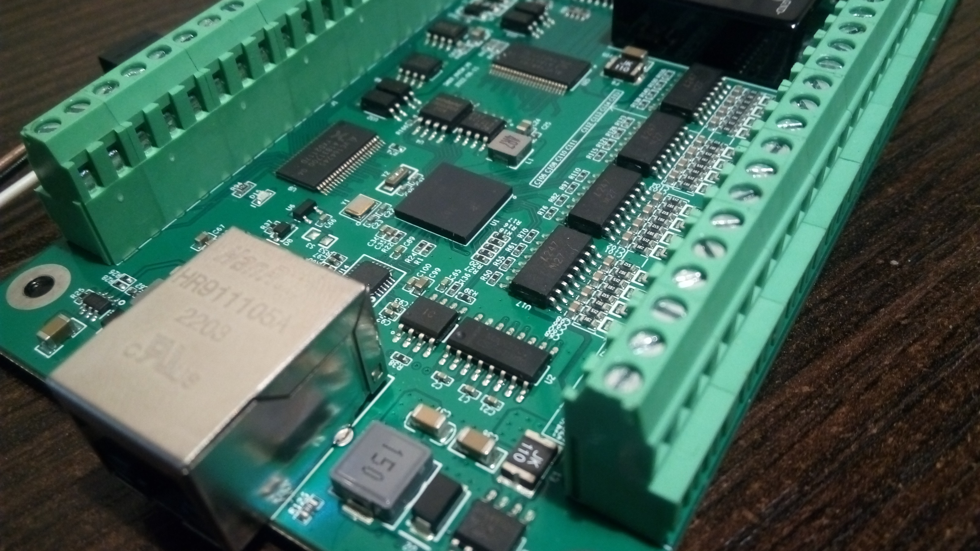

01 Oct 2022 04:38 - 01 Oct 2022 15:28 #253143
by MX_Master
Replied by MX_Master on topic Remora - ethernet NVEM / EC300 / EC500 cnc board
In some cases SPI flash can be not readable/writable when it soldered to the PCB. In this cases we must to solder it out. But I have a feeling that SPI flash is encrypted and the bootloader stores the keys for the decryption. Bootloader must be not readable (due to copyright purposes). So going by the SPI flash way can be a bad idea.
By the way, we have a button on the PCB. I guess it makes something with a boot sequence. When the ST-Link is connected and the button is pressed on boot, additional LED is lighting. In other cases this LED is off (see the photos).
A magic "IC" chip is also here (see the photos).
Last edit: 01 Oct 2022 15:28 by MX_Master.

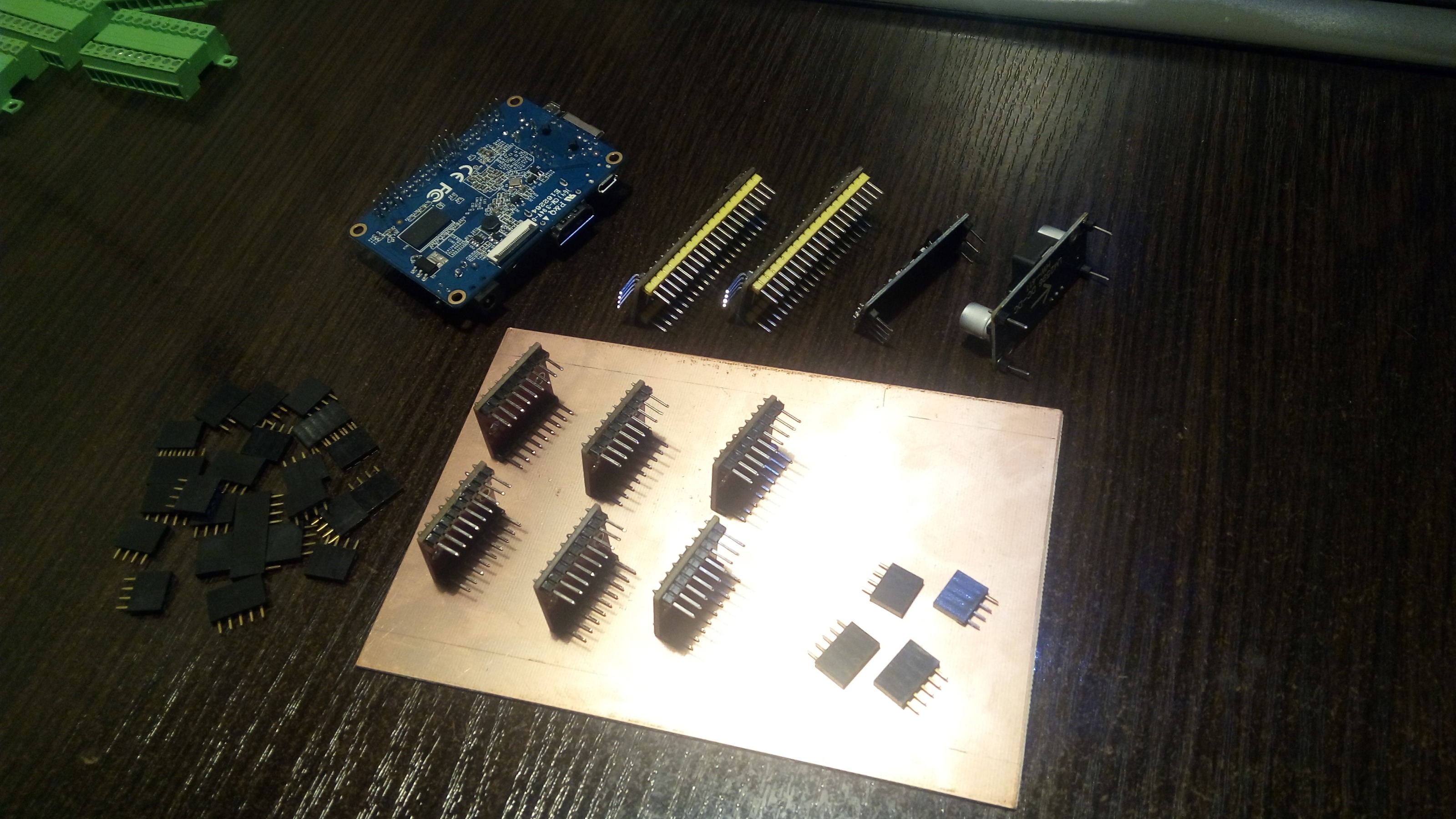

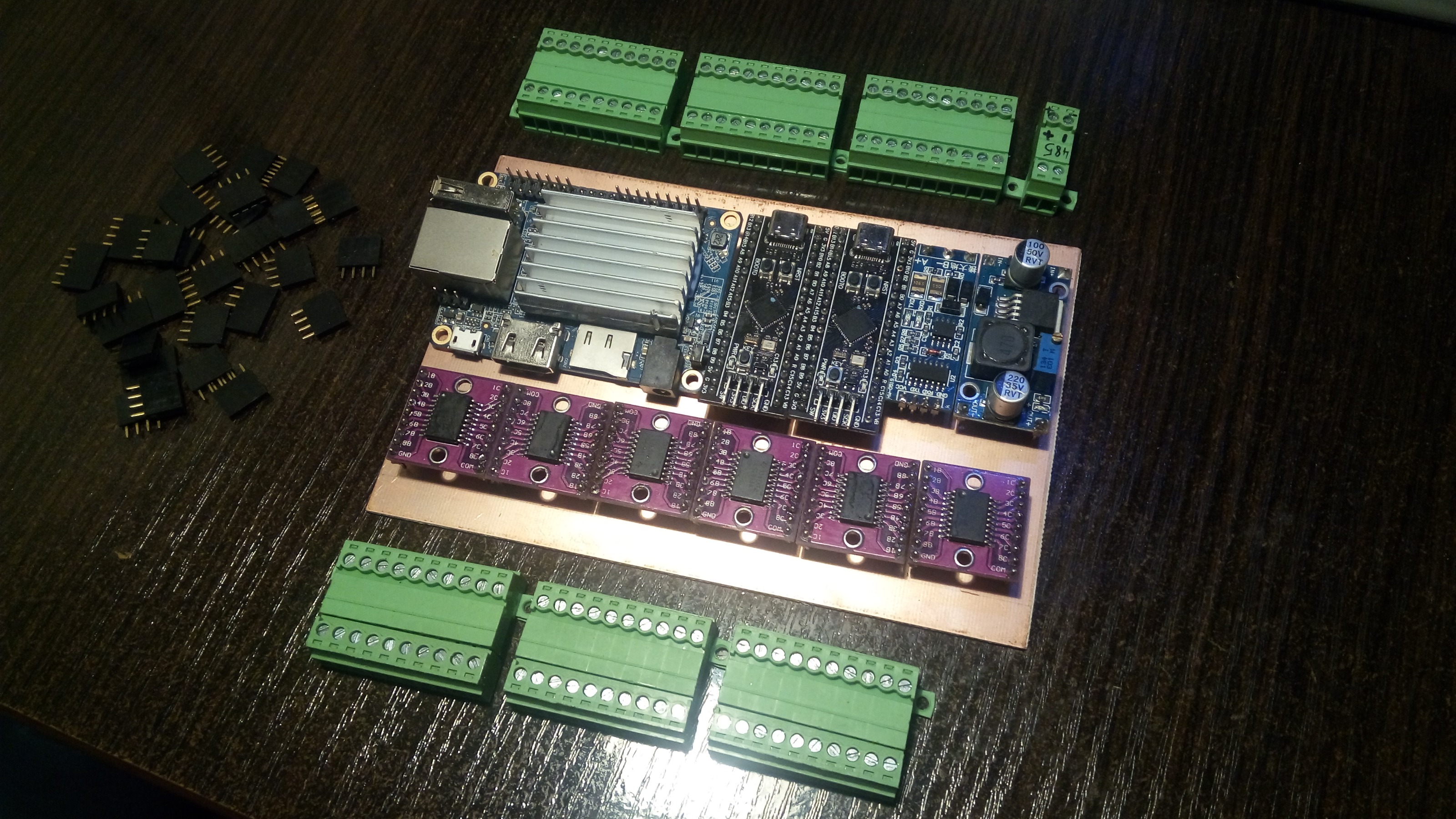

02 Oct 2022 10:57 #253242
by MX_Master
"NVEM + LinuxCNC" project it's a hobby for me now. I made my own pair of a firmware/driver for the old NVEM (STM32F207). And my work (and scotta's work too) can be moved into the trashcan soon (because of RT1052). My previous project (Orange Pi + LinuxCNC, "allwincnc") was archived because new Linux kernel/uboot pair breaks my work on the built-in CPU's firmware.
So I decided to force the development of my own controller for the LinuxCNC. I planning to use my code (partly) from both of those projects. The PCB will be a simple shield for the cheap modules. See the photos below. Some parts will be replaced to another ones for the simplicity. Planning to create a new topic soon.
