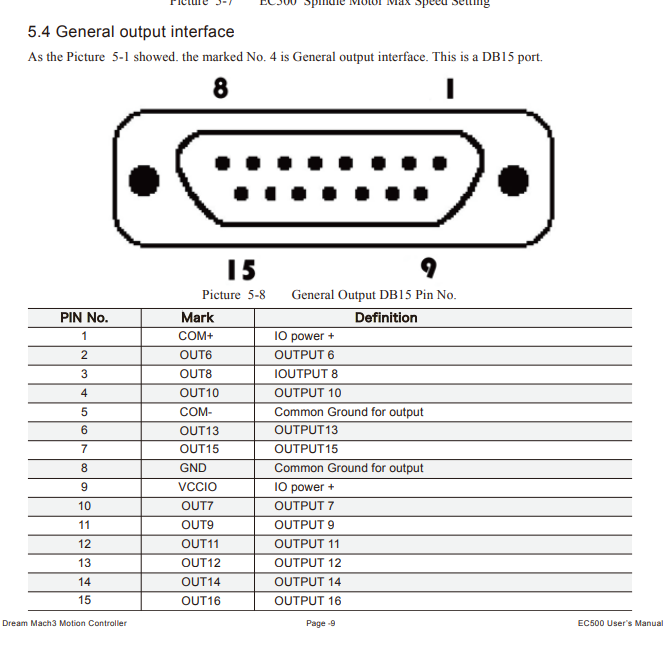

I checked the PWM signal today. Apparently it doesn't work. I connected a 9volt block battery to Gnd and Vso and measured in Com. Everything is displayed correctly in the Hal Show, however, the measured value between Vso and Com does not change. It is constantly at 8.7 volts. Is my measurement method correct?

You must connect 24Volt to the controller Main Power Port and the Output Power Port
Connect an Voltmeter at the COM and VSO of the Spindle port.
Give an command in Linuxcnc to run the Spindle and change the speed with a command. Look at the voltmeter if it changes.
Hi Scott,
I have connected 24 volts to the board and for the IOs. Likewise at the General Output Interface (Pin 1+5). I don't see any voltage on the VSO and Com. Regardless of the speed set in Linuxcnc.

Did you gave the M3 (Spindle CW) command and de S command in LinuxCNC?
Like S1000 or S750 or.......
You don't have to connect 24 Volt to the general Output. See manual EC500
Iff you have a voltmeter between COM and VSO and you have started the spindle (M3) and then change the rpm of the spindle with the S command the reading of the voltmeter (DC) should change

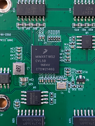

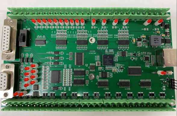

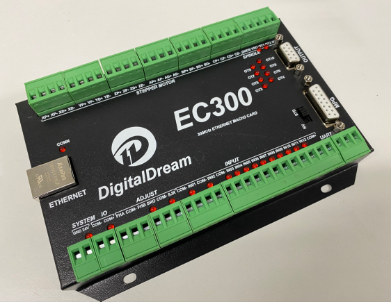

So just over two weeks from order my EC300 arrived. Like the EC500 it is quite well built and like the NVEM 2.1 has the iMX RT1052 onboard. Like the new NVEM it's using a multi layer PCB. Compared to the EC500 it is very similar except for changes to the optocouplers on the inputs and the addition of indicator LEDS for the IO.

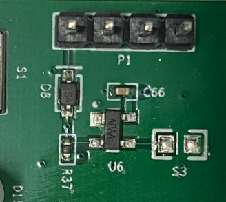

There is a 4 pin header and push button next to the Ethernet port. The button is connected to VCC. I was hoping that the 4 pin header was a fully exposed SWD programming port (VCC, SWDIO, SWCLK, GND), but not so. The left hand pin in the picture appears to be connected to the manual reset pin of a voltage supervisor IC.
I'm hoping the middle two pins are the SWDIO and SWCLK, the right hand pin is connected to GND. I'm thinking that due to the external flash memory and I2C EEPROM that the pin count of the RT1052 is maxed out and they are sharing IO with the SWD. Most likely using the push button on power up to change the boot sequence to make the SWD available (like the EC500). Adding this reset circuitry might allow the board to be reset with main power connected. S3 solder pads might need to be closed to connect the reset output to the MCU..?
