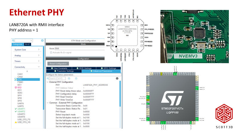

That would be a neat way of doing it, just no idea at the moment how to implement it. I'm just now getting into how to configure the STM32F207 for ethernet with the LAN8720 PHY that is on the board. On the learning curve at the moment.Hmm think it would be possible to send a config over ethernet?
so you would have a config file located in your linuxcnc config folder then sets the values.
But i think for getting off the ground fast just setting it for most other peoples use case would be better.
I myself do have a few st-links in a drawer somewhere if i needed to make changes.
Whats the part number on the optos?

I'm contemplating doing this version of Remora in STM32CubeIDE rather than Mbed Studio as this will be specific to the NVEM board with the STM32F207.
Thoughts?
