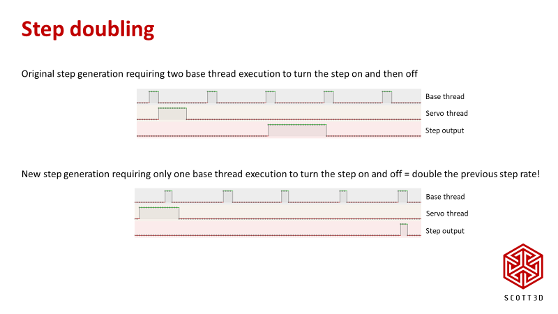

16 Feb 2022 02:36 #234999 by scotta
Every so slowly getting Remora-NVEM to a point to be able to release 1.0-rc. Good news is that the work to get step rate doubling working has been successful. This will roll into the main Remora code but it's currently running on the NVEM board. I needed to get this running as the slower clock rate on the STM32F207 and running 6 step generators was reducing the achievable step rate. Some fine tuning and we should be able to get 40 - 50kHz step rate on all 6 step generators simultaneously.
