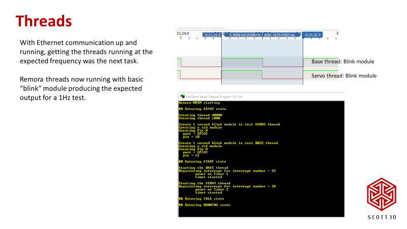

21 Jan 2022 15:58 #232690
by scotta
Remora-NVEM is getting closer to turning a motor. The threads are up and running at expected frequency. This was a bit of a challenge and where debugging capability has really useful.
STM32Cube appears not to move interrupt vectors to RAM like MBed. This took some figuring out as the MCU crashes as the program pointer headed off to an unexpected memory address. I'll need to investigate this further as a RAM vector table is needed when using a bootloader.
It was really pleasing to see that the STM32F2 uses the same HAL has the STM32F1 so the code could be dropped in and up and running super quick.
Next step, getting the Stepgen module up and running and spinning some motors
