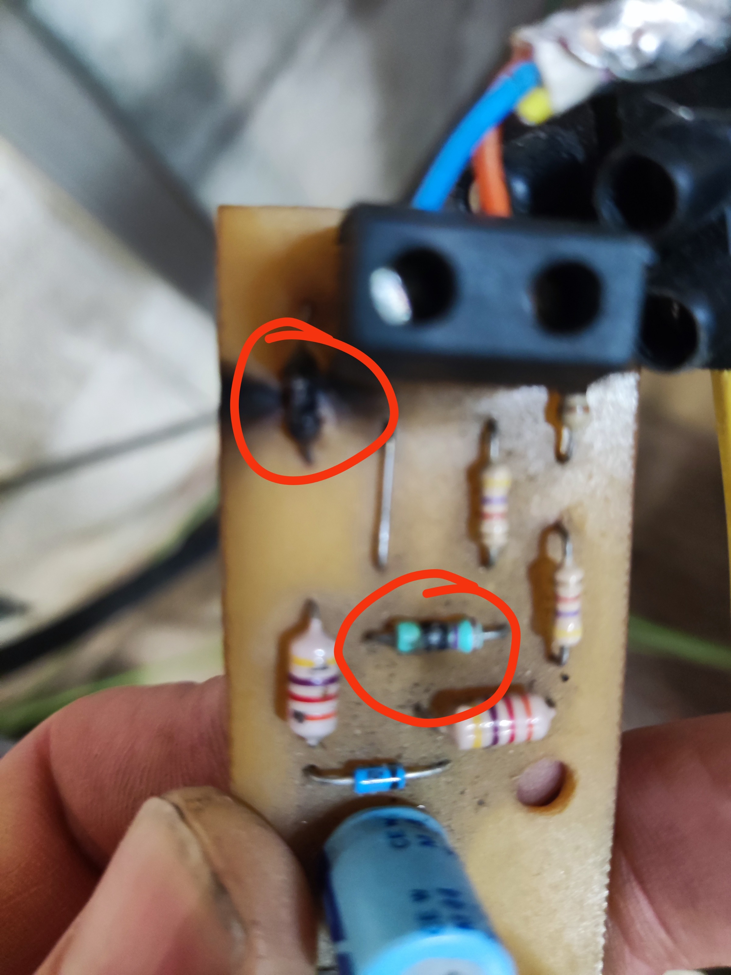

hello, thank you for your help I will receive my card in a week
did you go through the stepconf?
you can try that. I tested it works but the voltage divider gave up the ghost
github.com/memisibram/Arduino-Plasma-THC...r%20all%20controller

the voltage divider was made by a friend, I ordered the components to make this one
github.com/memisibram/Plasma_Voltage_Divider
