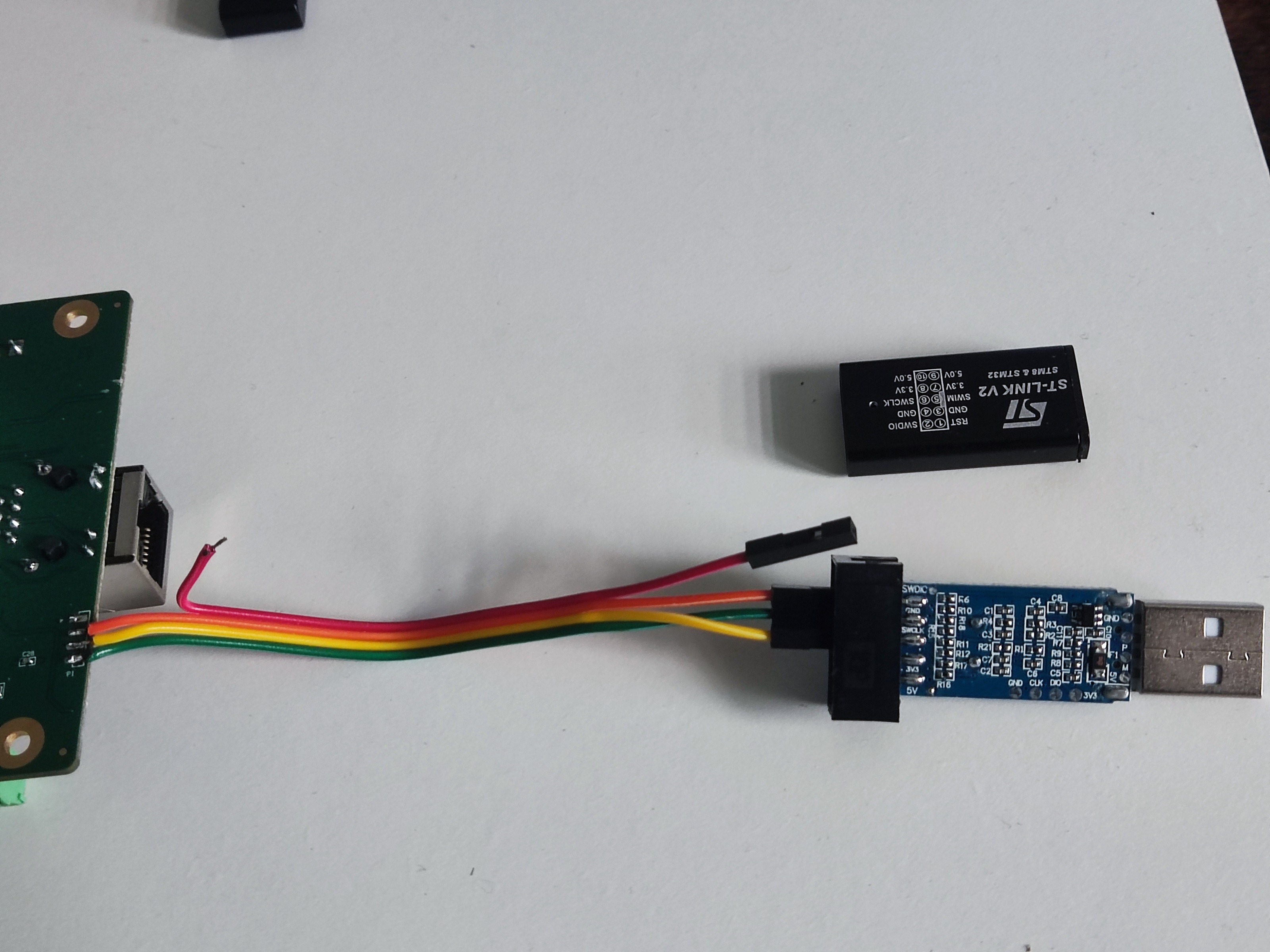

bonjour
j'ai reçu la carte nvem, j'ai commandé une V2.1 et j'ai reçu une V5
la puce est une RT1052
est-ce qu'une stm32 est meilleure ?

Hi beauxnez,
I'm guessing that you are needing to know any difference between NVEM V2 and V5.
NVEM V2 SWD connection is shown here: 15 Jan 2022 03:42 #231852
I see that your V5 has an additional underside component or solder joint inboard from your green wire connection, so there are differences and reason to verify the order of the SWDIO, SWCLK & GND.

I just have the SWDIO, SWCLK and GND to connect to the SWDIO, SWCLK and GND of the programming key?
no 5v or 3.3v?
out of the 150 pages is there one that explains the procedure for flashing? a v5 version, v2 looks simpler flashed
no 5v or 3.3v?
