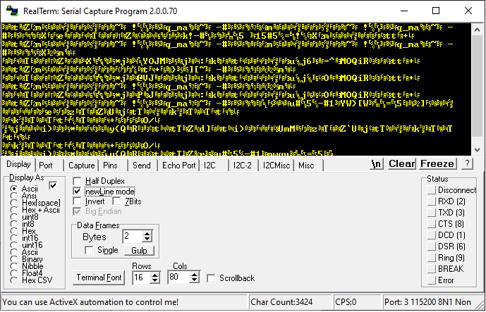

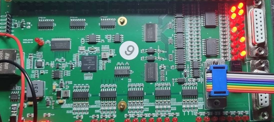

08 Jan 2024 04:55 - 08 Jan 2024 04:57 #290177 by wazza77
Hi Scott,I have received an EC500, I flashed it with the 3.1.2.bin using Pyocd it looks like a success on boot up it has lit up 8 LEDs on the io output port see pictures and I received a lot of garbled data on the serial terminal but it might be my settings in real term I can ping the Ec500 and when I toggle emergency stop on LCNC the connect led lights up on EC500 yet to upload my configuration. I am not sure if it is all correct due to LEDs and serial output, are the LEDs meant to light up like this?Warren

09 Jan 2024 04:56 #290258 by scotta
Hi Warren, looks like some good success. Those lights being lit up on the outputs in due to the default config not configuring those. Once you upload a full config file they will be properly available.

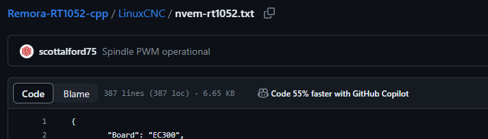

12 Jan 2024 11:25 #290493 by raf1110
Hi
I am bit confused if file LinuxCNC/nvem-rt1052.txt is correct for NVEM rt1052 eth.
In file it states board: EC300.
Is this correct or shoud be board:NVEM?
