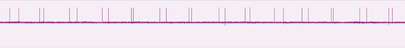

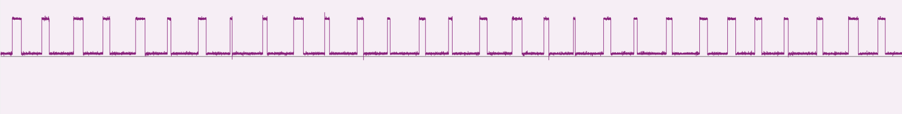

23 Mar 2024 19:34 #296591 by Wiretap
Thanks for the great work on Remora,
But I seem to have found a slightly strange bug. Using purely the example configs (as attached) I have an interesting behaviour.
If I move an axis (only tested with X so far as my 'machine' is currently just electronics, no motion assembly) beyond a certain point in either direction from 'home' (whatever it was at poweron), the axis completes its movement, stops for ~1s, then begins endlessly 'walking' in the negative direction.
I have verified this isn't noise. It is full-depth pulses on the step/dir pins. Scope capture attached for both.
The 'walking' stops if the 'machine power' button is off, or if in e-stop. However it will resume on reactivation of the machine. It only stops if you bring the axis back close to zero in LinuxCNC.
During this behaviour, the DRO in LinuxCNC is not moving, this is definitely happening within Remora rather than LCNC itself.
