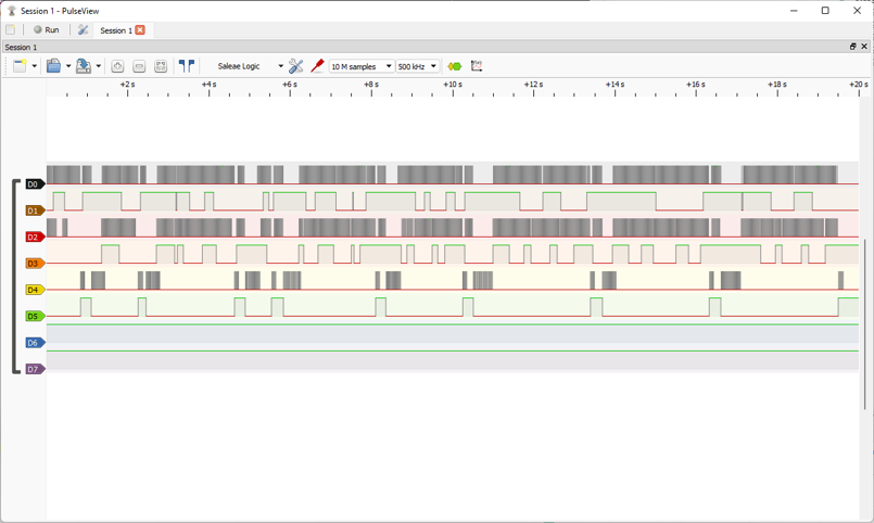

Hi cakeslob,
Thank you for your time.
I have bought a low-cost logic analyser with fx2lafw firmware and I hope to utilise the open source sigrok software with ‘Stepper motor’ protocol decoder, to verify my EC300 step/dir timing and rising/falling sense.
It will be interesting to verify the timing that was set in the config.txt.
I haven't managed to get any results using the logic analyser; I will keep trying.
I still have inconsistent steps using the LCNC jog 1mm 5mm etc presets, so I tried assessing the EC300 step output signal using an oscilloscope. I have little experience using this secondhand oscilloscope so please jump in with advice on better settings.
First, I verified that the driver and stepper motor are working properly, independent of the EC300. The HBS860H driver has a PC program to adjust parameters and test run the stepper.
youtube.com/shorts/UL64FQ7sgdE
These are my oscilloscope results, using two channels, CH1 (yellow trace) on 'XP+', CH2 (blue trace) on 'XP-' and the ground from both probes on 'SYSTEM GND'.
Please advise of better oscilloscope connection to prove out step pulses. Maybe I should attach probe grounds to 'COM-' adjacent to 'IN01'?
youtube.com/shorts/qvkYAdwXUSY
youtube.com/shorts/Cg28S9qeHRg
I'm looking for the best means of verifying the step pulses, has anyone else done this?

02 Mar 2024 21:21 #294950
by cakeslob
Replied by cakeslob on topic Remora - ethernet NVEM / EC300 / EC500 cnc board
tim, ill be honest, all this numbers stuff is over my head.
you can verify the output from the ec300 (software side) using halscope
linuxcnc.org/docs/stable/html/hal/tools.html#sec:halscope

03 Mar 2024 00:23 #294965
by scotta
Hi Tim,
I use a cheap logic analysier for my development work. That's how I've tested the step timing capabilities of the firmware. The traces below are from the EC300 / EC500 looking an only one side of the differential driver. What you are seeing on your scope is the two sides of the differential driver doing their thing.
The following user(s) said Thank You: tommylight, TimGow

- TimGow
- Posts: 36
- Thank you received: 3
04 Mar 2024 08:44 #295116
by TimGow
Replied by TimGow on topic Remora - ethernet NVEM / EC300 / EC500 cnc board
Scott, thank you for the logic analyser output example.
The combination of EC300 and the HBS860H stepper driver is behaving badly for me. The EC300 controls TC6600 drivers just fine for some test NEMA17s.
I'm concerned that the step low and high states are not perhaps within required range (low -0.5 to 1.5V, high 3.5 to 5.0V ?).
Some stepper drivers are fed 5V on step+ and dir+, and the step -'ve and dir -'ve sink to ground when signal is low. I'm wondering what other tests to try.
