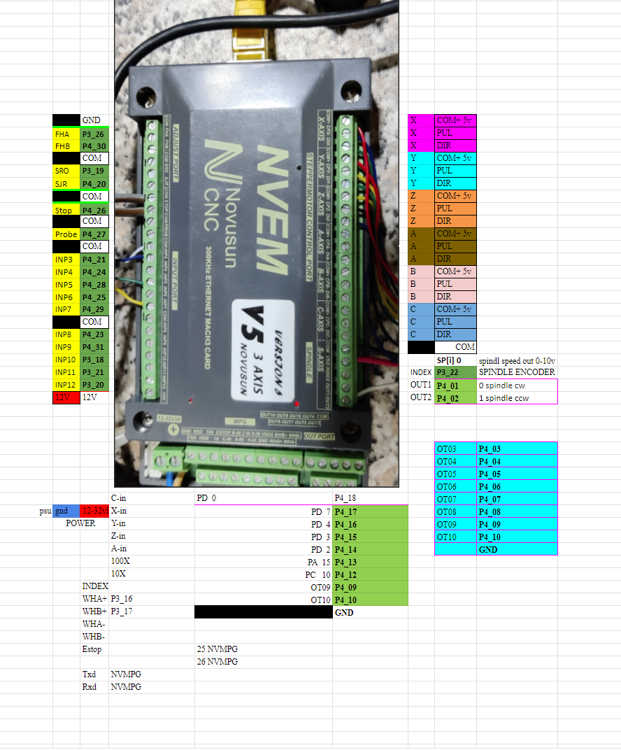

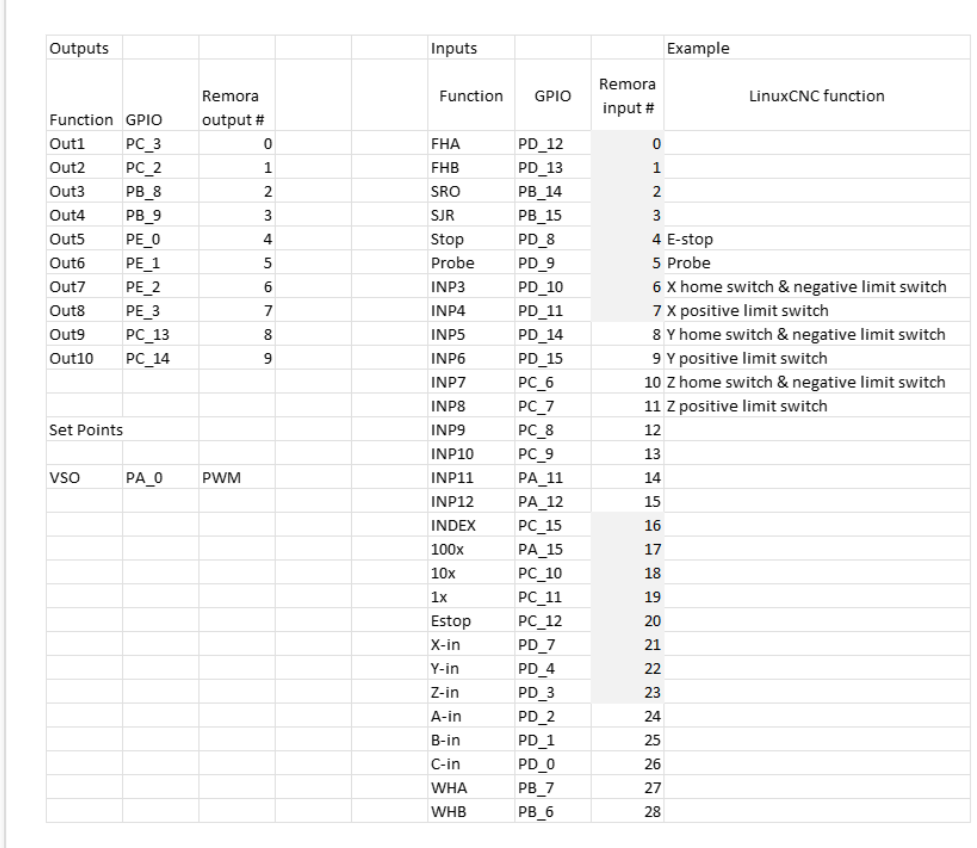

12 Aug 2024 19:20 - 12 Aug 2024 19:22 #307584
by Lpkkk
Replied by Lpkkk on topic Remora - ethernet NVEM / EC300 / EC500 cnc board
Hi pin outputs you can find in the attachment.
Estop has 2 pins, same for probe. Other inputs have one common and one negative for each input.
Last edit: 12 Aug 2024 19:22 by Lpkkk.

- cakeslob
- Posts: 927
- Thank you received: 280
12 Aug 2024 20:56 #307594
by cakeslob
Hey, dont use this one if you have the RT1052, i dont even know how yours is still working if youve been using that one. The one you keep posting is for the STM32 version of the NVEM. use this one by raf
Replied by cakeslob on topic Remora - ethernet NVEM / EC300 / EC500 cnc board
oK lads I have got made a thing.
Hope this will help somehow
Pinout NVEM v5 RT1052 Remora firmware config pinout
The following user(s) said Thank You: AlessandroEmm
