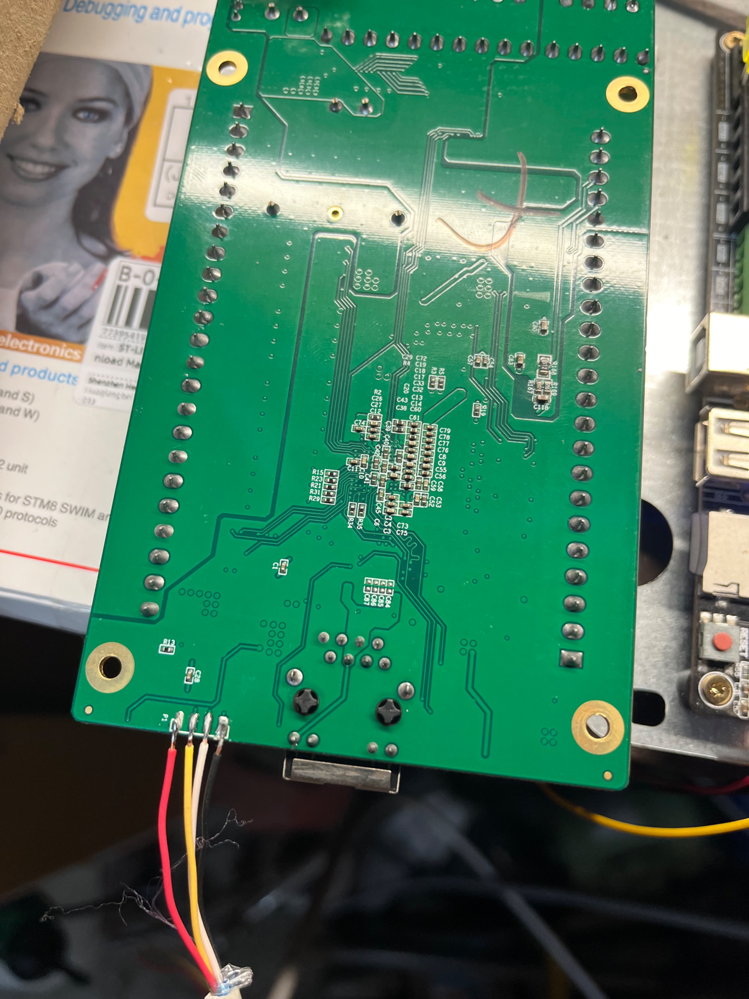

by cakeslob
ok, so pyocd, CMSIS-DAP firmware, stlink
give me some more notes, im trying to do a docs thing
github.com/cakeslob/Remora-docs/blob/mas.../Ethernet/rt1052.rst
Replied by cakeslob on topic Remora - ethernet NVEM / EC300 / EC500 cnc board
I've also had no luck with an out of the box STLinkV2. But ColdTurkey has got it to work
pyocd.io/docs/debug_probes.html
"Recent STLink firmware versions will only allow access to STM32 targets. If you are using a target from a silicon vendor other than ST Micro, please use a different debug probe."
If you have a couple of probes you can always flash one with the following firmware.
github.com/scottalford75/Remora-RT1052/tree/main/CMSIS-DAP

Just to be sure that I didn't make any wiring mistakes. Red = gnd, yellow = clk, white = dio, black = 3.3v (not needed for flashing). The board is blasted with 24v.
