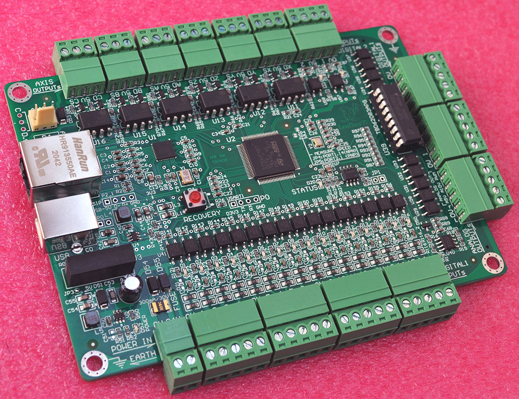

04 Sep 2024 16:27 - 04 Sep 2024 19:09 #309367
by aDm1N
Replied by aDm1N on topic Remora - ethernet NVEM / EC300 / EC500 cnc board
Does anyone have a tip as to what I'm doing wrong?
[/code]
cnc@MiniDrehbank:~/linuxcnc/Remora-RT1052-cpp/Firmware$ pyocd list
# Probe/Board Unique ID Target
0 Segger J-Link (unknown) 123456 n/a
cnc@MiniDrehbank:~/linuxcnc/Remora-RT1052-cpp/Firmware$ pyocd flash remora-rt1052-3.1.3.bin --target mimxrt1050_quadspi
0004519 C Memory transfer fault (Unspecified error.) [__main__]
0 ARM DAPLink CMSIS-DAP 070000811a5a5bb50000000001ef41eca5a5a5a597969908 ✖︎ stm32f103rb
NUCLEO-F103RB
0002174 C No ACK received [__main__]
0 STM32 STLink 14001B00172D363637365744 n/a
0001768 C STLink error (9): Get IDCODE error [__main__]
I still have an ST-link to test. I'll install the other firmware later. Unfortunately another ST-Link broke during the attempt.
[code]pyocd pack install stm32f103rb

06 Sep 2024 14:46 #309502
by aDm1N
Does anyone else have a tip as to what I'm doing wrong? I haven't found anything on the net until now. STLink with the instructions here from the thread didn't work, stlink with the hex file here from the thread flashed successfully, according to the display. NVEM v5 - Flashing not possible. I tried with DAP-link, J-Link, ST-Link v2 standard, firmware update and firmware from github. The result was the same every time, regardless of whether it was from the Raspberry Pi or with Windows 10. Either the board is fundamentally different, which I don't believe since it was recognized, or the programmers from AliExpress are all unusable.
the error messages are:
C Unexpected ACK value (0) returned by probe [__main__]

- scotta
- Posts: 959
- Thank you received: 489
17 Sep 2024 20:36 #310346
by scotta
Hi, the encoder module is for a quadrature encoder, ie A and B channels required.
- xaxexa
- Posts: 12
17 Sep 2024 21:23 #310347
by xaxexa
Replied by xaxexa on topic Remora - ethernet NVEM / EC300 / EC500 cnc board
as I understand it, the documentation suggests using QEI Encoder, but I didn't find this module anywhere in the rt1052 cpp sources, is there a non-quadrature encoder in rt1052 cpp? and if possible an example of a txt file
