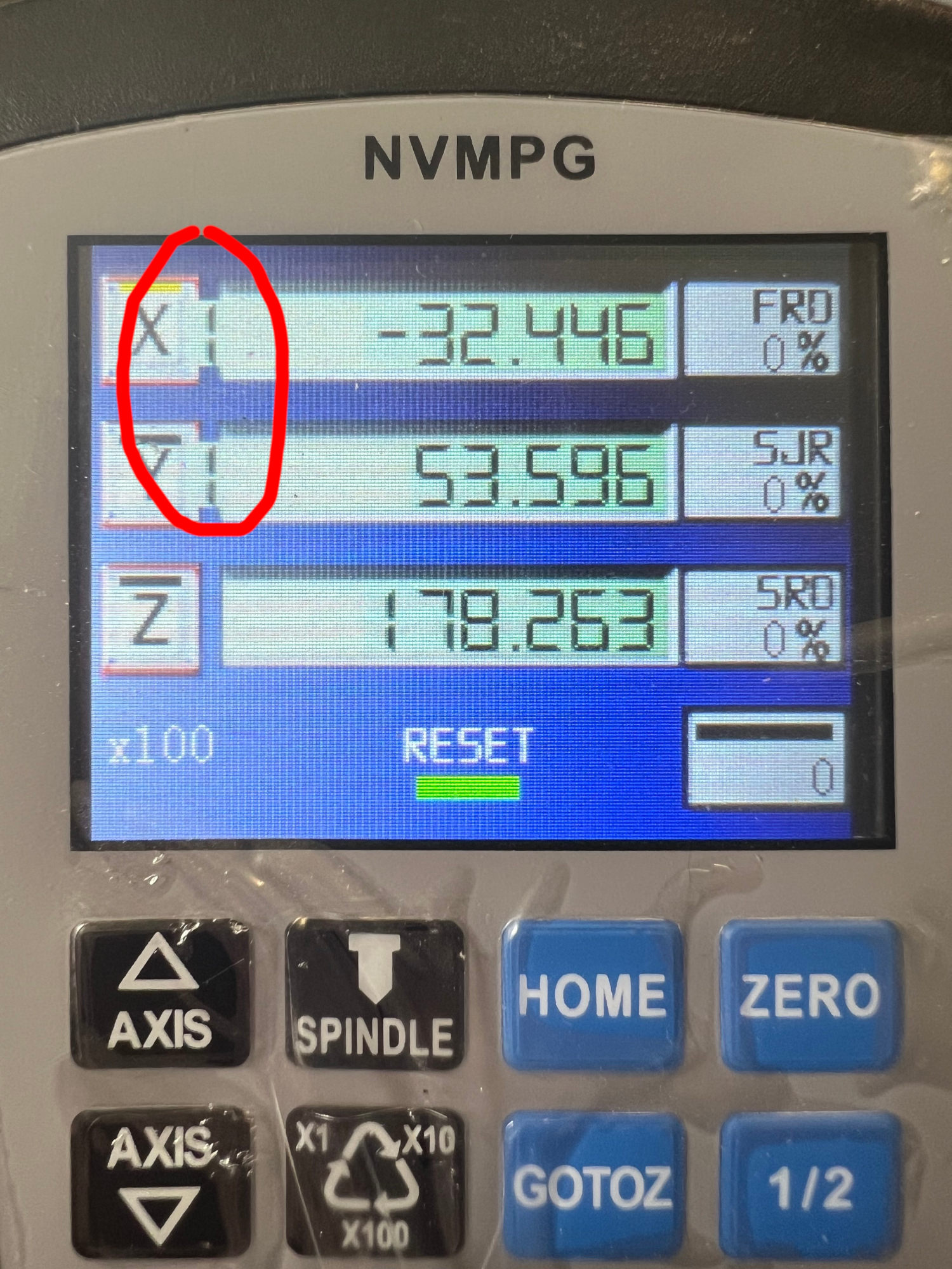

Thanks for tackling the NVMPG display issue!
I've updated to 3.1.3 and the NVMPG display is now updating correctly.
I have encountered a possible bug:
While jogging with the NVMPG It sometimes changes the axis suddenly and overruns the NVMPG display value, leaving a digit to the extreme left in the X and Y position fields, partially outside the field.
The NVMPG continues to work, but on the new axis and the extra digits remain until power cycled.
Attached is an example of the corrupted display.
