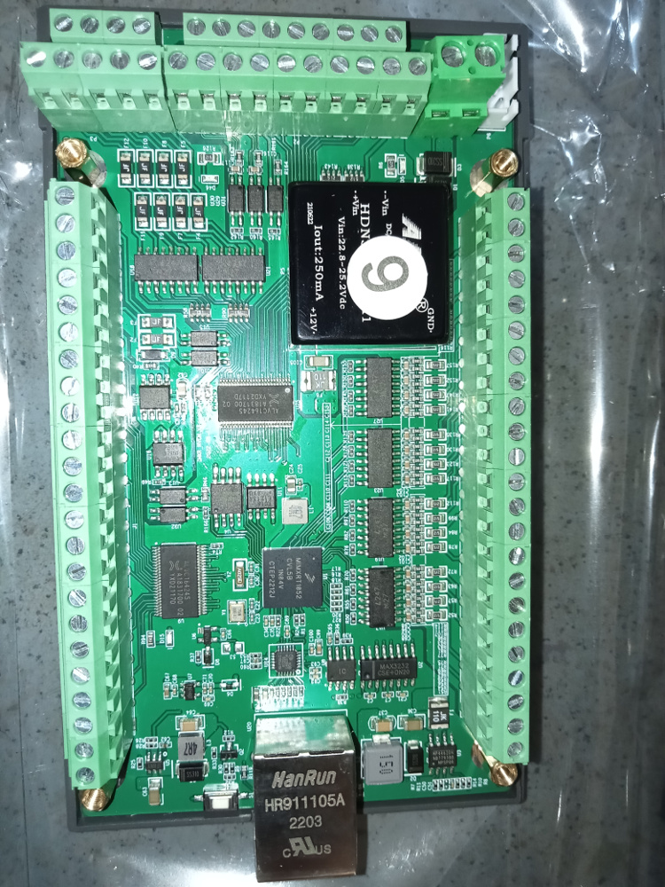

Cool, the new NVEM has external QSPI flash. Hopefully we can read using the i.MX RT Flashloader or NXP-MCUBootUtility.

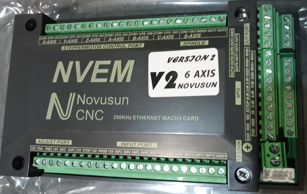

19 Sep 2022 11:13 - 19 Sep 2022 11:14 #252334 by epineh
So at this stage I'm not sure if this is good or bad but my NVEM "V2" has arrived and by the looks of it has the NXP IMXRT1052 chip...
