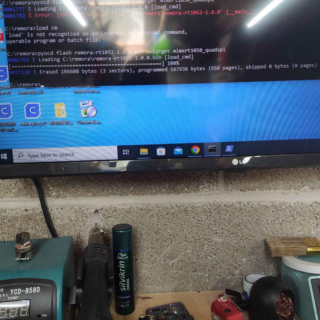

05 Jul 2023 12:07 - 05 Jul 2023 12:10 #274824 by Murphy
For anyone wanting to install firmware to EC500 with RT1052 with one ST-Link I just ran the Linuxcnc live install from USB and got it to work first go with zero drama.
Only three commands run, factory settings ST-Link. FW version V2.J29.S7sudo apt install python-pipsudo python -m pip install -U pyocd(run this last command from folder with firmware file, make sure highlighted text matches your file name)sudo pyocd flash ./[color=
Last edit: 05 Jul 2023 12:10 by Murphy.
05 Jul 2023 12:47 #274827 by Murphy
Success , I got it working in Windows. Stupid user error. I never ticked the box to allow python to be run from the CMD line.

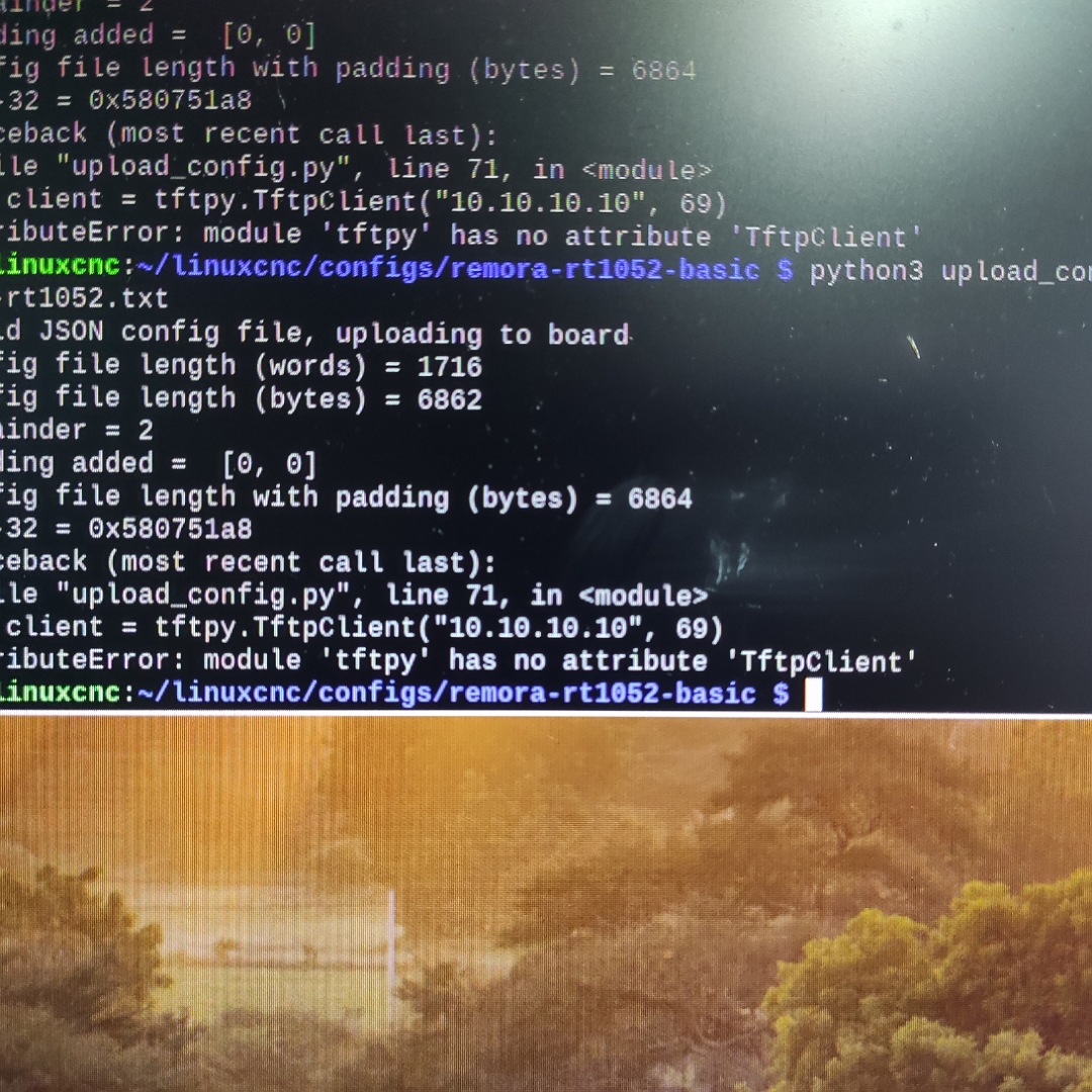

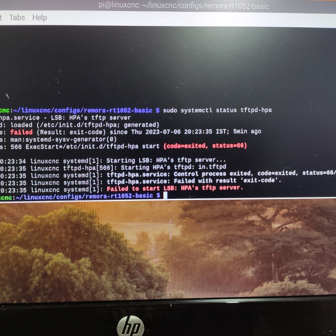

06 Jul 2023 15:36 - 06 Jul 2023 19:33 #274895 by Murphy
Could someone help me with this attribute error. I have flashed the board with the firmware. I can ping the board at 10.10.10.10. when I go and upload the config I get this error below.
I installed tftp. But it's getting an error when I check the status of it
Last edit: 06 Jul 2023 19:33 by Murphy.

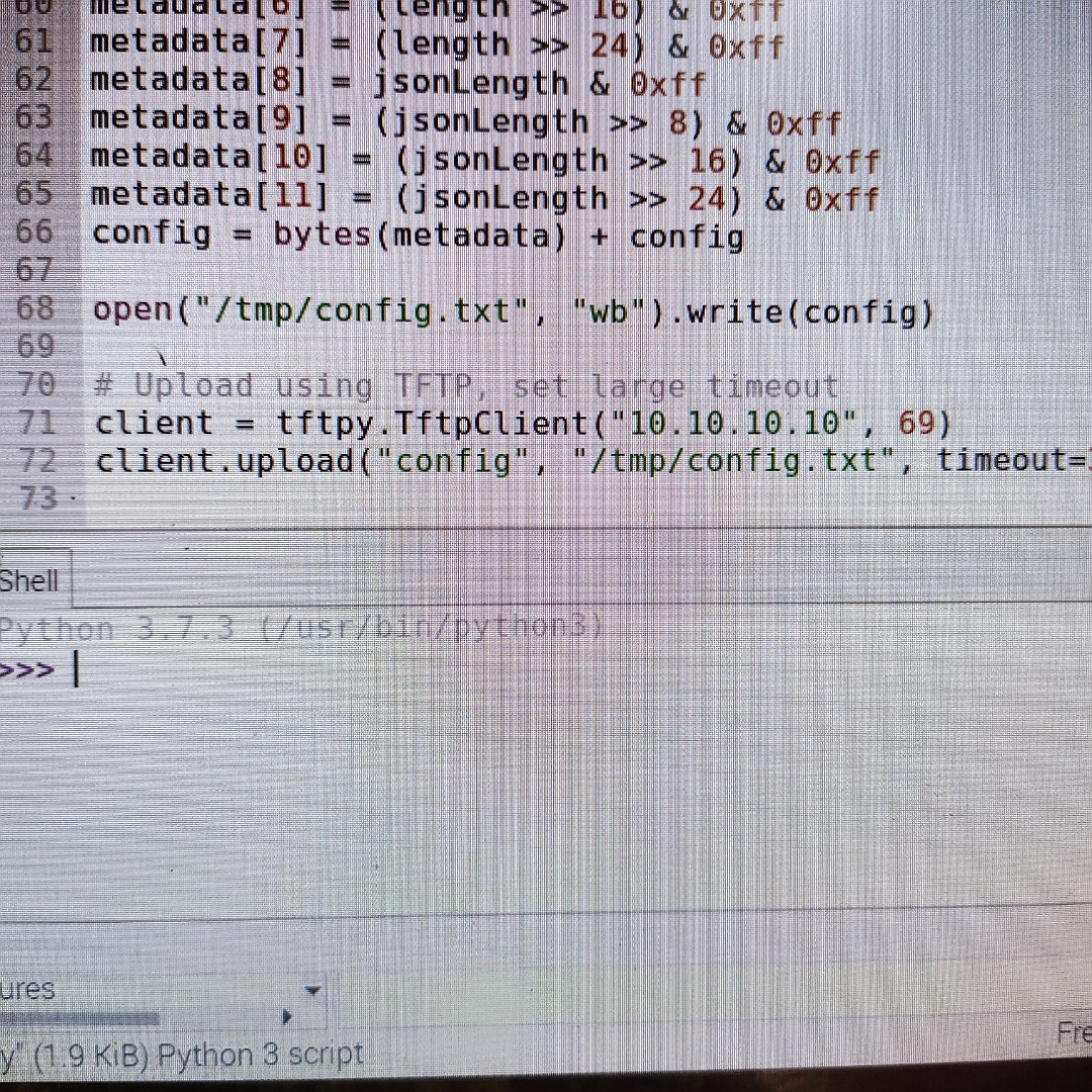

06 Jul 2023 21:56 #274912 by scotta
When you said you installed tftp, what did you do as you should not need a daemon running. You should only need to install TFTPy using pip.
pip install tftpy

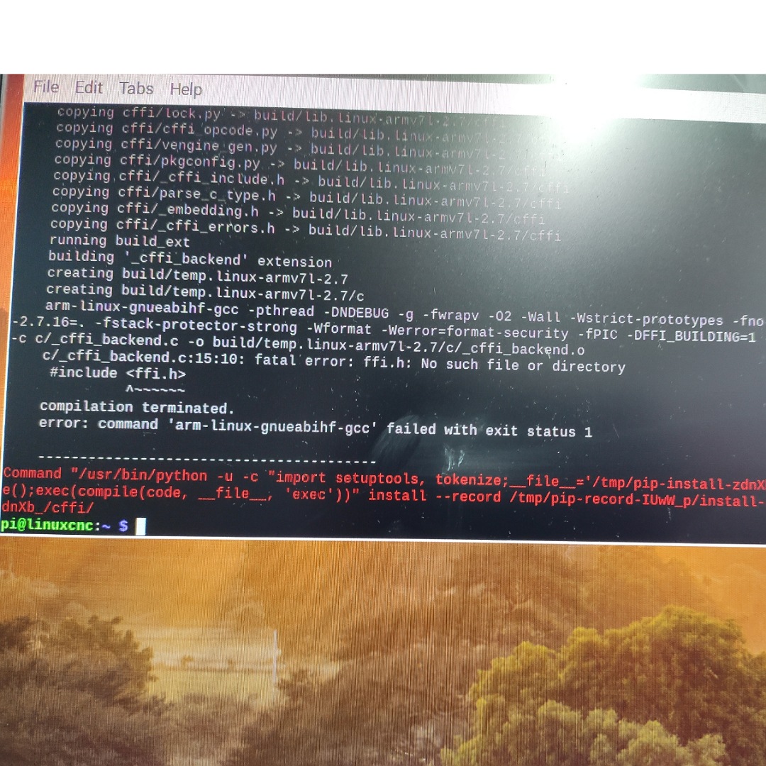

07 Jul 2023 05:57 - 07 Jul 2023 06:41 #274929 by Murphy
Thanks Scott I'll try that. I used "sudo apt-get install tftpd-hpa"
ok so i installed with pip tftpy.Still the same error when I try and upload the config
Last edit: 07 Jul 2023 06:41 by Murphy.

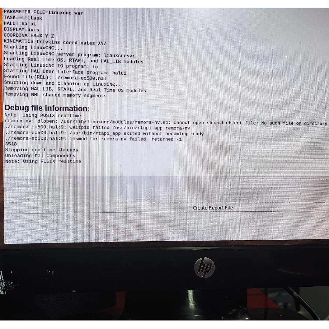

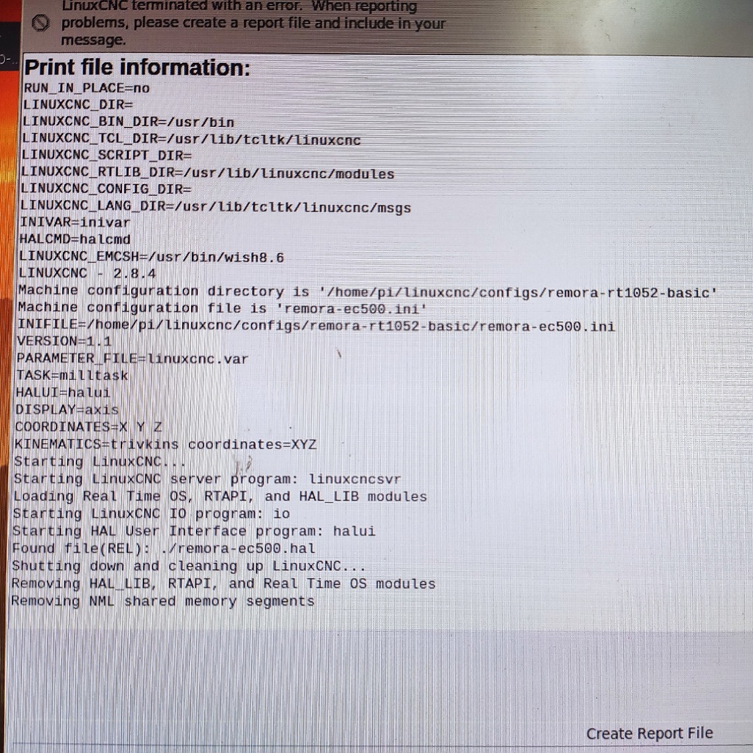

07 Jul 2023 19:26 - 07 Jul 2023 19:29 #274950 by Murphy
Ok so I managed to get the config uploaded. when I run linuxcnc I get the following error. I moved the remora-nv.h and remora-nv.c to the Linuxcnc module directory. But still comes up with the same error
