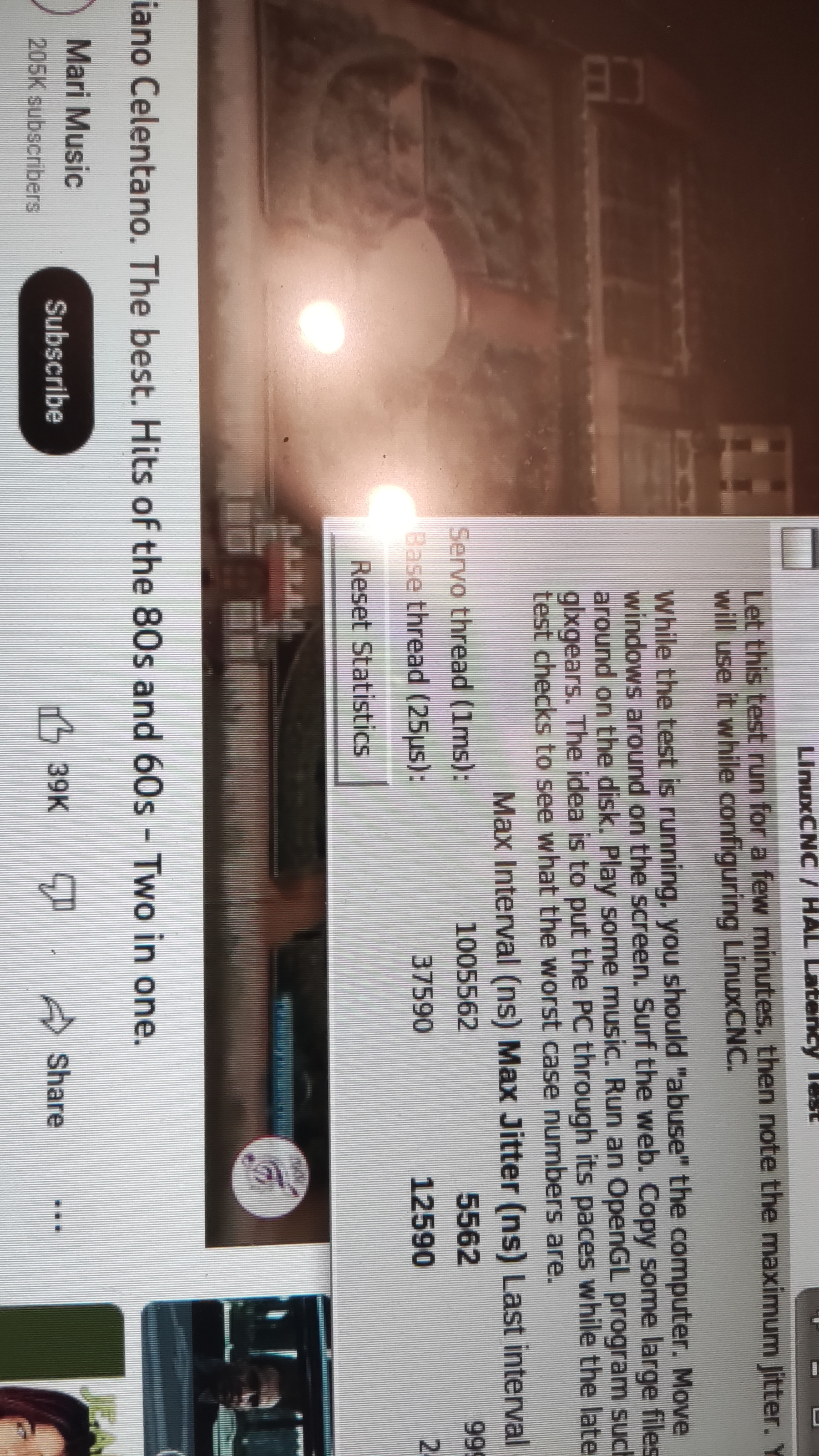

Recently, i bought separated lcd frame with same dimension as in my panel and with vga connector. And Asrock j3355b-itx mb.
After some tweaking, isolcpus=1 and disabling most of advanced feautures in bios, i am in a 25k region while watching youtube etc..
Feeling half hungry up here - was expecting more. Or 25k is ok for j3355 cpu ? Running latest 2.8.4 buster ?

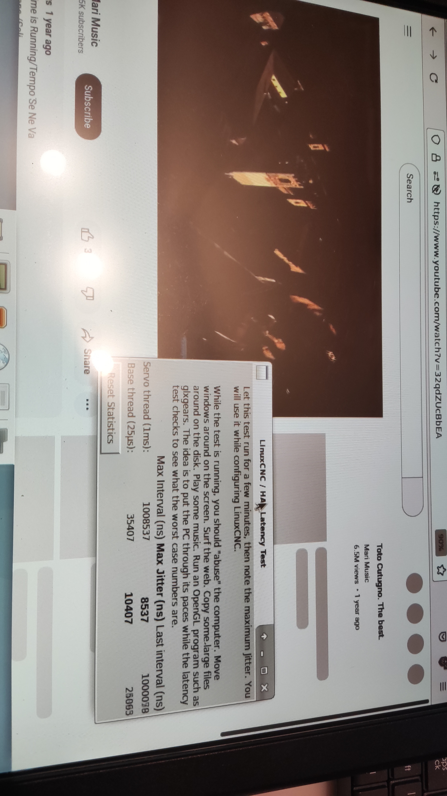

10k with youtube.
Going next.
Going next.

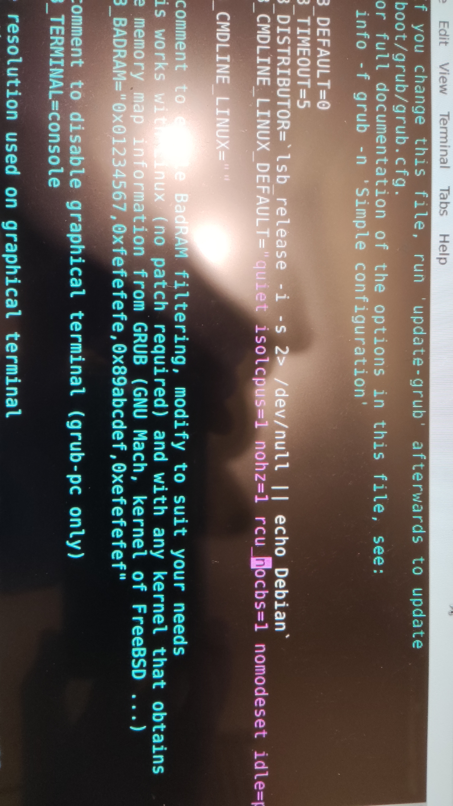

Fix the nohz=1 to nohz_full=1
Then make sure you update grub so your new defaults take effect. Note that the nohz_full and rcu_nocbs settings will not work on Buster, others should work just fine.

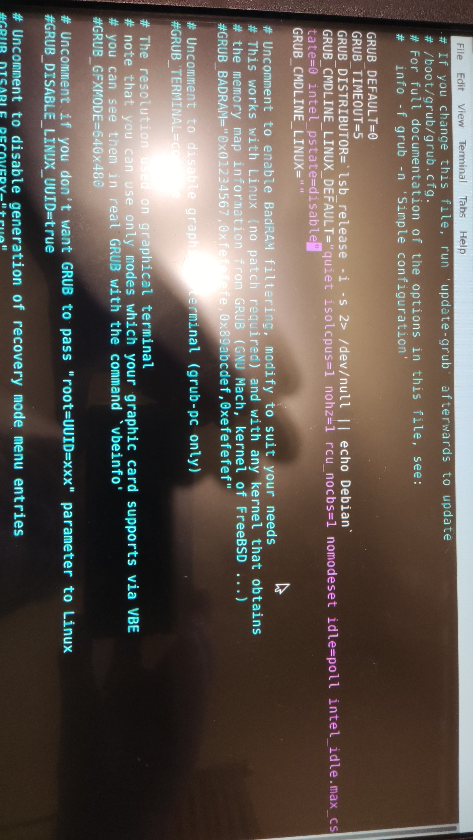

12-13k with two intel parameters. Reverting back..

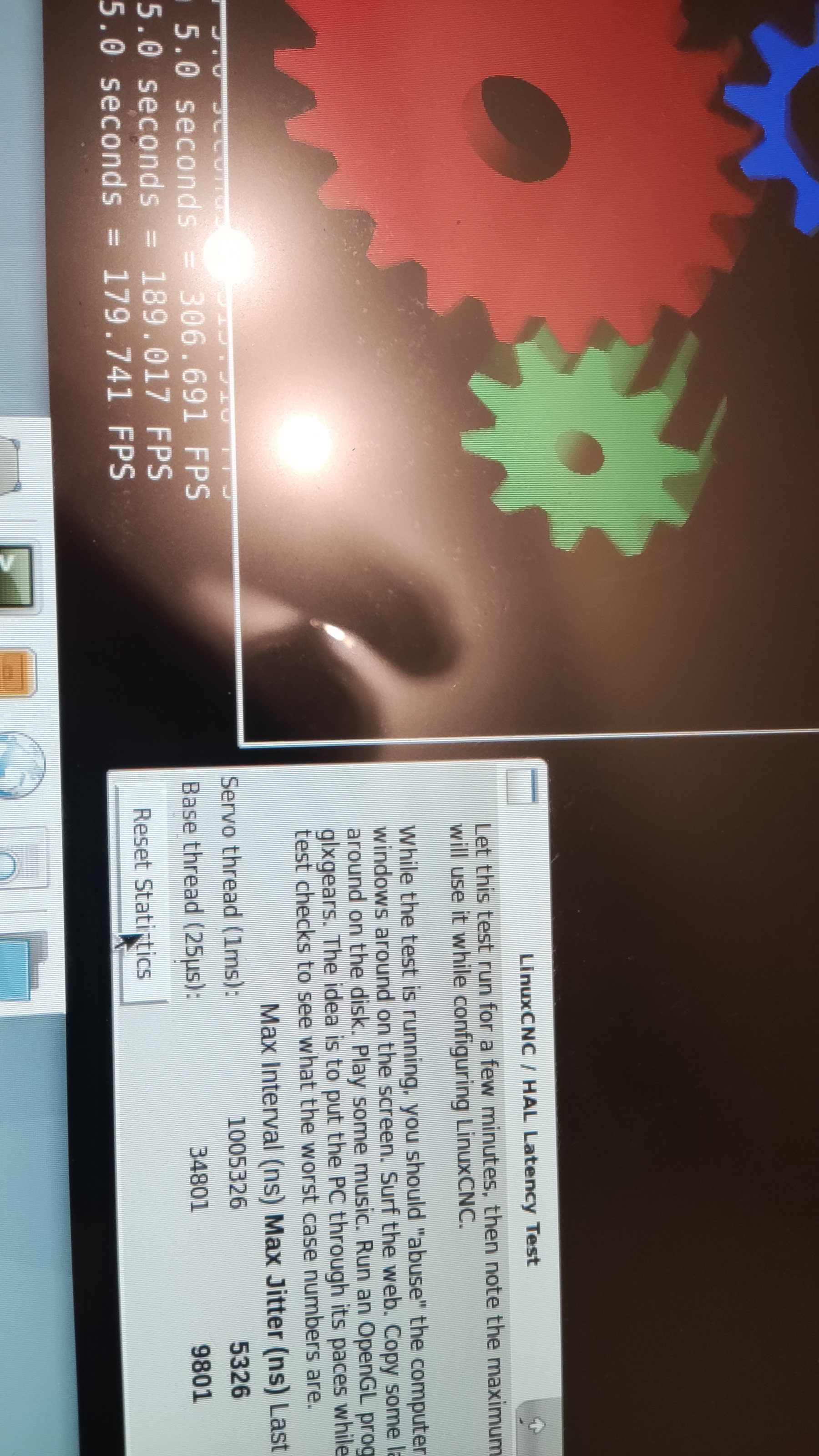

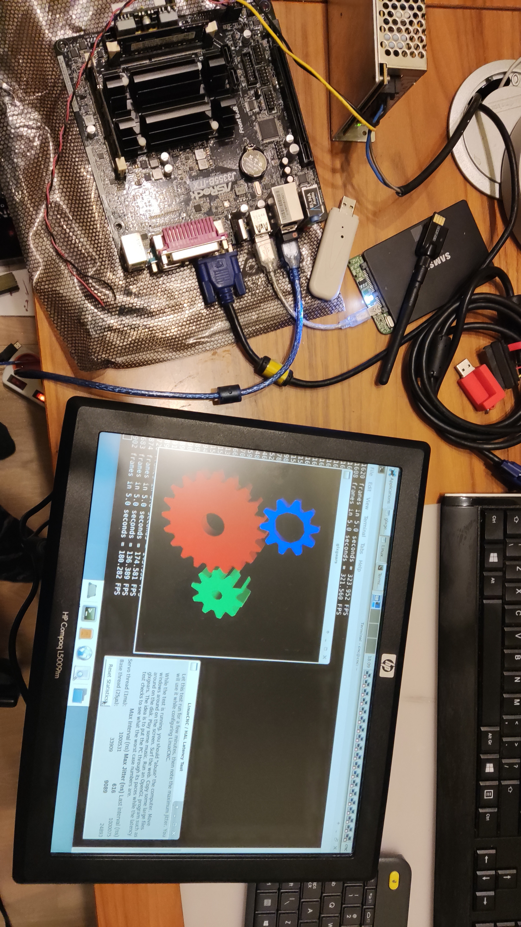

Glxgears, wifi usb removes. Still in 10k region. Starting to like it. Fixed mentioned parameter, updated grub.

No, i have not update it at all. Hot wifi only a day after install.
Shell i do it ?
All night running with glx gears - 11k.
Much better whan it was.
