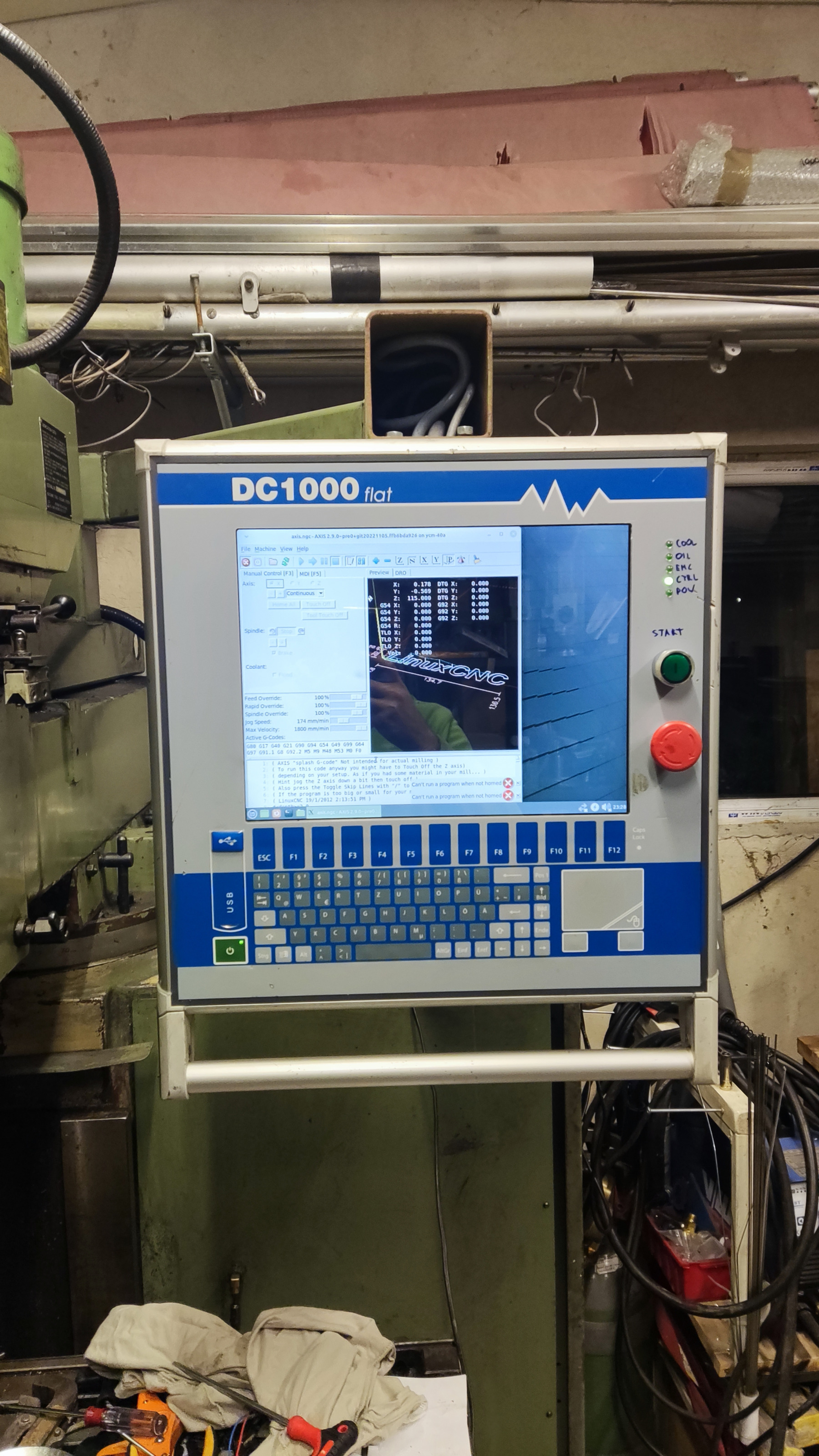

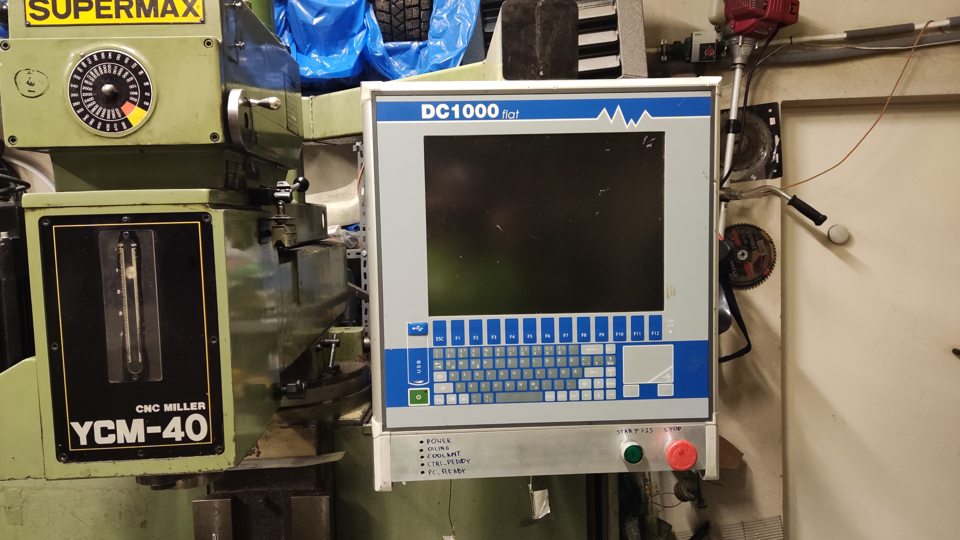

14 Jan 2023 15:38 - 14 Jan 2023 15:40 #261987 by Stanislavz
Replied by Stanislavz on topic Latency test
Will do it tomorrow. Today finished upgrading my controller. Or not.. it is newer ends. Removed small add on panel.. new lcd was smaller, so i got some place for start stop buttons and leds..

14 Jan 2023 15:52 #261989 by rodw
Replied by rodw on topic Latency test
A very nice console :)

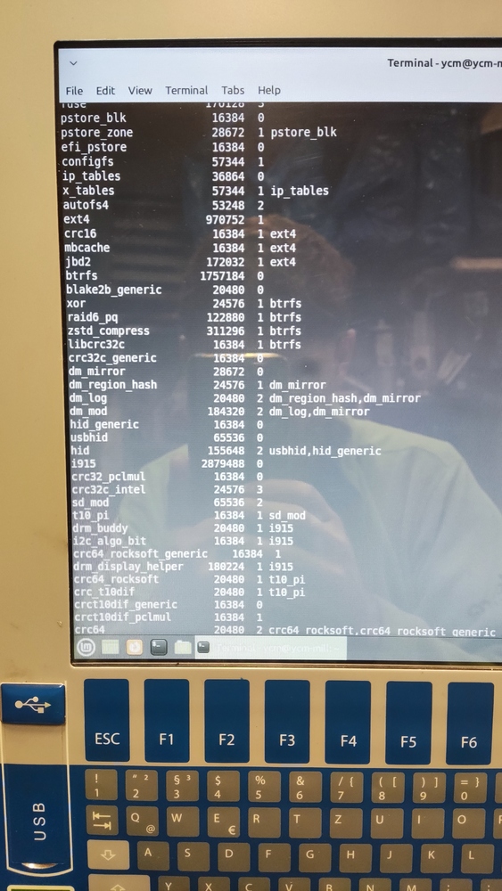

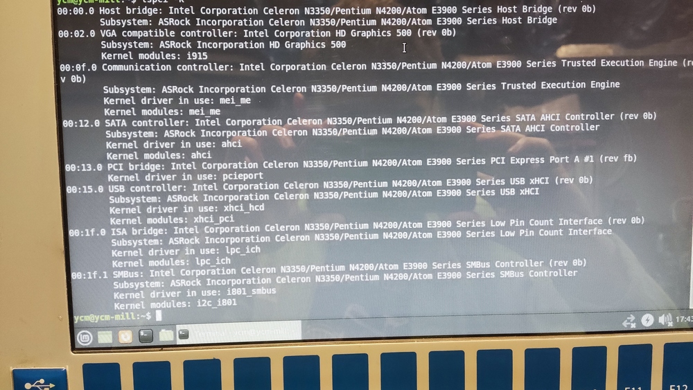

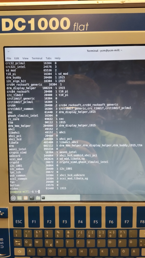

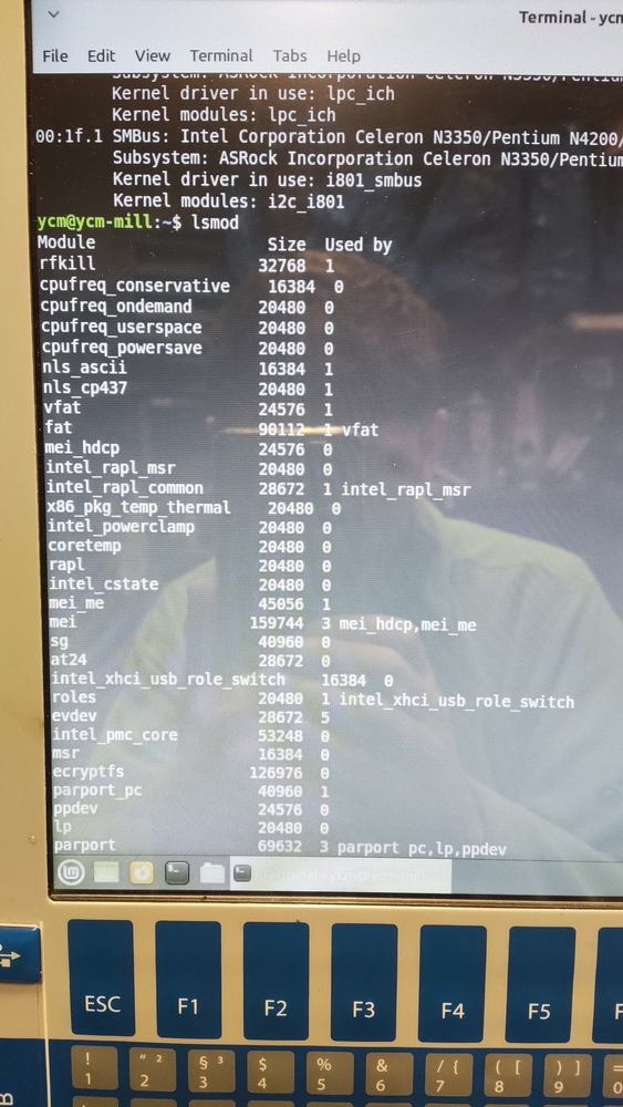

15 Jan 2023 09:55 - 15 Jan 2023 09:55 #262046 by Stanislavz
Commands result
Last edit: 15 Jan 2023 09:55 by Stanislavz.
15 Jan 2023 18:27 #262079 by NTULINUX
Replied by NTULINUX on topic Latency test
Thank you for that! So pretty standard stuff, any idea what you're using the AT24 EEPROM driver for?
RAID/LVM will not be included, I see this in your list. I will add BTRFS (also in your list) and F2FS support probably later, right now it's XFS and EXT4 only.

15 Jan 2023 23:46 #262099 by Stanislavz
Bios acces for uefi modifications ? Will try to find it.
Ok.
