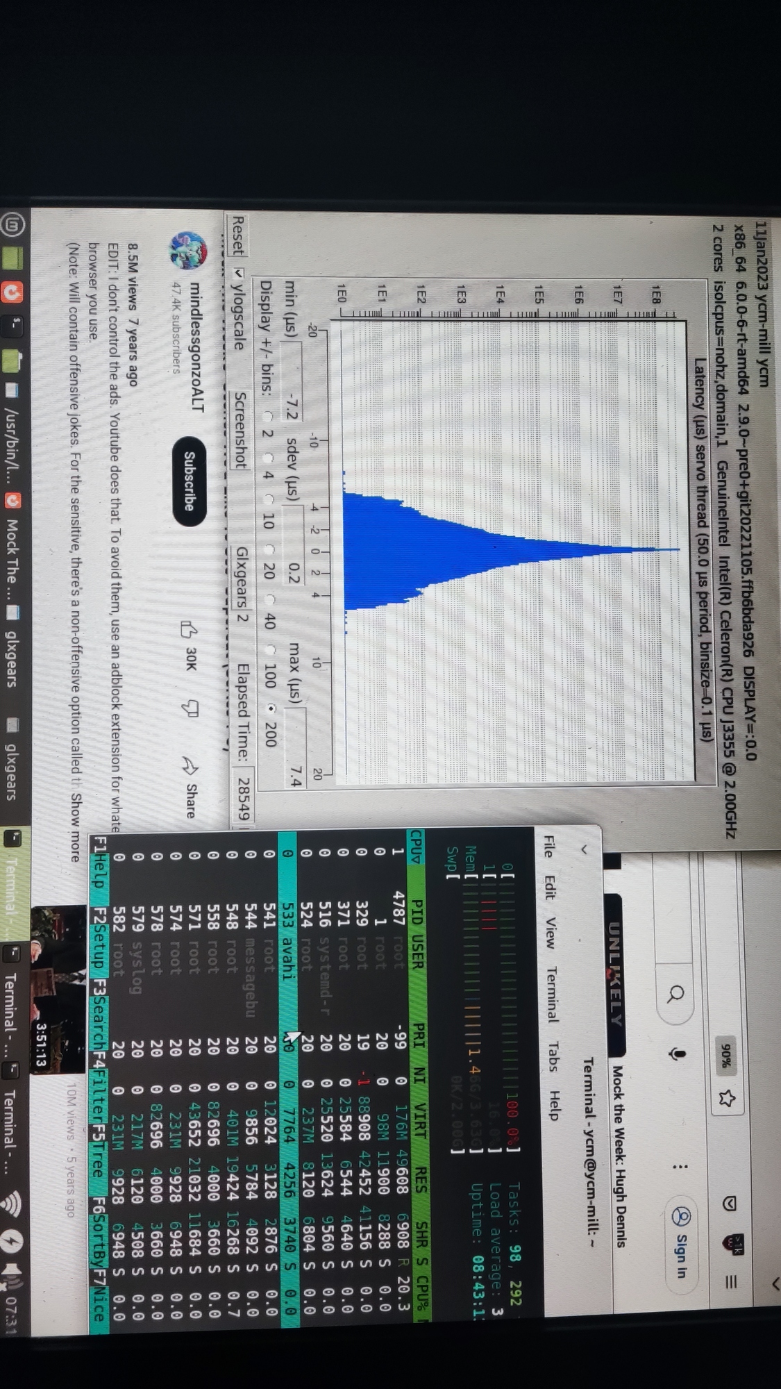

I just installed bookworm on an older ASRock H97M Pro4 with G3258 Pentium processor which used to have sub 10k latency but now on bookworm has pushed up to 76k. I would like to get it back down but most of what you guys have mentioned here is completely over my head. could you put a single page settings post with your best results for bookworm on 6.1 kernel? and if you don't mind could you put where the settings can be found? I am sure many would very much appreciate the testing and results you have found!Stanislavz post=261661 userid=33900
All night glxgears with youtube. But only one testing thread.. otherwise we have two processes on core optimised to run only one...
Thanks in advance!!
Chris

You could try to change the isolcpus=nohz,domain,1 to isolcpus=1
Or add nohz_full=1 or idle=poll
Especially adding nomodeset as Stanislav said helped a lot for me.
Also this helped a bit on mine system to get rid of some spikes.
Option "AccelMethod" "uxa"
In /etc/X11/xorg.conf.d/20-intel...
Or /etc/X11/xorg.conf
Like
Section "Device"
Identifier "Intel Graphics"
Driver "intel"
EndSection
You could also try to add these options:
Option "TearFree" "false"Option "TripleBuffer" "false"Option "SwapbuffersWait" "false"
Info from:
https://wiki.archlinux.org/title/intel_graphics#Enable_early_KMS
The intel related options including nomodeset could work when you see an increase in latency the moment you move a window across the screen or when you scroll on a YouTube page or something
