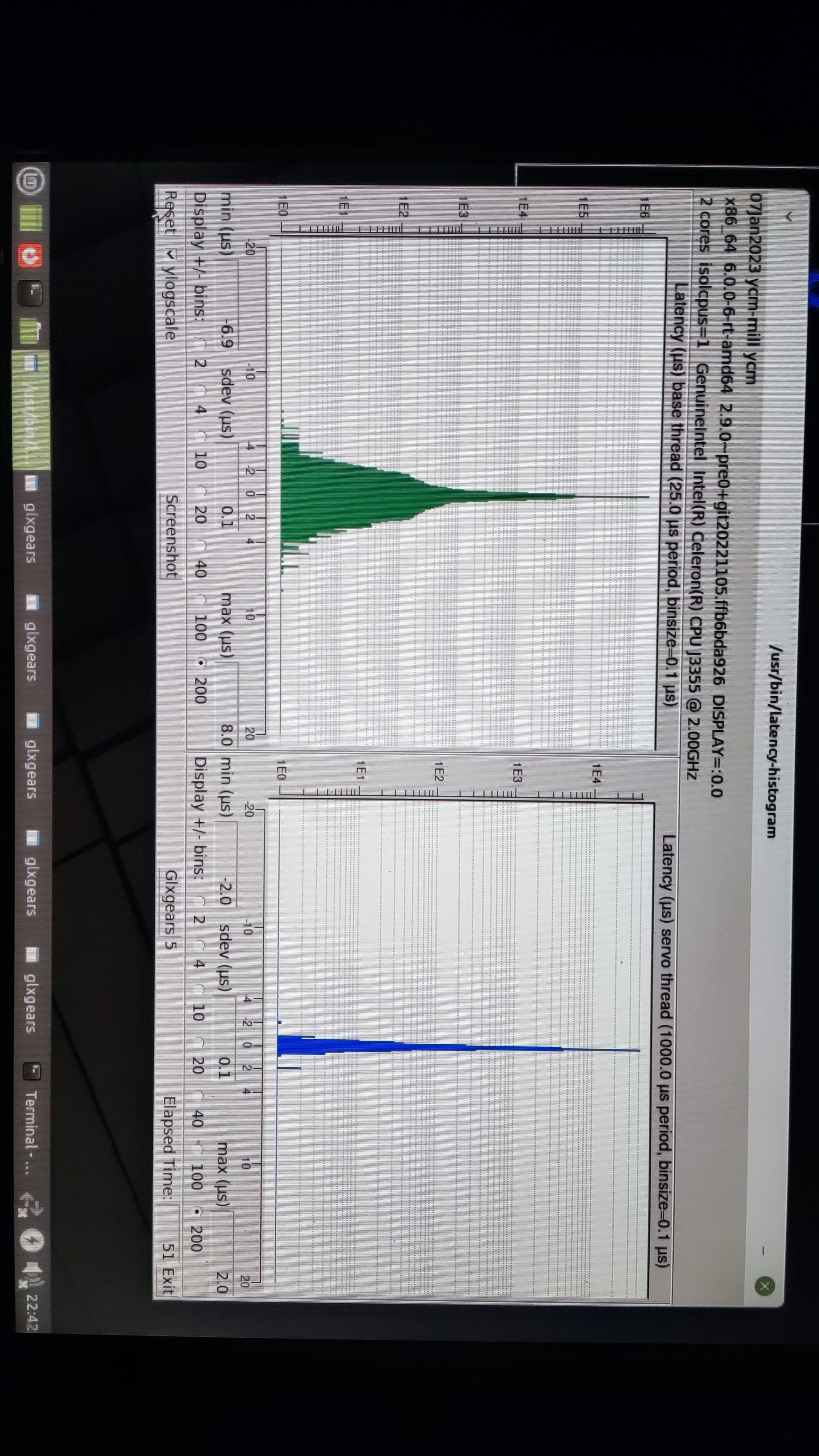

03 Jan 2023 07:48 #260840
by Stanislavz
Replied by Stanislavz on topic Latency test
Tried this today - 35-40k, no result on isolcpus or others params. Looks like its seem to much extra hardware or like. Did it hard way - bookworm clean install and apt getlinuxcnc. Or it was not very optimised/clean ?Did you upgrade to bookworm/testing or sid?

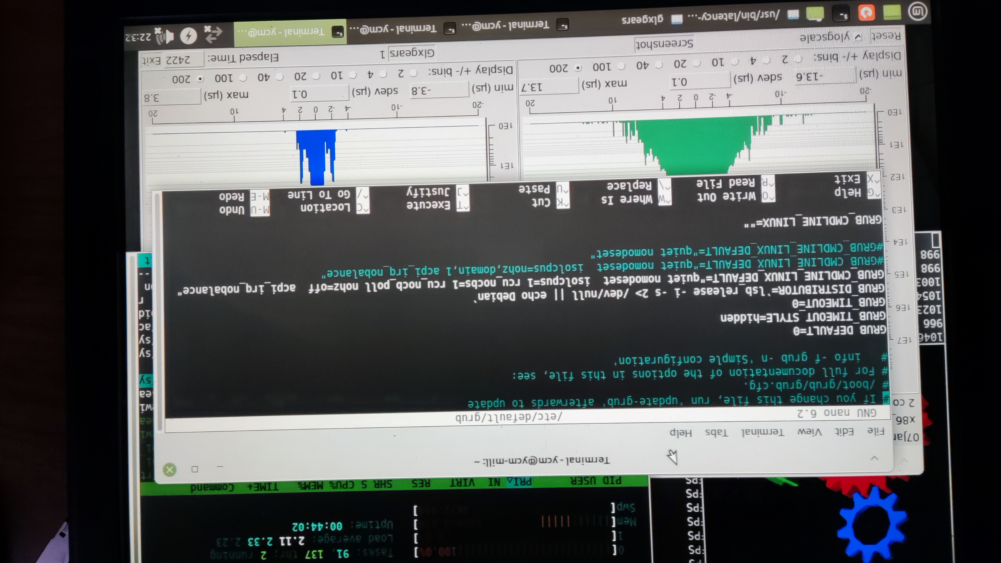

06 Jan 2023 10:07 - 06 Jan 2023 10:18 #261094
by Stanislavz
Ok.. Two day testing while doing other stuff.
Solved problem with bookworm - all that it needed was nomodeset to perform similar to buster. On uspace version.
Also - C states must be set in one place only - or in bios or in kernel paramteres. Then they give similar results. I have more then one setup to get 10-11K result by now. Goal was to find good solotion without idle=pull.
Today will try Mint version.

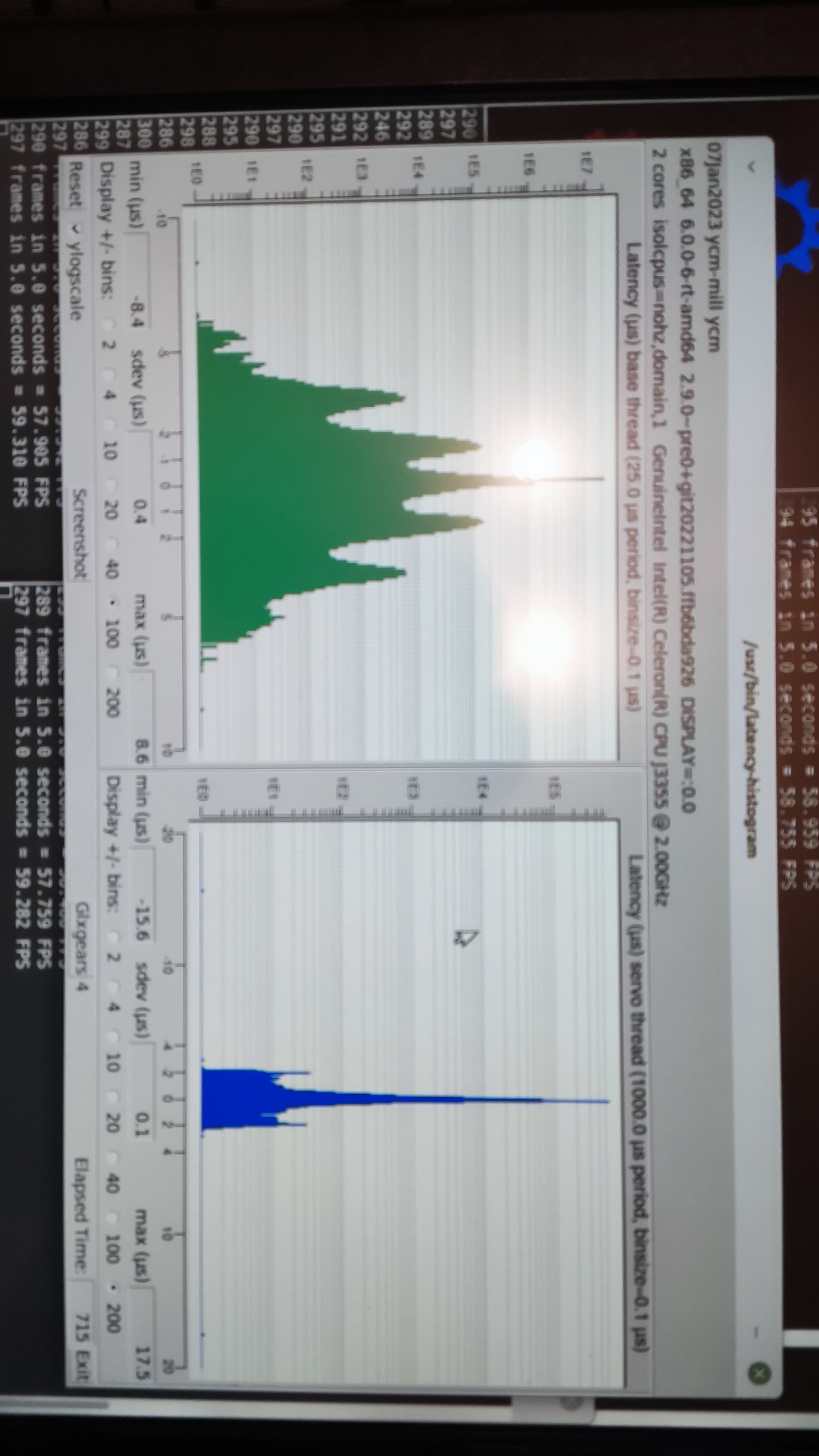

07 Jan 2023 15:27 #261202
by Stanislavz
Working on shape of graph. I do not like regularities, spikes - it shows that our cpu is not isolated or we have some processe running in a wrong time and place. It was wery uneven on Debian, much better on Mint.
After one zilion of tests and some manuals digging and nohz=off, rcb tune - i am getting two spike on both graph, if lightly loaded (cpu 0 have some spare time to do housekepping) latency is in 6-7k.
Load it harder - 10-12k.
Add some nasty things like putting new usb wifi, apt install, new firefox with yt - then system barely moves - it is in 16k region.

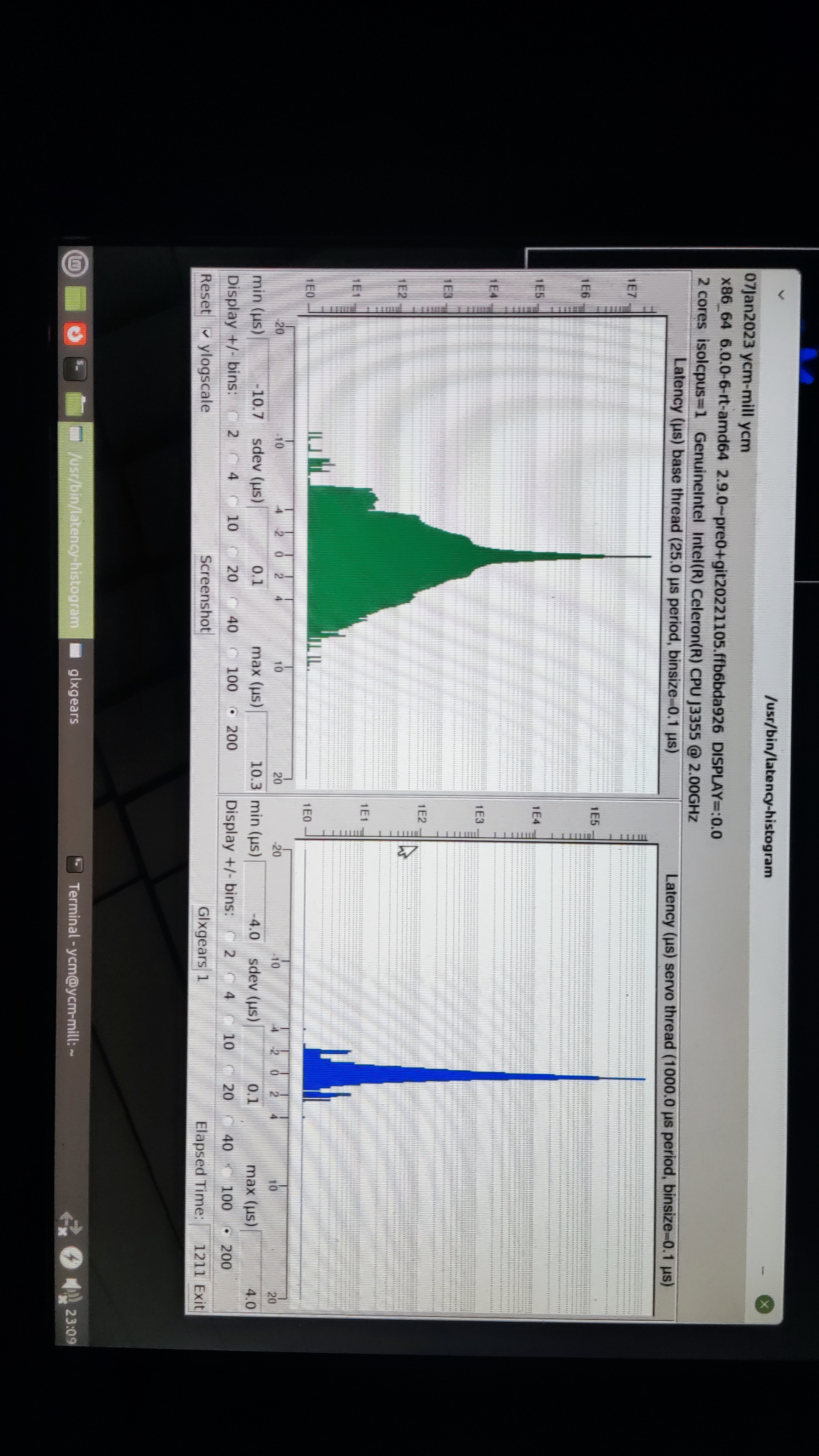

09 Jan 2023 05:23 #261344
by Stanislavz
"Last" bug found. I have noticed - one can get better latency on slightly loaded system. Its stays in 6K, as i have mentioned before. Sometimes even less.. But, after longer testing - it still climbs sometimes into 10 or 15k.
Problem was Cpu frequency. Even, after setting disable to Speed step technology - it only disable "turbo" - 2.5Ghz mode on cpu. Cores still tries to adapt to load. Normally it was like 1.5 GHz for core0 and 800MHz for core1 in idle state. On latency tests - both jumped to 2GHz. And system load was varied from 0 to 100 - latence was jumping as hell.
After long play with cpufreq-set - it was enought to set both cores to performance governor and it was all good with just isolcpus=1 in grub parameters. And - nohz settings or rbu settings - boosted core0 to 2GHz, but governor was still working and it tries to change frequency.

10 Jan 2023 03:19 #261429
by Stanislavz
One example on intel_pstate / intel_cpufreq drivers. From 5.7 linux kernel version - intel_pstate is by default in passive mode, getting commands from intel_cpufreq. If you your disable it - it go to some weird mode in new linuxes - it does not got any control signals from kernel. but it still try to use different C modes and it changes core voltage too.
Now if you disable other C modes except C1 - cpu ignore this setting and is using all of them. Again - could be a bug in a bios. But - setting is working if you change max C state. And no reaction on kernel setting.
On kernel 6.0 you need to add intel_pstate = active if you want to have direct control of cpu using intel_pstate controller. Also - you have to enable speed_step in bios.
So - now i am using testing following setups:
isolcpus=1, intel_pstate=active and setting governor=performance, max cpu frequency 2000000 . Bios C1, enabled speedstep.
isolcpus=1, intel_pstate=passive and setting governor=performance max cpu frequency 2000000. Bios C1, enabled speedstep.
isolcpus=1, intel_pstate=disable . Bios C1, disabled speedstep.
Cpu voltage is stable if performance mode set or disabled speedstep, C states goes from C0 to C1. Which is kind of normal. If intel_cpufreq is used - and governor is userspace and frequency is setted - it does not work.
All got ~ similar results. idle=poll just moves C1 to C0, and gives worse results.
And one need i7z package to get real cpu frequency. One need to watch cpu voltage - if it stable its not jumping frequency. C0 / C1 states can change, but not C3 or deeper.
