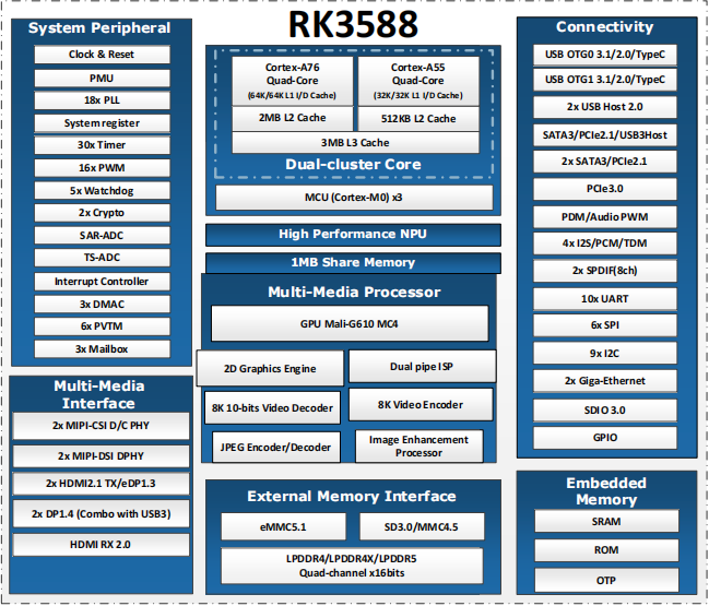

Product page: www.orangepi.org/html/hardWare/computerA...ils/Orange-Pi-5.html
Rockchip RK3588
Quad-core ARM Cortex-A76 MPCore processor and quad-core ARM Cortex-A55 MPCore processor
3x Cortex-M0 MCUs integrated (stepgen)
ARM Mali-G610 MP4 GPU
Links to RK3588 info and data sheets www.cnx-software.com/2021/12/16/rockchip...eet-sbc-coming-soon/

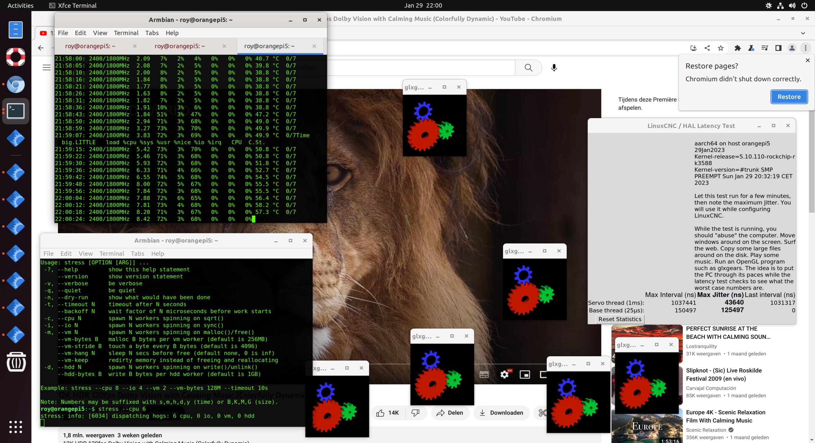

As said in the other topic I did an attempt to run it on Armbian, which is easy to configure/compile. Without extra boot parameters the latency became quick above a second, then I thought I'd patched the kernel (but got cleaned after) I tried with boot args: isolcpus=4-7 nohz=on nohz_full=4-7, and got with Wayland after running it half an hour watching YouTube and installing various things a max jitter of 100us.
After I realized that I didn't compile the patched kernel I've tried to compile with the preempt rt patches, but got an error. Also didn't I enable the full tick less option the first try, so a lot to improve/try. When I've got time I'll see if I could get most of the rt patches to work but I'm clearly no developer or anything.
The OPI5 with the 3x M0 MCU integrated and 6 pwm pins has a lot of potency with the right people working on it.

Did another test with the full dyntik enabled in the kernel but then the latency became worse, after I removed the nohz_full and nohz parameters it was around 80us but suddenly got a spike to 120us. Then I looked at the dtc and I saw that cpu 4 and 6 had an extra setting:
dynamic-power-coefficient = <0x12c>;
cpu-supply = <0x18>;
cpu 5 and 7 didn't had these, not sure what it means, but decided to try to only isolate cpu 5 and 7 and the result for the servo thread was better.
I can see that the arch_timer still has a lot of interrupts on cpu7, so next step would be to find a way to disable the timer on those 2.
The settings I'd used with this test:
Kernel set on preempt desktop rt in kernel menu config, no patches yet
in armbian-config set the governor on performance , min and max @ 2400mhz but somehow armbianmonitor says 2400/1800mhz
Boot arg: isolcpus=5,7
Opened some glxgears and 4k youtube video and cpu stress on 6 cpu's
Kernel I compiled:
easyupload.io/q0xrfl
Kernel I compiled:

Just FYI: The servo thread is the one of interest for use with Mesa over Ethernet, not the base thread. The same is true with Remora using SPI to connect to an external microcontroller. I believe the RK3588 has three (3) integrated Cortex M0 micros but I don't think that the register specs to connect to them is in the public or leaked docs.
u-boot should be configured to be at one set core frequency. It should not be jumping between core speeds as this causes latency jitter. The system gets halted for at least several hundred core clock cycles while it waits for the clock speed to stabilize and this shows up as a latency spike.

I've read about the base thread not being used for Mesa, I've included that one to see if it might even be usable for software stepping for as long as the MCU's are not in use.
I thought that setting the governor at performance would prevent it from scaling, but that's not enough?
The arch timer had also some interrupts at cpu 5 so perhaps if that one will be disabled on the isolated cpus the latency will improve, not sure yet how to implement that. Here it's explained how to do it on another SBC: community.nxp.com/t5/QorIQ/How-to-move-o...nterrupt/m-p/1046574
The legacy kernel is btw 5.10.110 and only found a rt patch for 5.10.109 was hoping it was close enough. That might be the reason it will not compile with these patches.
