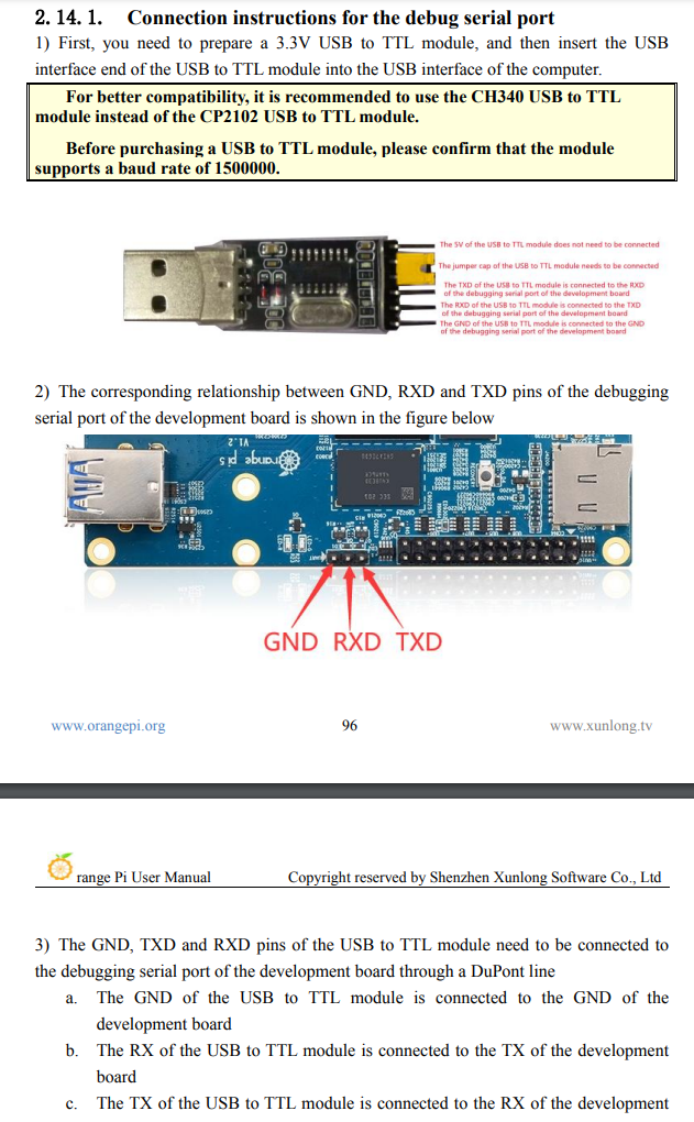

It seems you did the steps in the right order, no other steps should be required. To see what happens in the bootloader, the output on the uart pins is very helpful.
I'll see if I could reproduce the same error.
Since hw video decoding doesn't work with the packages from the jammy repo with the mali blob, I'll see if Debian Bookworm will work like rodw suggested.
