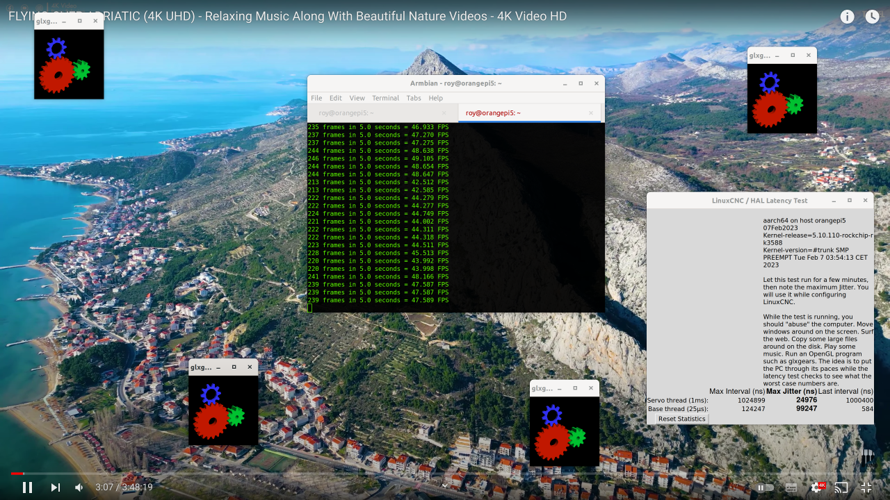

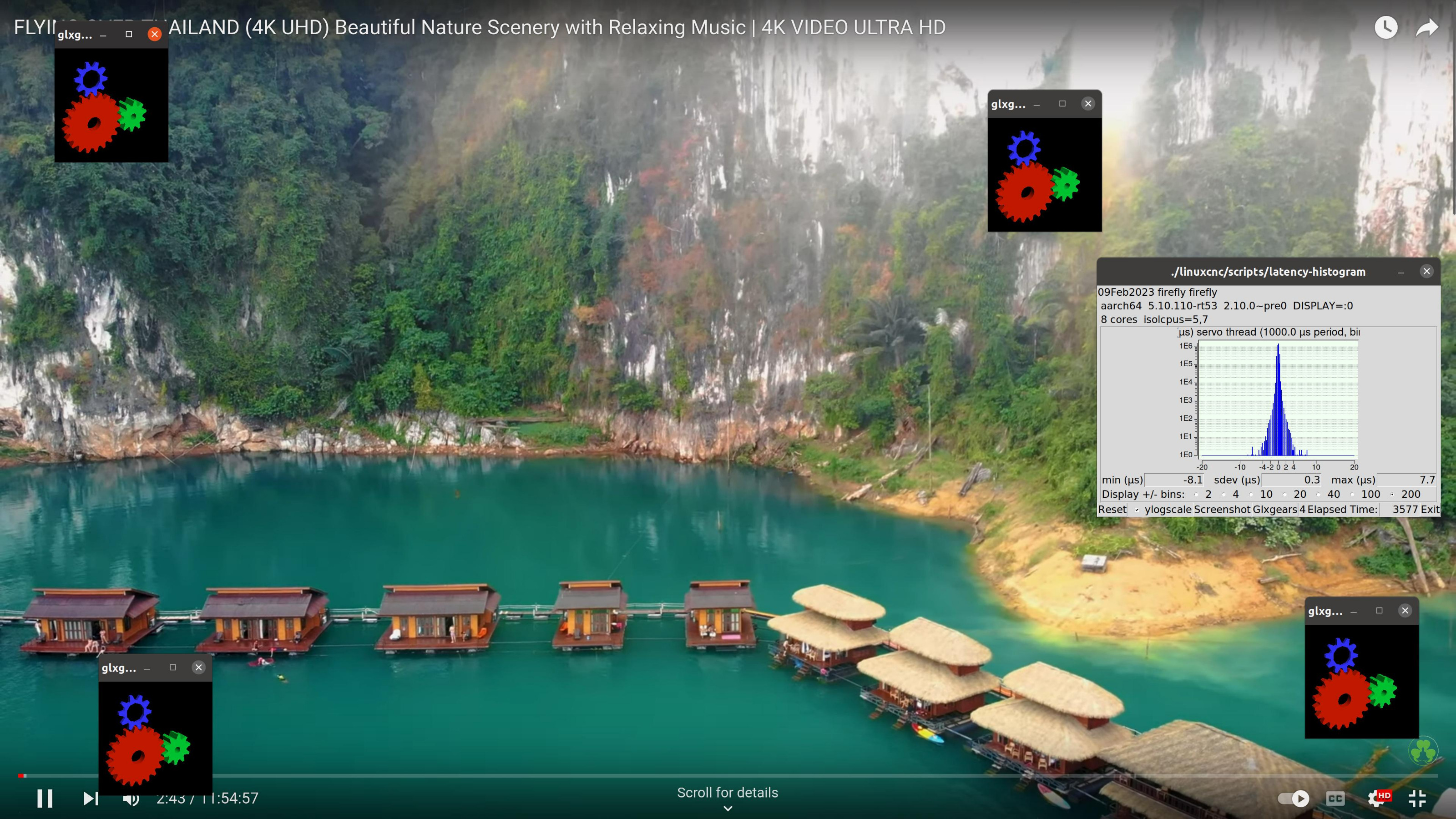

After applying an overlay to overclock the big cores to 2.4ghz the max jitter of the servo thread is 25us with 4x glxgears and playing 4k YouTube.I've added a screenshot and the compiled overlay from
a patch of github
Boot parameter: isolcpus=5,7
If someone is getting more jitter with this overlay I could upload my kernel (settings).
Too bad, just before I'd finished this message the max jitter went to 54us (after about 45min running) Need to say that I've running tvheadend with an USB dvb tuner and zigbee2mqtt in the background as well.
Arch timer interrupts a lot on cpu7, but there is also a rk timer which avoids cpu 5 and 7 as it should.
Could the rk timer function as a replacement of arch timer?

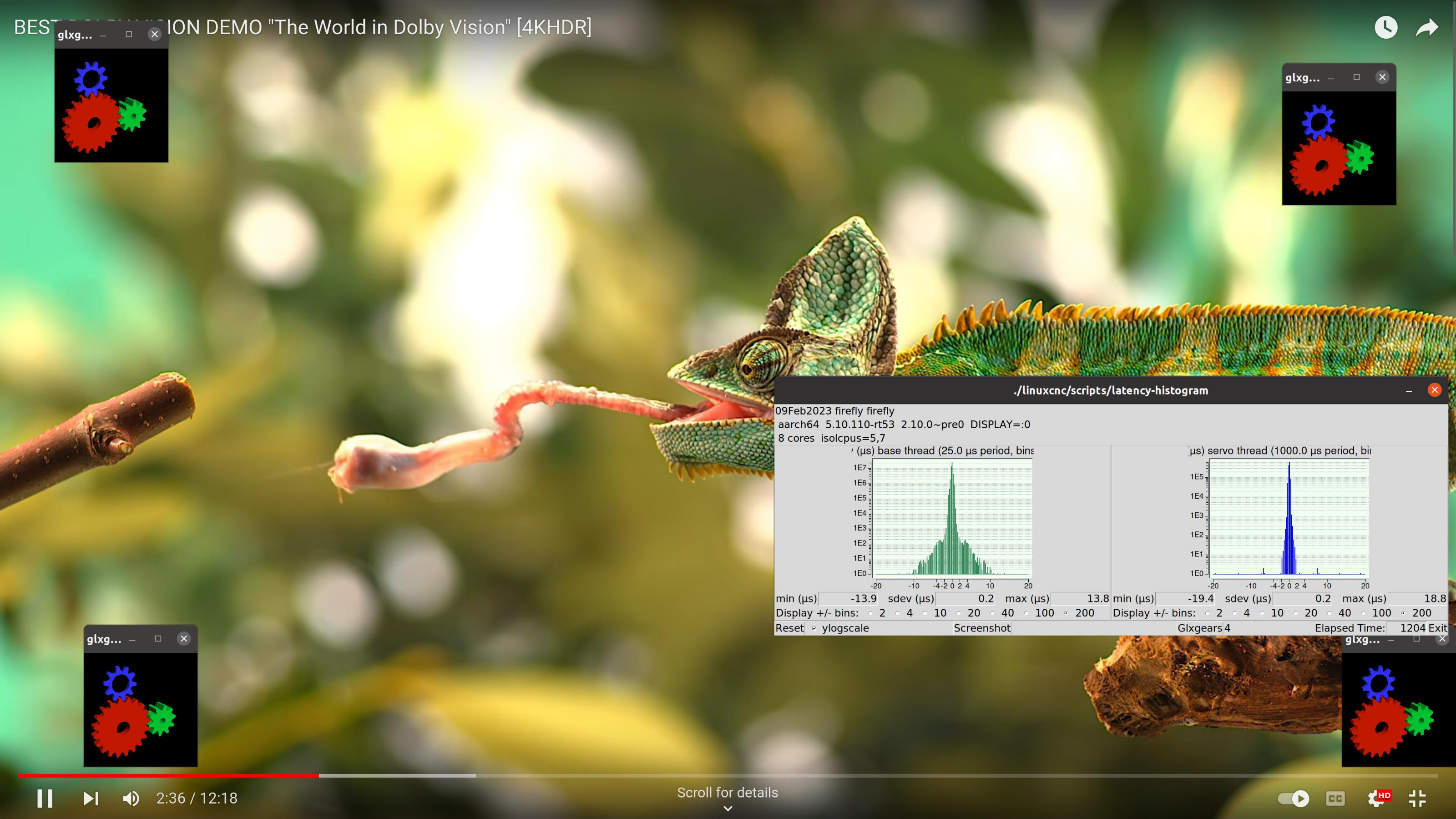

Found a Preempt_RT image, but had to change the bootloader. Unfortunately no source code available. But it works great. After about an hour a max jitter of 8.1us, assuming the biggest number is the max jitter (-8.1). Either way for Mesa/Remora this is perfect.
The base-thread is still going up to 100us somehow, so it's not good for software stepping yet. I've isolated 2 cores and only 1 core is getting used, so I assume the base thread is on the same core as the servo thread? What could be the reason for the the base thread latency getting so high? Would it be possible to make that a separate process on the second (first) isolated core?
Correction, actually not bad at all, didn't test the base-thread after my last change in the boot parameters. Now has max jitter of 13.9us on base and 19.4us on the thread after a quick test of 20min, I expect it stays stable since it also did with only the servo thread for an hour.
Since the image is meant for another board and I had to install another bootloader to make it work on the OPI5, is it allowed to post an image or howto, if there is any interest?

The base thread is actually not bad at all, at the moment running the test for 45min and still 13.9us on the base thread and 19.4us on the servo thread. So even software stepping is possible.
I've seen on the website of the manufacturer a page about the rt kernel that they mention to use the mcu's when you need even less latency, but that's all the information they give.
Maybe I will look at the MCU later if it's easy to port/copy to this board. Actually just bought a micro desktop for LinuxCNC which work well, although not as good as the OPI5.
