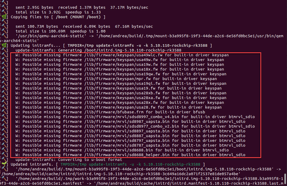

- Guglielmi
- Posts: 78
- Thank you received: 17
20 Apr 2023 15:14 #269507
by Guglielmi
Replied by Guglielmi on topic Can the OPI5 be Configured to Run LCNC?
Hello guys, after 9 tentatives, I'm exaclty in the same situation of Kanuboy13b!
Tentatives because for 3-4 days the main branch was (in my opinion corrupted, the second menu was not working moving arrows I saw on the screen symbols like ">[OB" instead going down through menu.
After some days doing exactly the same sequence of command, cloning the same repo, finally it works.
Now I have for the second time a ISO perfectly generated but red led, no boot.
Well.. I don't get the issue of dtb, in the boot partition I have 2 folders:
D:\dtb\rockchip
D:\dtb-5.10.110-rockchip-rk3588\rockchip
both full of dtb files.. what happens?
Do you mean something else?
What I have do to precisely? replace one of these folder with other dtb files? where I have to pick them?
I will try to build again based on Debian and see what happen, following Royka suggestions.
This job it much more strong than expected.
D:\dtb\rockchip
- Guglielmi
- Posts: 78
20 Apr 2023 15:19 - 20 Apr 2023 15:20 #269508
by Guglielmi
In previous build, in final step, I saw attached warnings.
Could be critical?
Could be critical?
Last edit: 20 Apr 2023 15:20 by Guglielmi.

20 Apr 2023 15:29 - 20 Apr 2023 15:31 #269512
by kanuboy13b
Replied by kanuboy13b on topic Can the OPI5 be Configured to Run LCNC?
royka has provided the dtb file in his latest zip, you need one that is specific to the orange pi for it to boot.
what I did was mount the boot partition and copy the dtb file in the location where all the dtb files are located. If you " ls -la" the /boot/dtb/rockchip directory prior to copying you'll notice there isn't one with the the orange pi 5 in the name. Hence why it isn't booting.
Once I copied the dtb file from royka's zip file to the boot partition, I was able to boot.
