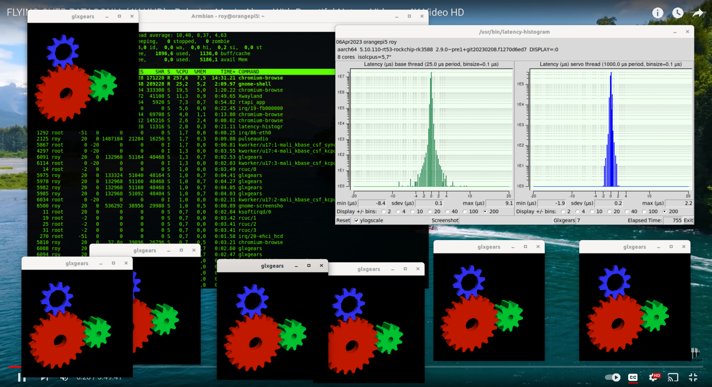

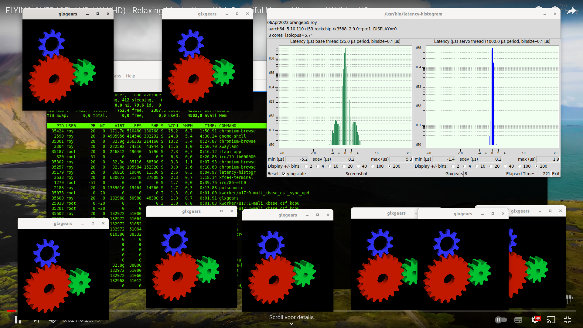

05 Apr 2023 23:08 #268360
by royka
Replied by royka on topic Can the OPI5 be Configured to Run LCNC?
A quick test, without full hw video decoding yet, but 1080p does work fine.
Or the results are really this good or if hung, although the timer still worked. Need to do some more testing.

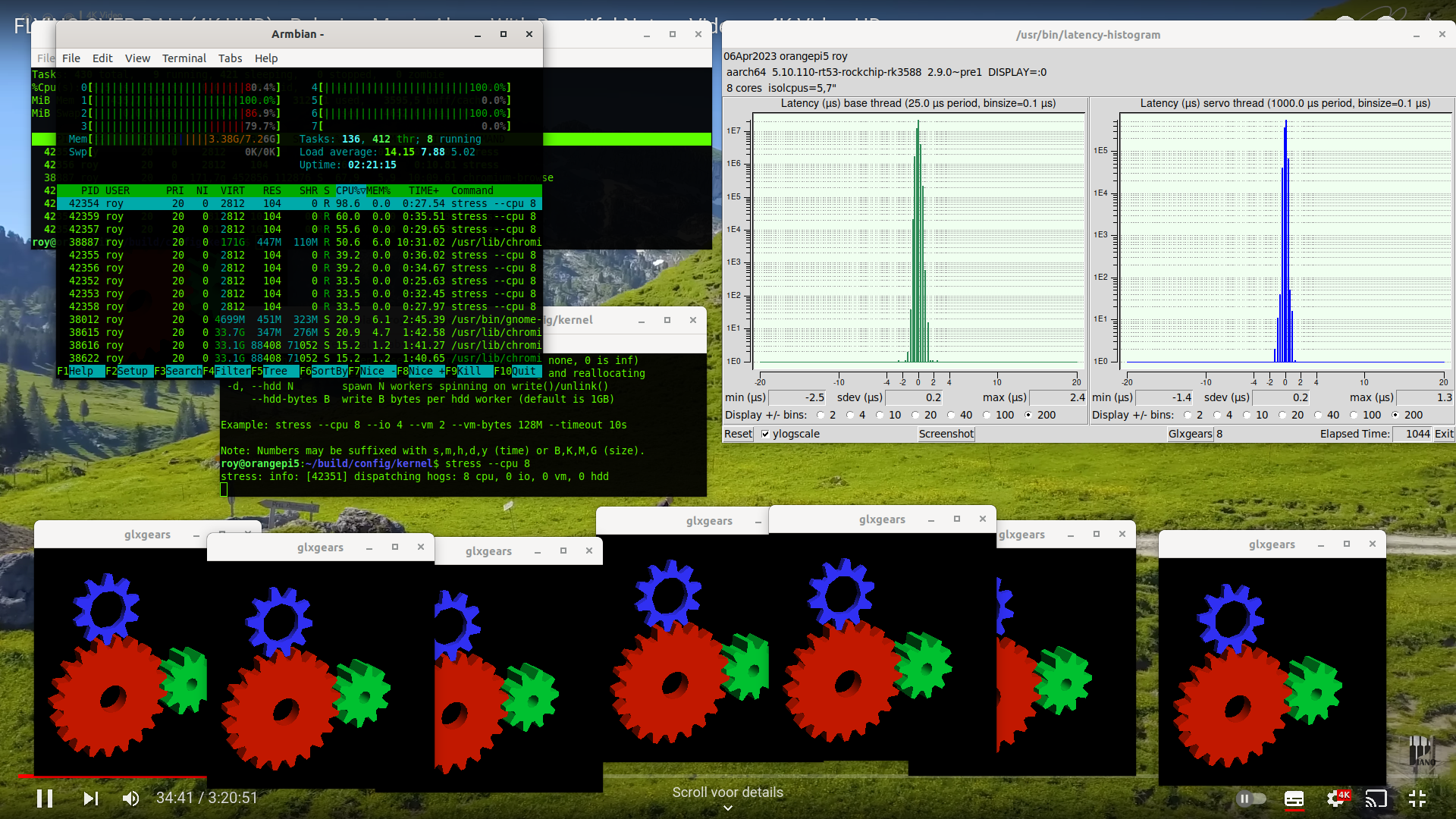

06 Apr 2023 13:27 #268426
by royka
With my previous test I did a dirty install of the debian packages and had to force install some packages. Now I've removed these and compiled LinuxCNC and it really does work as well as it seemed to be. So it's actually pretty easy to build your own image/kernel with Armbian, you only need to change the kernel config and source, after that you could build it as usually.
If you don't know how to do this yourself I will make an image, but it shall help yourself to make your own so you'll always be able to update and customize it the way you want. I don't recommend to adjust any timer/scheduler related things, adding drivers should be ok, although a bad driver (in use) could increase latency.
The screenshot was while playing a 4k youtube video, 8x glxgears and "stress --cpu8". cpu stress did improve the latency, so made another without.
Till now the only thing it doesn't like is playing a youtube video in the background, but who wants this while machining. It eventually will freeze the video and this also raised the latency up to 30us. This freezing is something I saw with other images too, should be a driver issue. Besides that, you could do about anything without getting latency.
