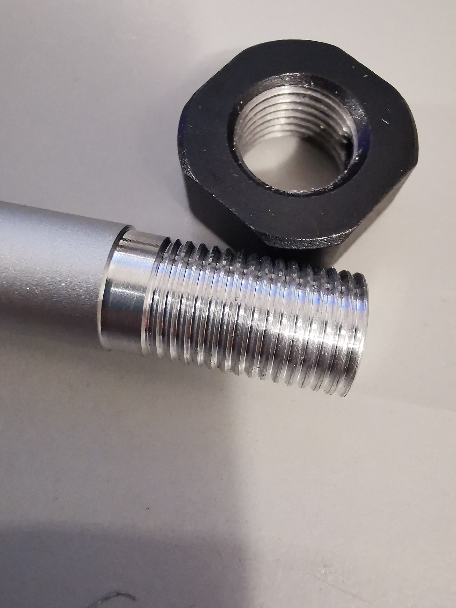

31 Jan 2024 19:06 #292095 by meister
M10x1 on my cnc conversion (HG125 C0 lathe) with 3D printed parts
works :)

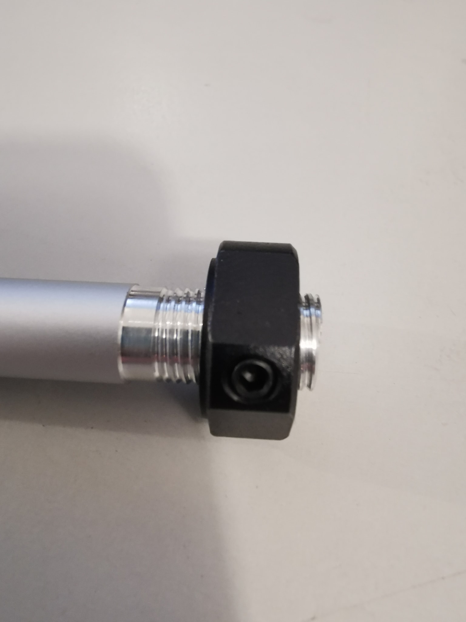

31 Jan 2024 19:22 #292097 by meister
I'm soooo happy :)
