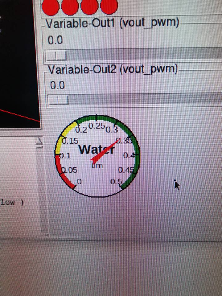

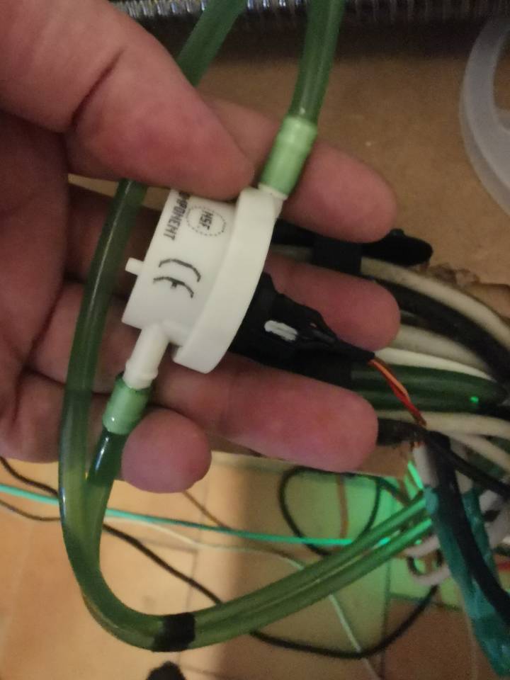

little sensor example with RIO :
I have add a Water-Flow Sensor to my CNC:
config looks like this:
"type": "vin_frequency",
"name": "flow",
"scale": 0.033,
"display": {
"type": "meter",
"text": "Water",
"subtext": "l/m",
"min": 0,
"max": 0.5,
"region": [
[0.2, 0.5, "green"],
[0.1, 0.2, "yellow"],
[0, 0.1, "red"]
"debounce": true,
"pin": "33",
"pullup": true,
"freq_min": 2
},Attachments:
