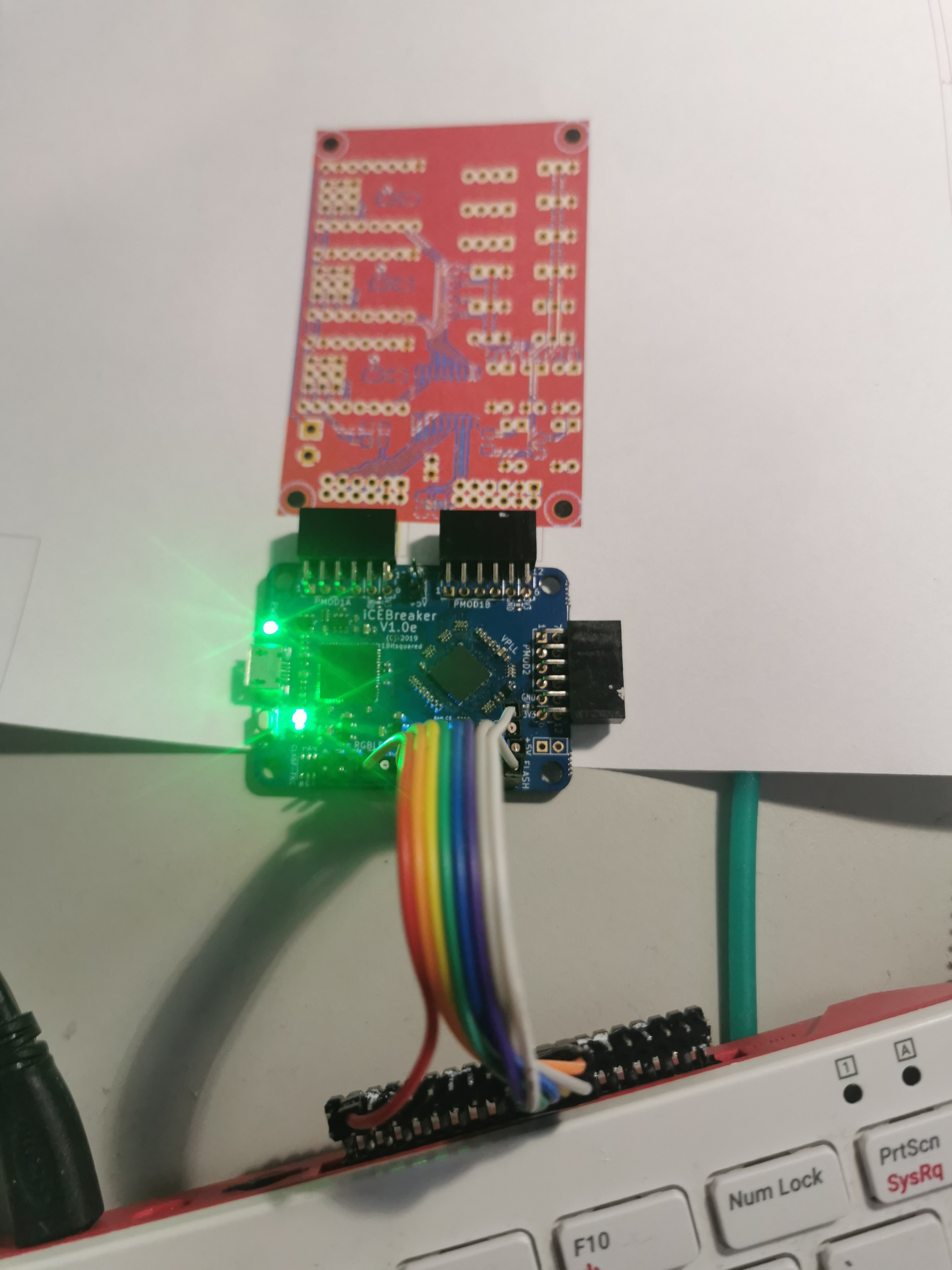

Initial success with the Spartan 6. Yippee
Many Thanks !
Many Thanks !

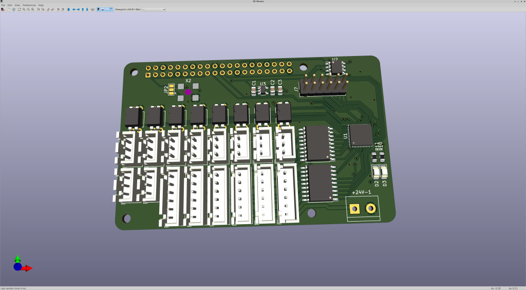

my 3 first Kicad projects:
github.com/multigcs/rio-icebreaker3x
github.com/multigcs/rio-octobot
github.com/multigcs/rio-iceshield
hope it works
hope it works

Replied by Cant do this anymore bye all on topic LinuxCNC-RIO - RealtimeIO for LinuxCNC based on FPGA (ICE40 / ECP5)
Finally got it running without latency errors when coming out of estop. Finally get to use the RPi5.
Tho I can not rule out my messy SPI wiring from the FPGA to the WT32-ETH01.
Still have to have a try with a W5500 module.

Not sure how this effects RIO, but with the remora w5500 one, the wires were crucial to be as short as possible, but also something ground loop was important even with short wires. jiggling the cables effected it a lot more than I expected.
Replied by cakeslob on topic LinuxCNC-RIO - RealtimeIO for LinuxCNC based on FPGA (ICE40 / ECP5)

When I was working with the Mesa firmware when using SPI wiring from the Pi to the dev board needed to be good. On the design of the board for SPI interface I designed to have a gnd between every signal. Since I’m using a different dev board I’m being a bit, okay really, lazy.
Considering a slight redesign of the board that brings out 3.3v and 5v on the connector that has the spi connector. That of course will be future Rob’s decision.
