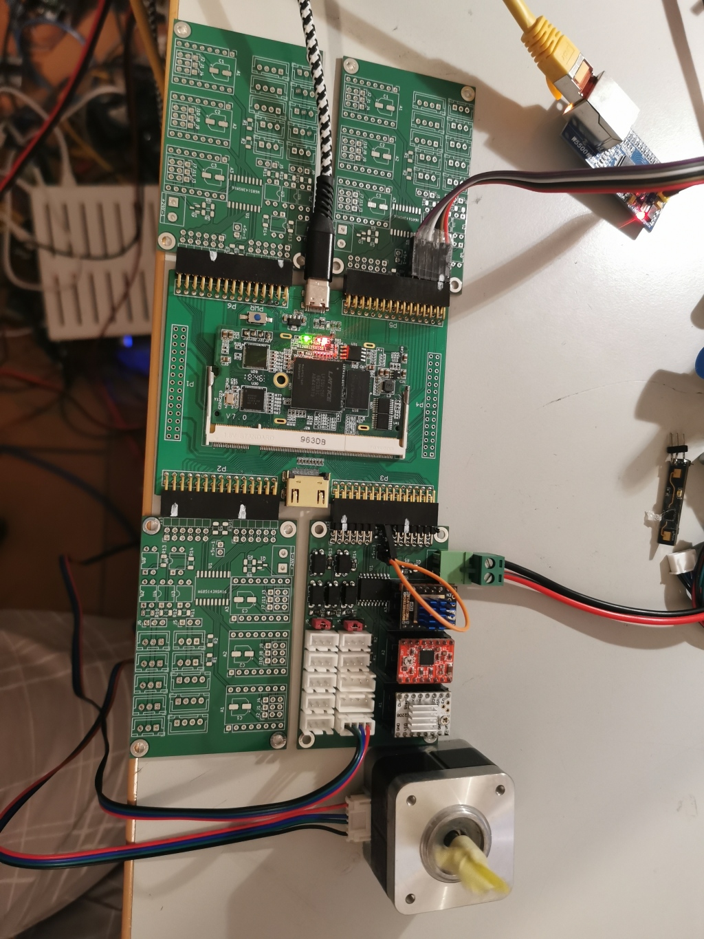

Replied by meister on topic LinuxCNC-RIO - RealtimeIO for LinuxCNC based on FPGA (ICE40 / ECP5)

11 Jul 2024 23:48 #304950
Replied by tommylight on topic LinuxCNC-RIO - RealtimeIO for LinuxCNC based on FPGA (ICE40 / ECP5)
Last picture, a CPU, a HDMI port, DRAM.... how close is that to running LinuxCNC on it completely ?
Thinking of it, what are the chances of compiling an RT kernel for Porteus Linux? That is the ONLY really lite fully featured Linux out there, and it has a KIOSK mode already.... Oh hell, time...
It does run perfectly with 1GB or RAM, tested, probably will be fine with 512MB, and that is the "embedded CPU" territory.

12 Jul 2024 01:21 #304953
Replied by Cant do this anymore bye all on topic LinuxCNC-RIO - RealtimeIO for LinuxCNC based on FPGA (ICE40 / ECP5)
That's just a colorlight board on a SODIMM based on a lattice FPGA, I have a similar module but with a Spartan 6 FPGA. The ram is 8mb.
The litex project has a couple of examples with a riscv CPU, but probably not up to running Linuxcnx full on.
Now the board that would be great is the Beagle Bone Black if it had say 4gb ram and a faster processor whilst still keeping the PRU for step gen and such.

13 Jul 2024 17:11 #305096
by fest
Replied by fest on topic LinuxCNC-RIO - RealtimeIO for LinuxCNC based on FPGA (ICE40 / ECP5)
The only useful thing on that module for this purpose is Ethernet PHYs. But even then, I don't think implementing an Ethernet core is worth the effort, considering W5500 and UDP2SPI bridges already (kinda) work.
