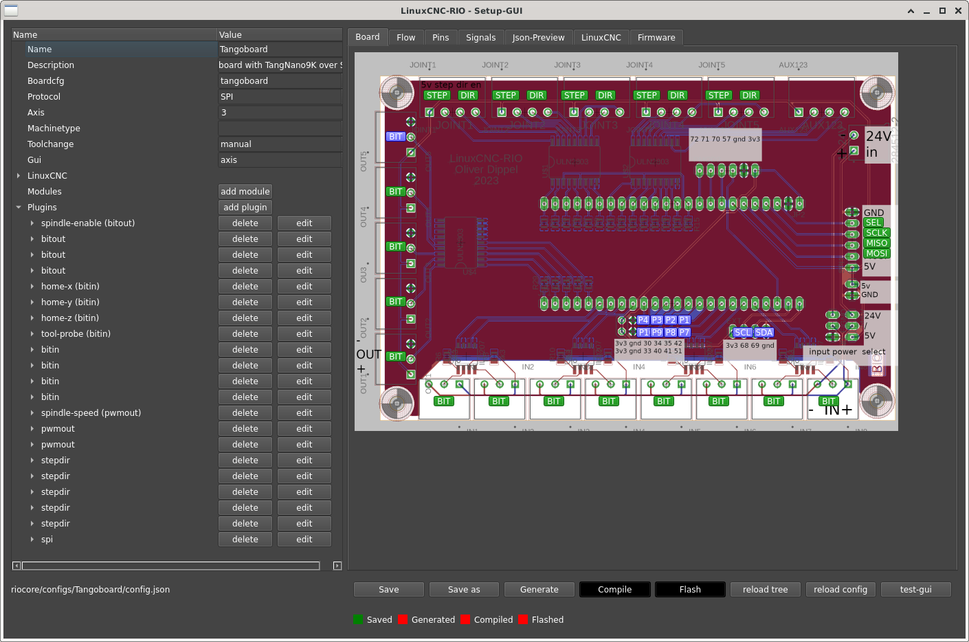

@meister
Do you happen to have LinuxCNC-RIO ported for the Gowin IDE? I'd like to explore your awesome work however would be willing to do so in an environment that I'm semi-familiar with already (i.e. Gowin IDE).
If so can you link me to a branch or point me in the correct direction to get started please. That'd be super cool.
ps. Goal; retrofit a co2 laser (stepper 3ax, 1 rot, 3 limit switches). Hardware at hand; gowin littlebee serie fpga
- meister
- Posts: 805
- Thank you received: 502
31 Jul 2024 10:51 #306491
by meister
However, it is easier (at least for me) to work without an IDE, so you are not so tied to one manufacturer.
Since everything is more or less generated here, an IDE is only suitable for troubleshooting and playing around
for new projects, the best branch is here:
github.com/multigcs/riocore/tree/dev
littlebee is not yet directly supported, but if there is a GW1N-9 on it, it should be no problem to use the TangNano9k configs as a template
copy the file: riocore/boards/TangNano9K.json to riocore/boards/LittleBee.json and edit it (type/family/clock-pin/speed), set toolchain to gowin
than copy riocore/configs/TangNano9K/config-uart.json to riocore/configs/LittleBee/config-uart.json and edit it (boardcfg and the pins / you can also remove all plugins and leave only the uart and blink for first tests)
then you can generate the Gateware with:
clear ; PYTHONPATH=. bin/rio-generator riocore/configs/LittleBee/config-uart.json
if all works, you will find a project file for gowin-ide here: Output/LittleBee/Gateware/rio.gprj
Replied by meister on topic LinuxCNC-RIO - RealtimeIO for LinuxCNC based on FPGA (ICE40 / ECP5)
