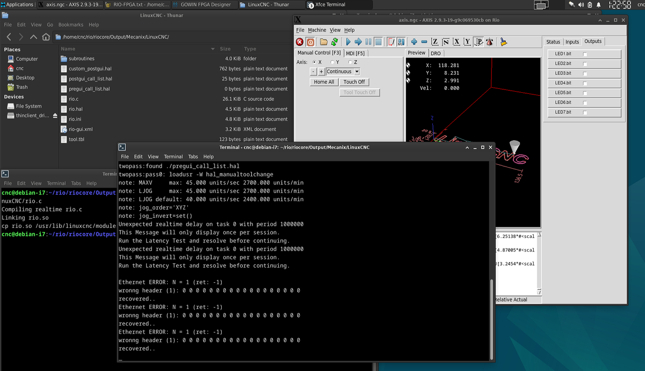

01 Aug 2024 17:34 #306642
by Mecanix
Replied by Mecanix on topic LinuxCNC-RIO - RealtimeIO for LinuxCNC based on FPGA (ICE40 / ECP5)
@meister
Late on and I got it to work. However and as you've pointed out, the comm needs fine tuning! Can I bother you once more and ask for a detailed hardware desc for the ESP32 you've mentioned? Is there a UDP module in particular you'd like us to use and dev around? I'm also happy to get a RMII breakerboard as a second option. Both would be ideal though. All-in-all it's working well. Congrats!!
Visual of the w5500 output:
