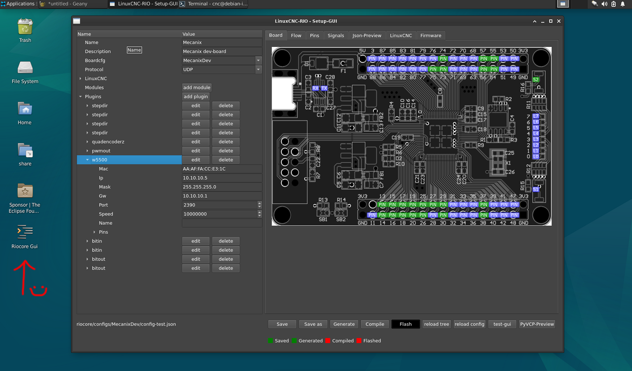

Finally got my Riocore Gui desktop icon working. No more cmd/cli endless keyboard input required. Just double click desktop ico, change stuff, save, generate!!
Change Exec= /to your paths/, save file on your desktop as type "Riocore Gui.desktop"
[Desktop Entry]
Name=Riocore Gui
Comment=Riocore Gui
Exec=bash -i -c "cd ~/rio/riocore; source ~/rio/riocore/bin/activate; PYTHONPATH=. bin/rio-setup riocore/configs/MecanixDev/config-test.json"
Icon=format-indent-less-rtl
Type=Application
Path=
Terminal=false
StartupNotify=falsePlease Log in or Create an account to join the conversation.
