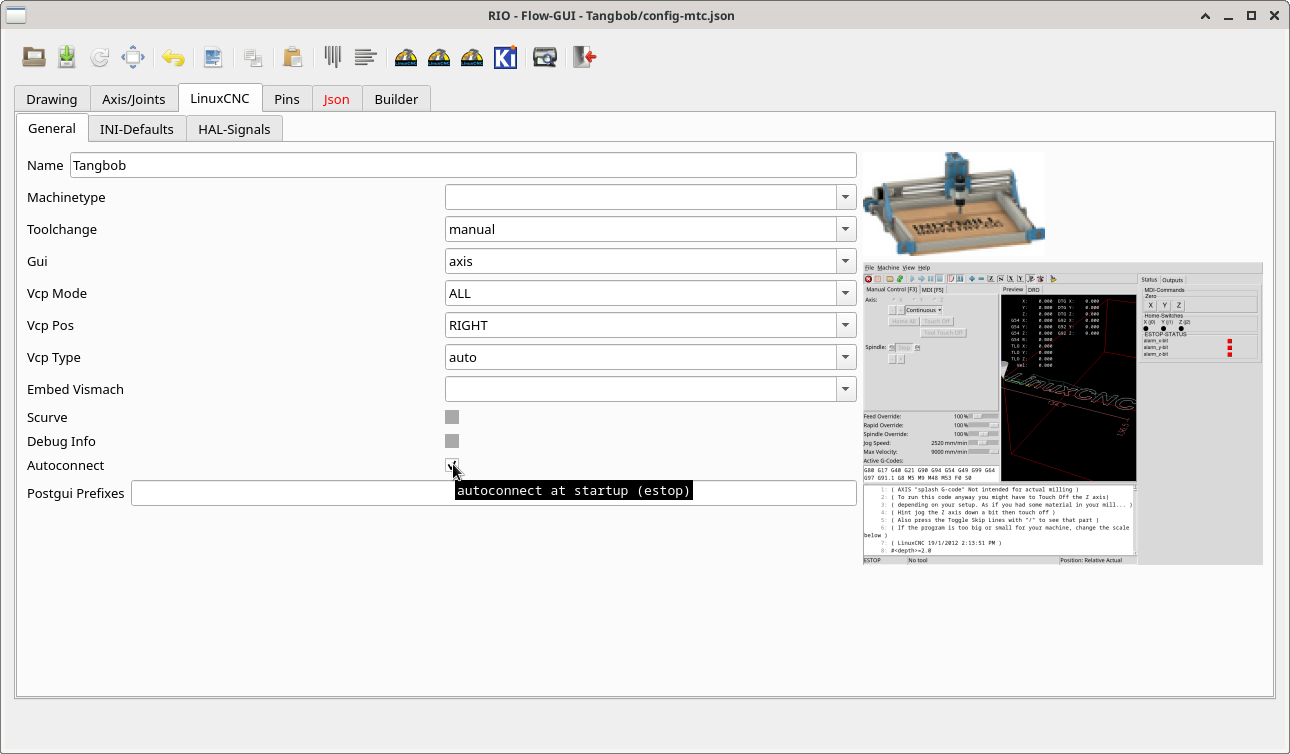

Hi, ok, i understand what you mean, this is 'work as designed', little bit different to mesa :)
but i will check how to connect directly on startup.
20 Aug 2026 11:16 #348875 by meister
@Oxbown
I’ve added an option for AutoConnect,
but I haven’t been able to test it properly yet; at least it’s already working in the simulator (dev branch)
The following user(s) said Thank You: Oxbown
20 Aug 2026 11:54 #348876 by Oxbown
Just updated to the dev branch and tested the new feature with the Tang Nano 9K: it works perfectly!
The board now starts communicating and reading inputs immediately as soon as LinuxCNC launches, completely solving the startup issue.
Huge thanks for implementing this so quickly and for being so attentive and responsive. Really appreciate your support!
