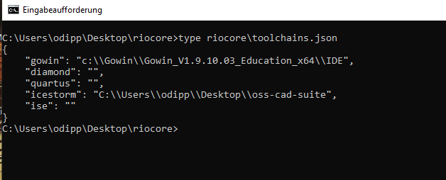

- MirkoCNC
- Posts: 19
09 Dec 2024 13:15 #316330
by MirkoCNC
Replied by MirkoCNC on topic LinuxCNC-RIO - RealtimeIO for LinuxCNC based on FPGA (ICE40 / ECP5)
I pulled the dev branch.
It creates the toolchains.json file and I added:
"gowin": "C:\\Gowin\\Gowin_V1.9.10.03_Education_x64\\IDE",
"diamond": "",
"vivado": "",
"quartus": "",
"icestorm": "",
"ise": ""
However, it does not compile. It gives me following error:
Der Befehl "make" ist entweder falsch geschrieben oder
konnte nicht gefunden werden.
Furthermore, the graphic in the tab Overview is completely gone.
"diamond": "",
"vivado": "",
"quartus": "",
"icestorm": "",
"ise": ""
