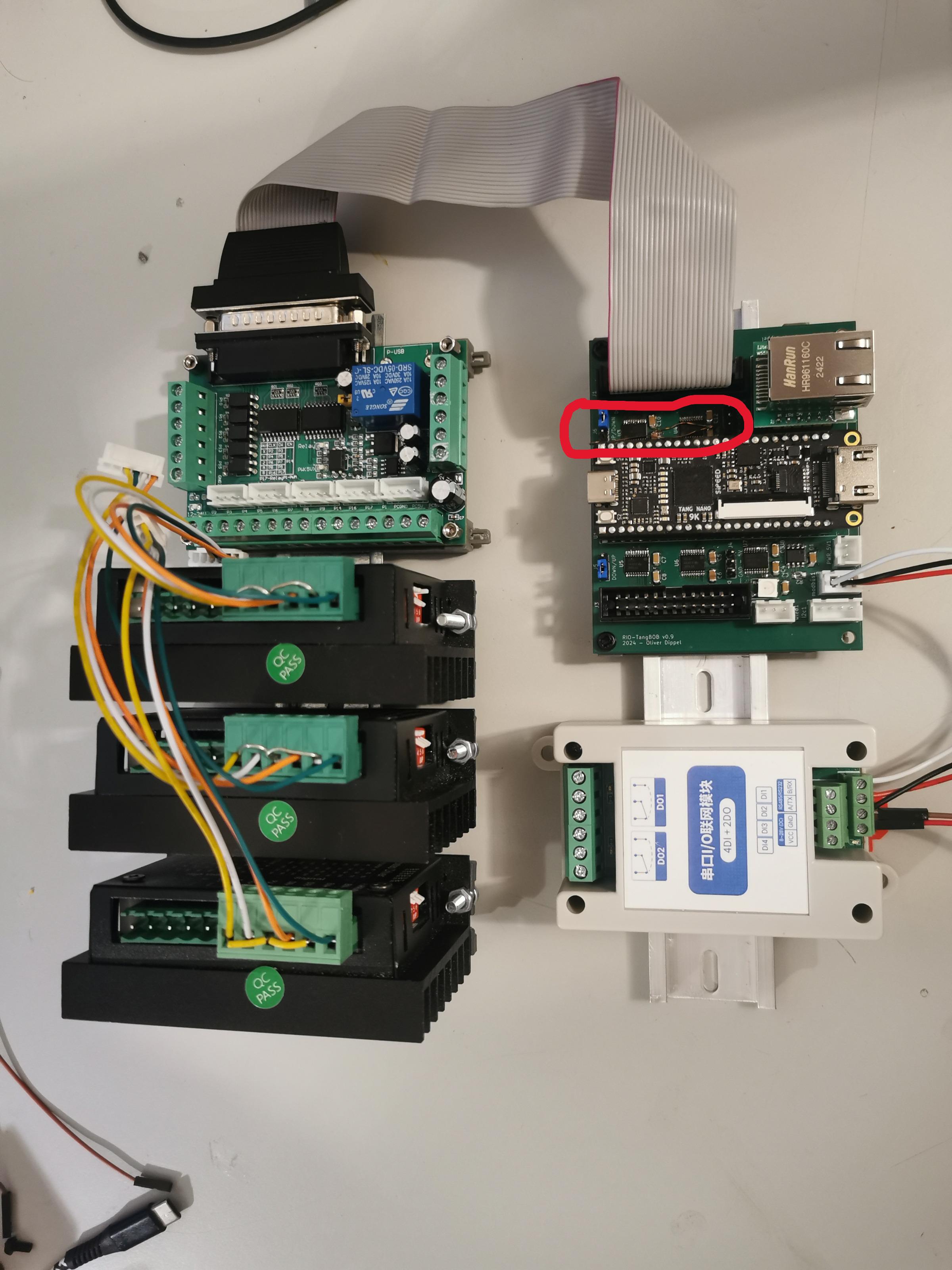

by kzali
Replied by kzali on topic LinuxCNC-RIO - RealtimeIO for LinuxCNC based on FPGA (ICE40 / ECP5)
What is the mod as marked in the attached photo?

15 Dec 2024 09:07 #316694
by meister
Replied by meister on topic LinuxCNC-RIO - RealtimeIO for LinuxCNC based on FPGA (ICE40 / ECP5)
what exactly do you mean?What happened with enable and error hardware implementation in riocore?

15 Dec 2024 09:10 #316695
by meister
it lowers the voltage of the level shifters on the FPGA side to cope with the 1.8V on certain ports, is fixed in the current git for the boardWhat is the mod as marked in the attached photo?
