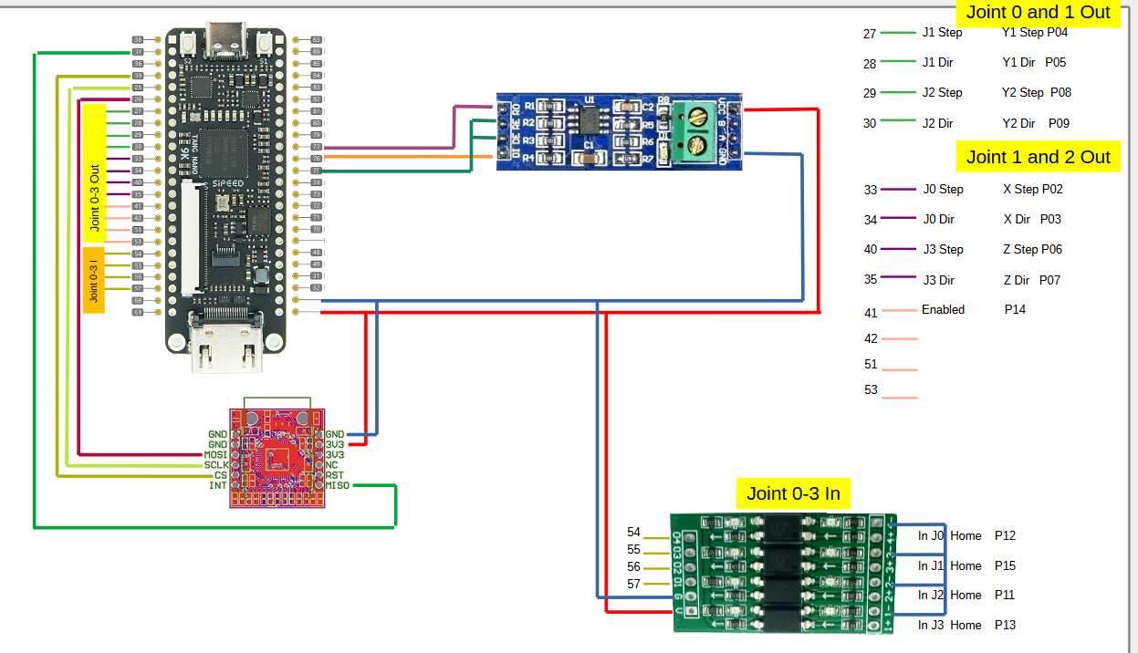

Now I am focusing on getting Modbus and the spindle to work. This is the last thing I need to run the mill with the Tang. Can someone confirm that this wiring is correct for the Max485?
Handwheel xhc-whb04b-6 is working as well.

StackExchange and EEVBlog are both fantastic venues for brainstorming and validating electrical/circuit ideas and designs, you'd find accurate answers to your questions in a finger snap and be done already. I highly doubt a Lcnc forum will be of any help. Great place for software, configs, dev, and industrial motion control hardware though, mostly.

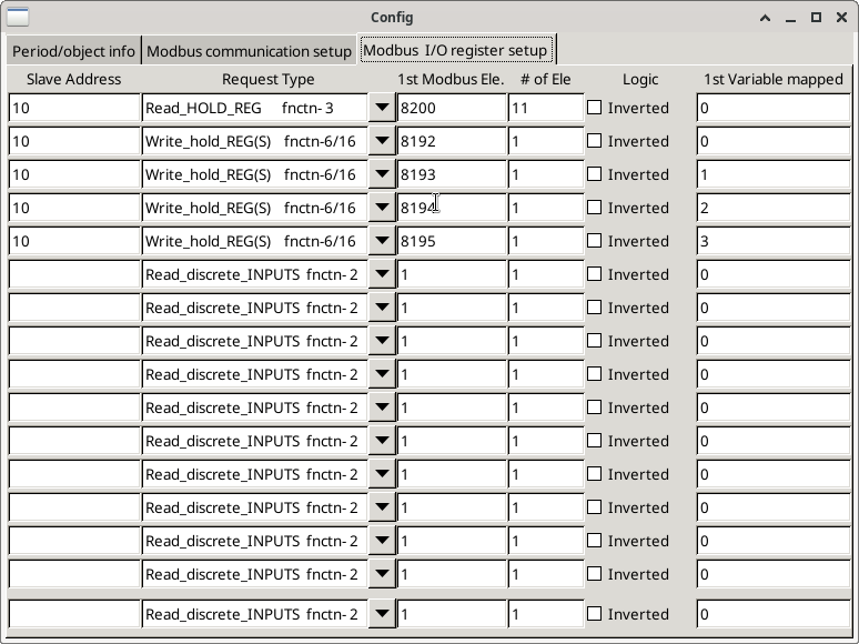

I need someone pointing me in the right direction to get my spindle running.
I can either try to get classic ladder to work. For whatever reason, it will not work with Rio.
This is the code rio creates in the rio.hal file.
If I start LinuxCNC, it is not in Modbus Master mode. So I changed the configuration. This is what works on the same machine.
When I start LinuxCNC I get the following error:
I tried to remove the numS32out=100, but no success. I can load the program manually with the ladder editor, but it is still not in modmaster mode and won't work.
I could also continue to work on the Modbus integration. I know which registers to read and write from my VFD, but need some starting help to translate this:
Into this:
loadrt classicladder_rt
addf classicladder.0.refresh servo-threadIf I start LinuxCNC, it is not in Modbus Master mode. So I changed the configuration. This is what works on the same machine.
loadrt classicladder_rt numS32out=100
loadusr classicladder --modmaster vfd.clpWhen I start LinuxCNC I get the following error:
Shared memory conflict or RT component not loaded!
ERROR CLASSICLADDER- Ladder memory allocation errorI tried to remove the numS32out=100, but no success. I can load the program manually with the ladder editor, but it is still not in modmaster mode and won't work.

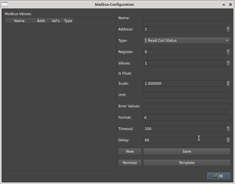

Into this:
