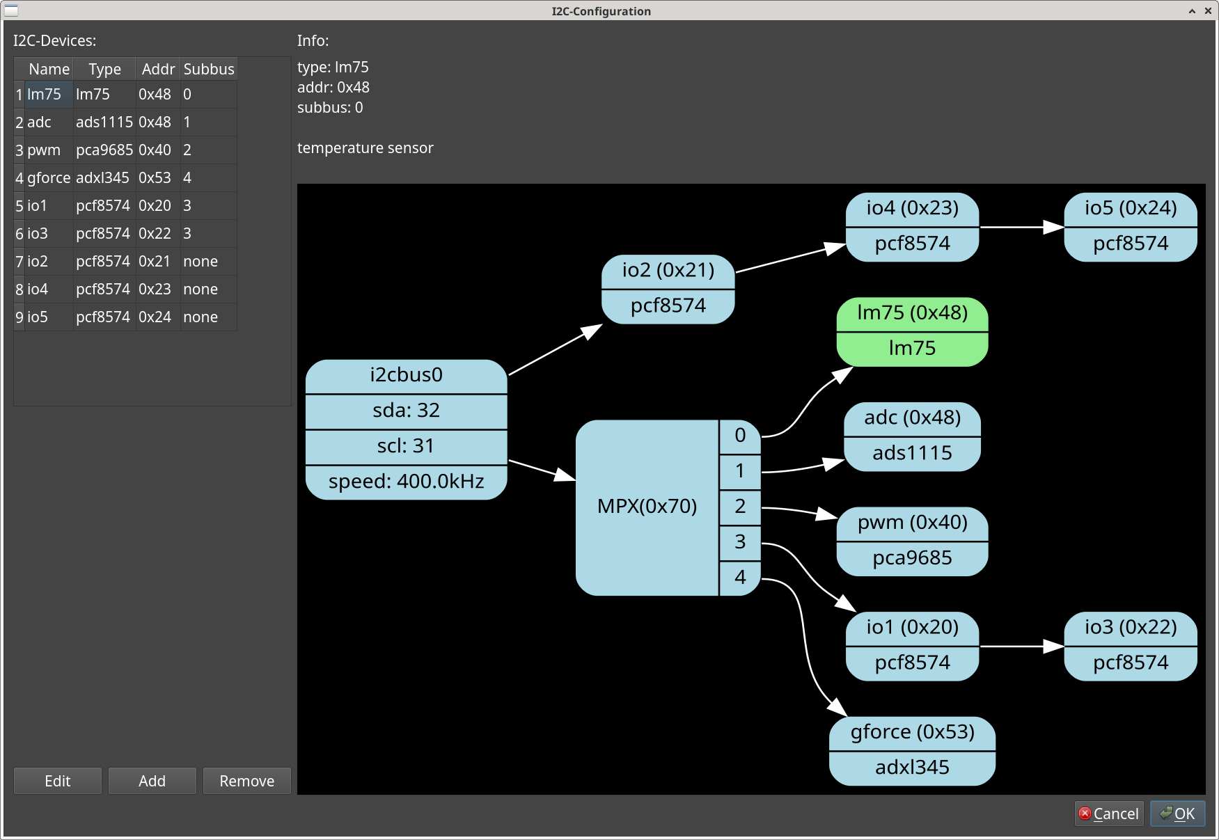

I'm currently rewriting the i2c stuff from scratch,
until now, each device needed its own bus with its own pins.
now i can configure several per bus and also separate them again via multiplexer chip
was a lot of work, but this is only the config of one i2c-master, you can also create several, on different pins with different speeds.
I'm still testing and not all the types I've created are working properly yet, but I'm hopeful

That is really cool, once I have my existing machine fully tested I intend to start playing around with all the extra stuff you've implemented. When you say several devices per bus, is that now as per the standard i2c protocol, so 128 devices ? I understand that lots of i2c devices only have a couple of address options so that doesn't help.

but there is also easy support for i2c multiplexer (PCA9548A/TCA9548A) now.
Replied by meister on topic LinuxCNC-RIO - RealtimeIO for LinuxCNC based on FPGA (ICE40 / ECP5)
if you have multiple devices that have the same address, you can still use multiple busses on different pins.That is really cool, once I have my existing machine fully tested I intend to start playing around with all the extra stuff you've implemented. When you say several devices per bus, is that now as per the standard i2c protocol, so 128 devices ? I understand that lots of i2c devices only have a couple of address options so that doesn't help.

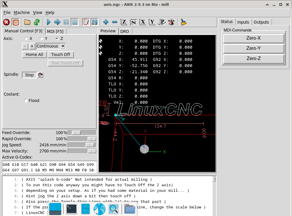

01 Jan 2025 06:41 #317763
by epineh
Replied by epineh on topic LinuxCNC-RIO - RealtimeIO for LinuxCNC based on FPGA (ICE40 / ECP5)
Very cool, will check that out.
For now I have a very weird issue, I'm not convinced its a riocore issue and not a general linuxcnc issue but here we go..
I cannot set G54 offsets, I've included a screenshot of the problem, as you can see the cutter is within the machine soft limits, and there are values in the G54 in the DRO but the toolpath preview is outside the machine limits. I've copied all machine specific parameters from the MESA config it was running previously, machine homes, enables etc and it is all working as it should. No matter what I do the toolpath remains outside of the bounding box.
Its like the machine is in absolute mode and ignoring the G54, so the origin of the gcode is at machine home and G54 has no effect.
I ran the default Sim (mm) config shipped with the live install and the issue doesn't happen, the toolpath jumps to the relative position to the cutter as normal.
Only thing I've done after the GUI riocore configuration is to add a linuxcnc.var file to the Output/TangNano9K/LinuxCNC folder as it wasn't generated. I copied one from the Sim folder after it generated one.
Other than that its a clean install that I ran docker on to program the FPGA and run Linuxcnc.
