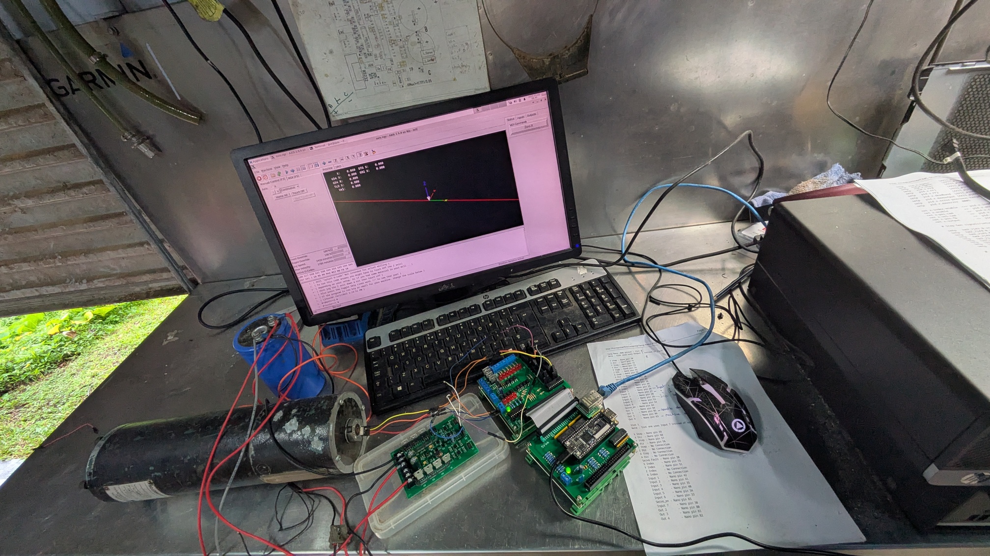

I have done a very quick test and at the moment I am over the moon, all the outputs work as they should.
I am using your template for N4D3E16, with exactly your settings.
When I use LinuxCNC it works perfectly, but if I use the test-gui in riocore the outputs work, but i get the following errors in the terminal window.

Please ignore the last post.......The test-gui isn't so happy with the idea of modbus, but I have all 16 ins and 16 outs using the N4D3E16 working under Linuxcnc!!!!
Very Happy.
Thank you again Olli for such a great system.

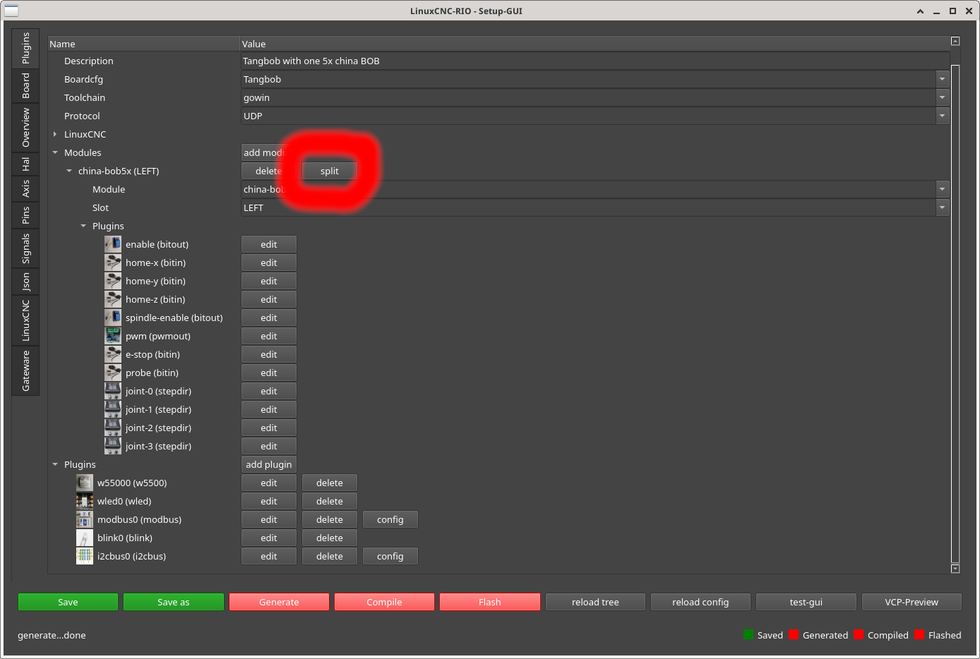

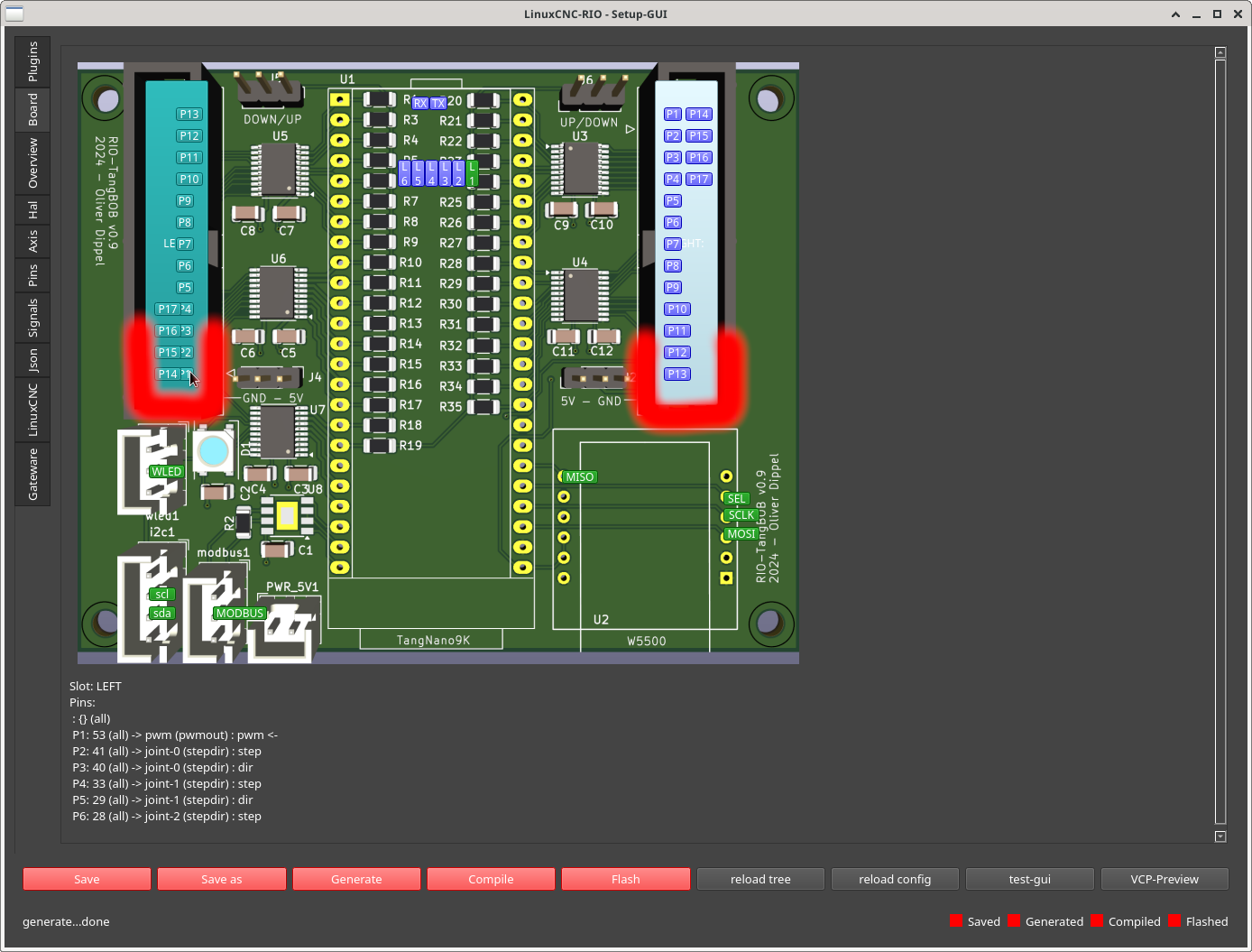

the BOB is added as module in the sample config, you can convert/split this into single plugins:
The pins on the left and right connector are named P1->P17,
like on the DB26 connectors:
hope that helps.
