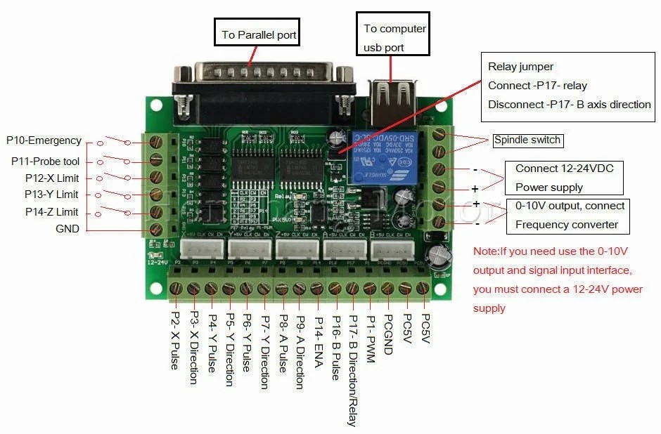

So I did installOpenOCDSo now I cannot ping 192.168.10.94 even though I have made the intel nuc 192.168.10.1 and put 8.8.8.8 as dns. Trired 192.168.10.93 and gateway 192.168.10.1. maybe the w55000 is not powered and wonder if there is a jumper on the tangoboard. I will check the solders in the morning.
The 5axis bob as setup in your default config is great for me however I am probably too silly to understand how the pins map out on the china bob, other than the steppers. But I will leave that for more research.
Than you
I would imagine that the attached image is somewhat of areference

never trired OpenOCD, but you can send me the error mesage of the openfpgaloader.
with openocd you should make sure that it is written to the flash and not just to the ram, otherwise everything will be gone again after a restart
You can see whether it has worked by the flashing LED
btw, the default ip is '192.168.10.194'
the w5500 module has a little power led on the bottom, there is no jumper to power on/off this module.
not realy shure what you mean with the mapping,
the bob pins are mapped 1:1, if you need P17 (relais) on the BOB, you can use 'LEFT:P17' in your config.
if your BOB is connected to the other connector on the right, then you need to use 'RIGHT:P17'

Hello Oliver

On W5500 there is a tiny led under the lan port and is a faint red when the bob is powered. I cannot conect with Lan, can some one give me a tcp 4 setting for the host pc so I can ping the bob on 192.168.10.194.
Thanks for the guidance regarding the pin assignment. Great work

Okay so when I was looking up the schematics and pcb files I realised that I had inserted the Tang nano in the wrong direction , when I fixed that tand powerd the bob a bright red led light up on the w5500 module and the Lan link was connected to the host, when I pressed test gui button the select target popped up for udp 192.168.10.194. pressed ok and tested wled selecting the 3 boxes lit up the wled on the bob and tested all colors worked like a charm. There was this warning in the terminal (dont know if it is important) connection via: UDP
IP: 192.168.10.194
