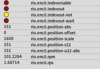

Dear meister:
When I tested the encoder plugin I found that the indicated position seemed to be the number of revolutions. When the encoder rotated one revolution, the position increased by one number. I was sure that my scale configuration was correct because the rpm displayed the correct value. I let the motor run at 100rpm and the encoder plugin displayed about 100rpm. My encoder came from the simulated encoder of the servo motor driver.

@epineh please add you config
@Tim Bee
you need to use rio.enc0.position, this is the floating point value.
there is no raw value without scale calculation, but if you really need one, i will check to add it
@Tim Bee

13 Jul 2025 10:11 #331761
by Tim Bee
Replied by Tim Bee on topic LinuxCNC-RIO - RealtimeIO for LinuxCNC based on FPGA (ICE40 / ECP5)
@meister
I'm sorry, i miss the rio.enc0.position pin ^_^

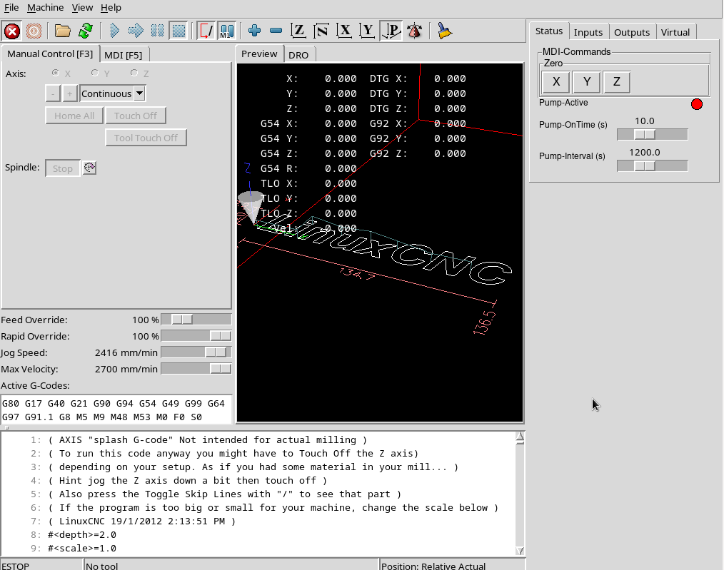

I don't want to push my luck but would it be possible to have a dual timer plugin? It would be for lube pumps mainly, so generally they turn on when the machine starts, run for 10 seconds then off, and turn on for 10 seconds every 20 minutes after that.
I guess the blink could be modified for longer frequency but both the on and off time needs to be adjustable.
Cheers.
Russell.
Cheers.
Russell.

i will add a new plugin named 'interval' or so.
then you can configure the on-time and the interval-time via gui/hal

in dev branch and untested (only via testbench):
github.com/multigcs/riocore/blob/dev/rio...s/interval/README.md
little config example 10 seconds on / interval 20 minutes default
looks like this:
and the onTime can be adjust between 5 and 20 seconds / interval between 600 and 1800 seconds (10 - 30 minutes)
"type": "interval",
"pins": {
"out": {
"pin": "PIN:69"
"uid": "interval0",
"signals": {
"enable": {
"display": {
"title": "Pump-Active",
"section": "status"
"net": "halui.machine.is-on"
"ontime": {
"display": {
"title": "Pump-OnTime (s)",
"initval": 10.0,
"min": 5.0,
"max": 20.0,
"section": "status"
"interval": {
"display": {
"title": "Pump-Interval (s)",
"initval": 1200.0,
"min": 600.0,
"max": 1800.0,
"section": "status"
}looks like this:
